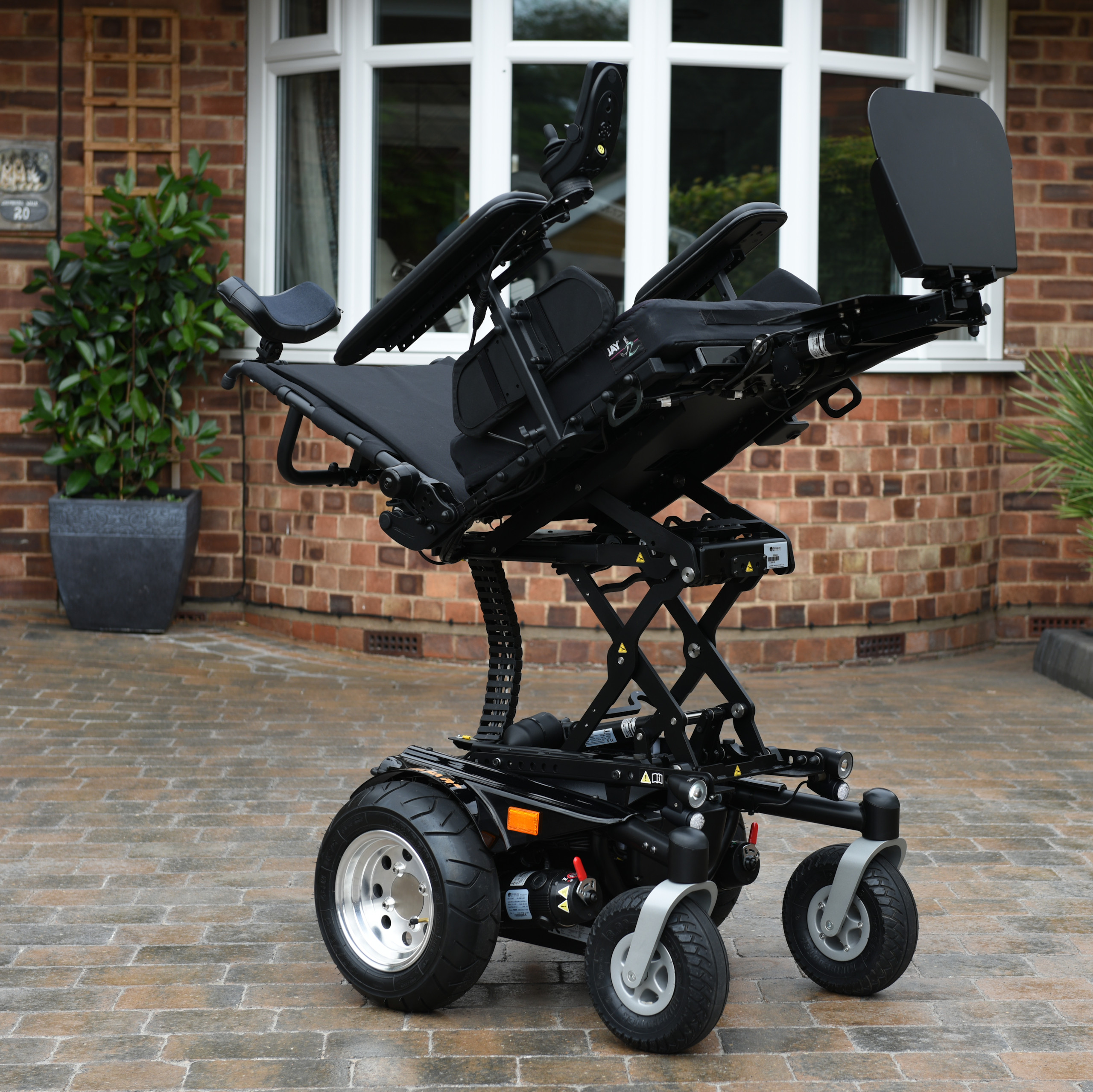

So since I seem to need tilt at very least to prevent sores, and preferably recline too. Well you may as well go the whole hog, and have power footrests and a lift too. In for a pound as they say.
Thats was the reason for buying my salsa powerchair complete, and adapting it a little so it works properly!!!
See: viewtopic.php?f=2&t=7455&start=600#p122818
Be sure to read the first post before looking at the pretty pictures as the devil is always in the details.
It NOW works well, and is nothing like my usual short, sharp, light chairs.

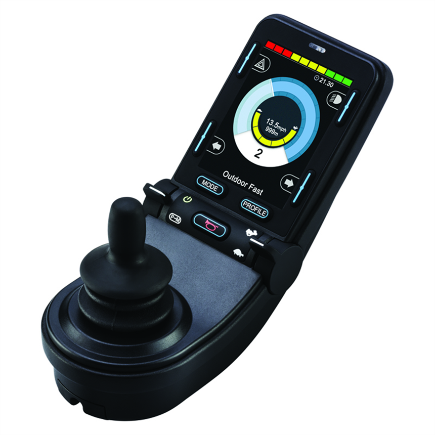

Back to R-net. They introduced a new joystick with bright clear large graphics. Its got a metal case/chassis. Its big, which annoys but if you are going to have a lot of seating options, then its a royal pain figuring out whats going on without a screen you can see clearly outdoors.

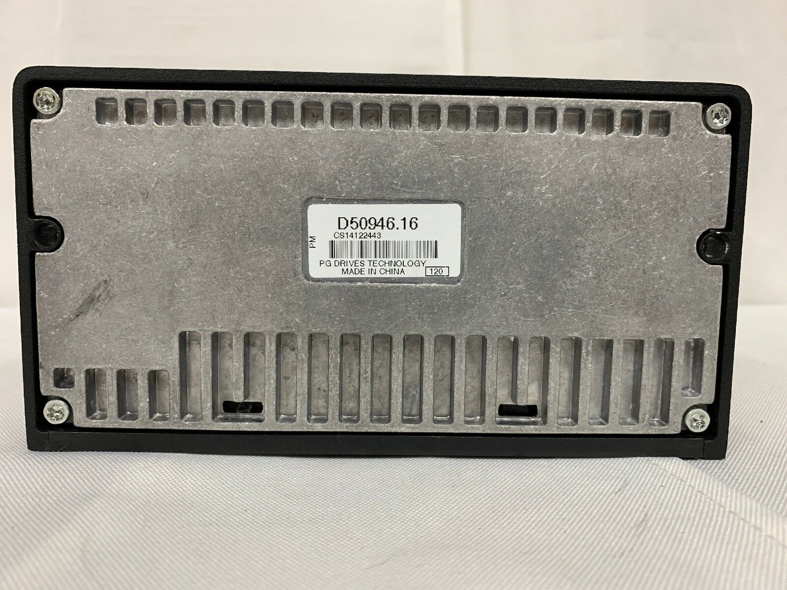

So I bought a spare one one these new for £125 : (EDIT, now have 3!)

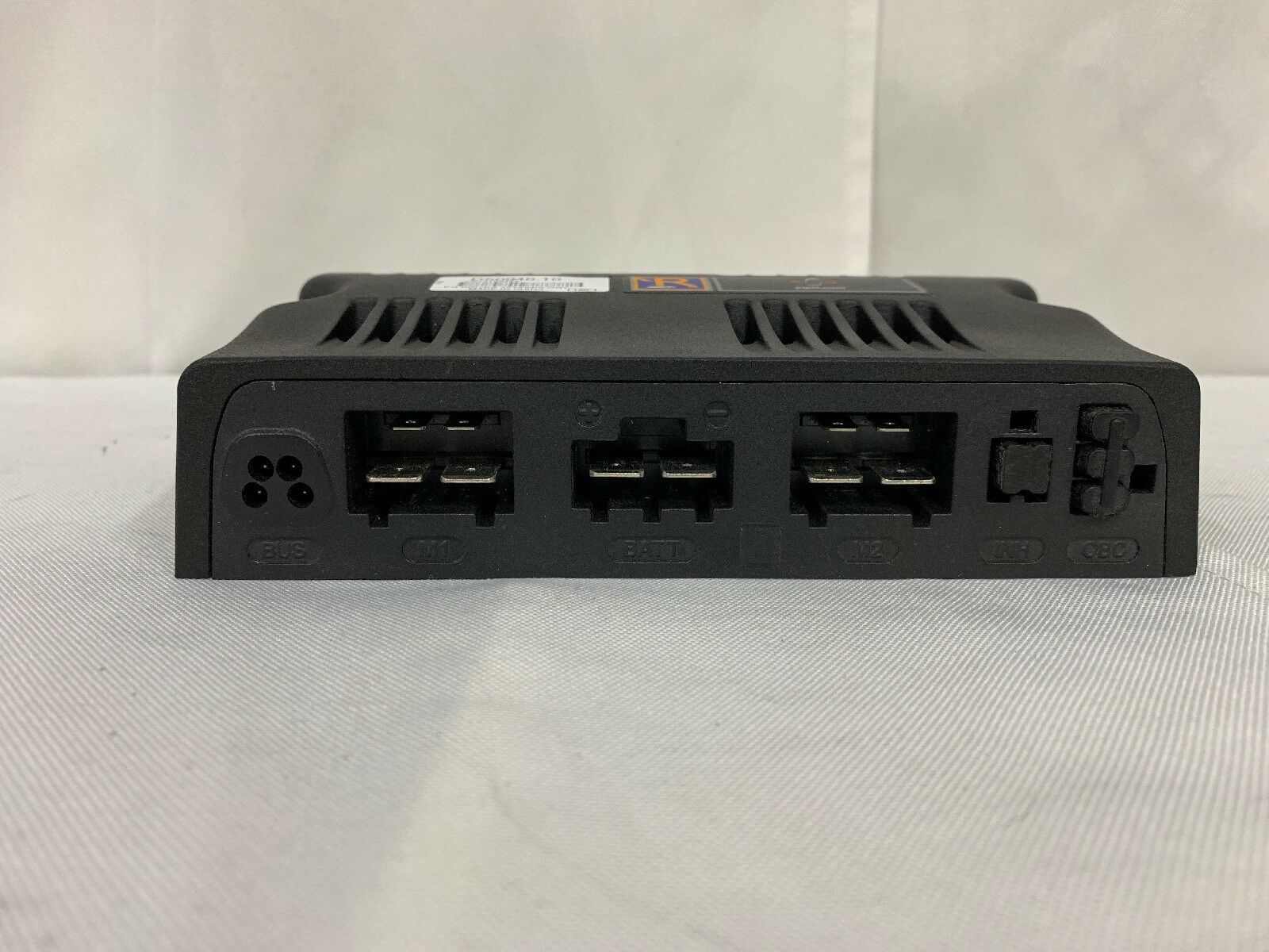

I then bought a R-Net 120 Power Module (NOT the 60, 80, 90A ones) on eBay US site for £53 + 45 delivery... :clap (EDIT Now have 3 of these)

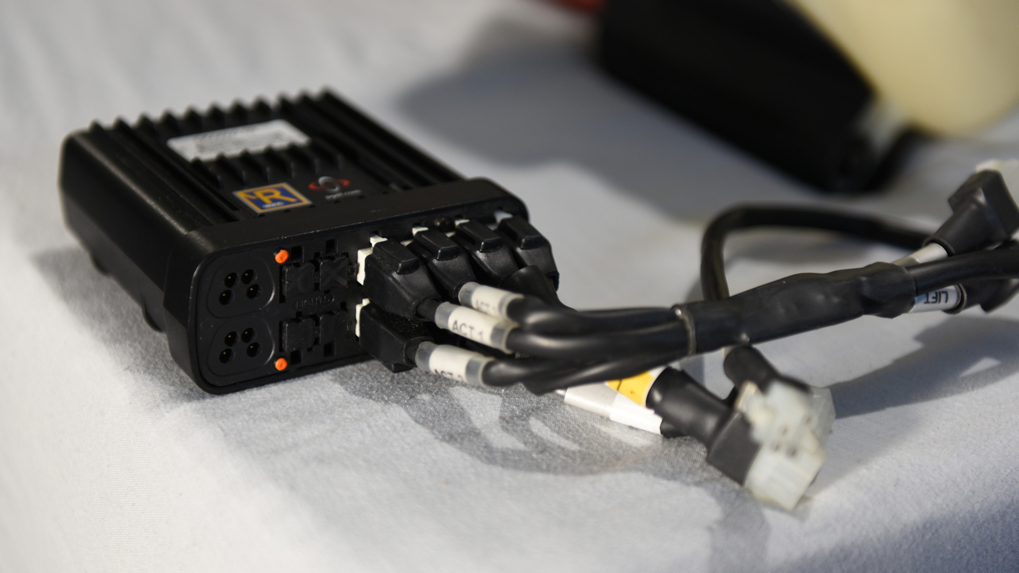

I then bought a full house Seating and lighting module in the UK for an even sillier price. I wont say how much because it will make a dealer cry. (EDIT, also now have two)
These are available in 2, 4, 6, and apparently 8 channels, + lights. (never saw an 8 channel version). This does 6. Its labled ISM-6. So lighting, and every seating option reqiuired. MOST are ism-6. Some are less, if theres only say tilt and recline.
Complete with a loom and connections for Lift, Tilt, Recline, L-Footrest, R-footrest so I can fit a salsa style seating lift / recline module to my BM1 chair. At least thats what I think I will do with it.
Full R-Net top of range kit, best of everything for £268 delivered. Amazing really. All 3 expensive bits that someone like permobil would sell for literally many thousands. In fact some of it IS permobil... Like this seating lighting module inc wires. At least I think it is. May be Sunrise.
Now need motor, battery connectors, and 2 bus cables. Which should be soon. Who says hi end gear to build a mega chair has to be expensive? And of course I already have an OEM programmer. (EDIT now have a bunch as they appeared on eBay etc)
So this is EVERYTHING needed for a chair with every possible seating option, best highest power 120A controller, and highest quality BRIGHT CLEAR METAL joystick. Everything powered covered! This is the most expensive system you can get on a powerchair.
EVERTHING! And cheap.

Burgerman wrote:It works well, and is nothing like my usual short, sharp, light chairs. Different animal altogether. Worse in so many ways, but my pressure sores prefer it.
With the chair's weight + your weight, how does the salsa handle outdoors BM?
Posts: 2600
Location: Camberley England UK
Re: R-net
Postby Burgerman » 08 May 2019, 18:59
Well an old BM2 will go up the pub ramp easily with control with a 100A controller. And the salsa will not go up at all with a 120A controller and 6mph 4 pole motors. So its about two thirds as good on a steep ramp. And thats due to a 90GK weight difference... And the chair is wider and longer than my BM2/BM2.5/BM3 chairs, so indoors its a little less useful. But outdoors its much the same on pavements. Smoother actually with the 120/70-8 tyres and suspension. A little tiny bit faster than stock but not much, (tyres and increase motor volts) same sort of steering (a little less instant and thats because of very heavy chair). And the weight eats more battery.
Not tried it off road as I just started getting up for a few hours about 4 days a week. And no dog! And I dont want to get it dirty yet! (OCD) but with all that seating weight, and me higher, and more nose heavy it wont be great. But dog is gone now. So no real need. Why more nose heavy?
Because it sits you higher than the BM chairs. Not much, but it means that with the heavy seating and me 1 inch higher too, it would become a liability on slopes, if the seating was moved back further. Also, with the seating in the position shown below, on LEVEL ground its already close to tipping back! Hence lifting legs too. First. Its a long way to fall on your head. Also even when lowered, that seating rocks and moves around a bit, so the chair feels kind of loose! But every chair I ever tried with seat lift etc did. You just need to ignore it and respect the extra mass.
The thing is I resisted all this seating malarky because of the ebove issues, as it just didnt suit my wheelies, leaping off curbs, off road with dog etc. But I now NEED it for pressure ulcer reasons. So I use the salsa if theres going to be a long time where I cant get onto my bed and give my backside a rest. I can basically tilt/recline/and lift legs for balance and de-swelling too.
I didnt NEED the lift for that. But there is always 1001 things that I cant do like reach stuff on a shelf. Or use a microfible cloth to clean the top half of my van. So I do those things when in the salsa. When driving, or going out for 5 or 6 hours only I still prefer my lighter more manoeverable chairs. Also the lift is fun in a pub as I can do this at the bar with a beer! Comedy value. Once then bored with it.
In this position, (but lowered) much of the weight is removed from your 'sitting bones' that I cant pronounce. And on your back instead. Also very relaxing. Great with a laptop or a beer. Helps prevent sores that have plagued me for 3 years.
