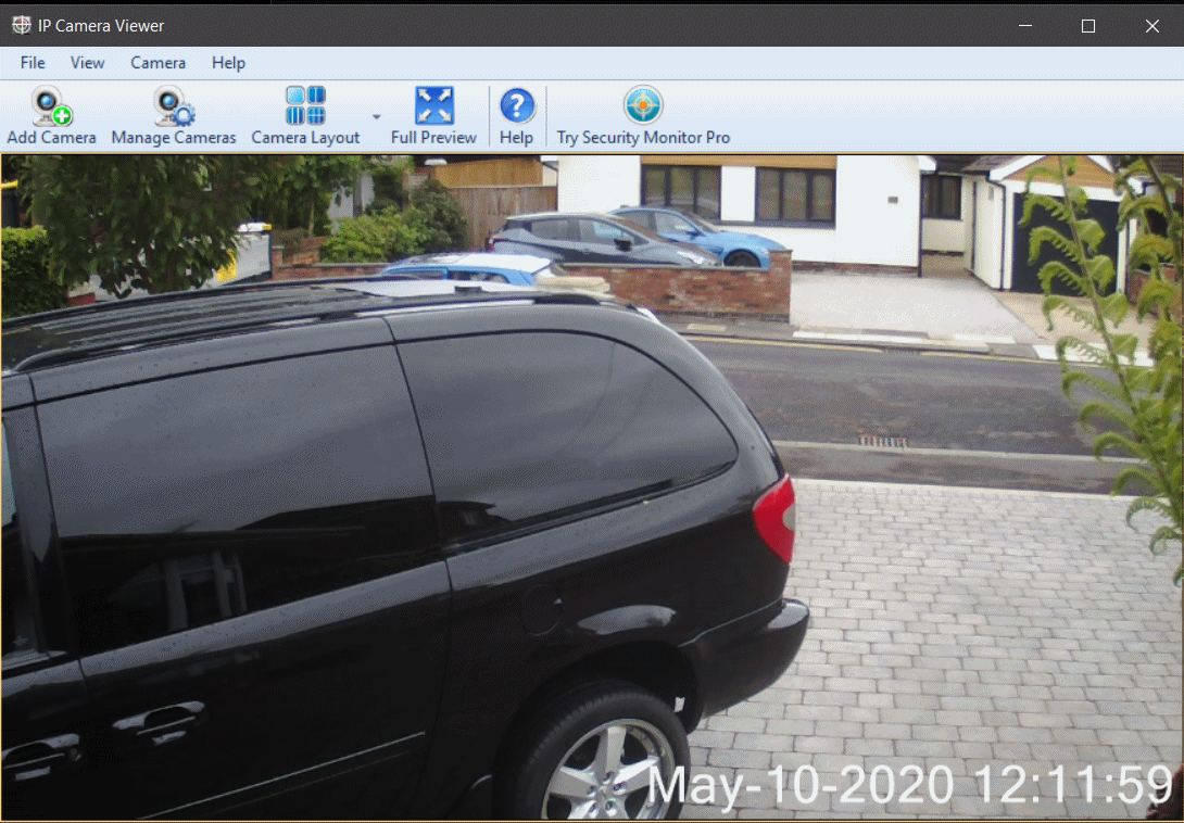

Postby Burgerman » 10 May 2020, 12:18
I do.
And a solar panel on the roof of the van!
50 or 60 watts. Depending who you believe. Because its not AIMED at the sun, the best it does is approx 30w. At noon, in summer. At noon in december thats nearer 3 to 4 watts. And only if the sun shines, and only for an hour or two. So solar sucks in winter. Suns too low in sky. Keep your eye on it in the worst darkest 3 months. Nov, Dec, Jan with a volt meter. I add a 13.5v power supply for these 3 months. Depending on drain, and depending on your bigger panels output you may get away with it. Or not!
