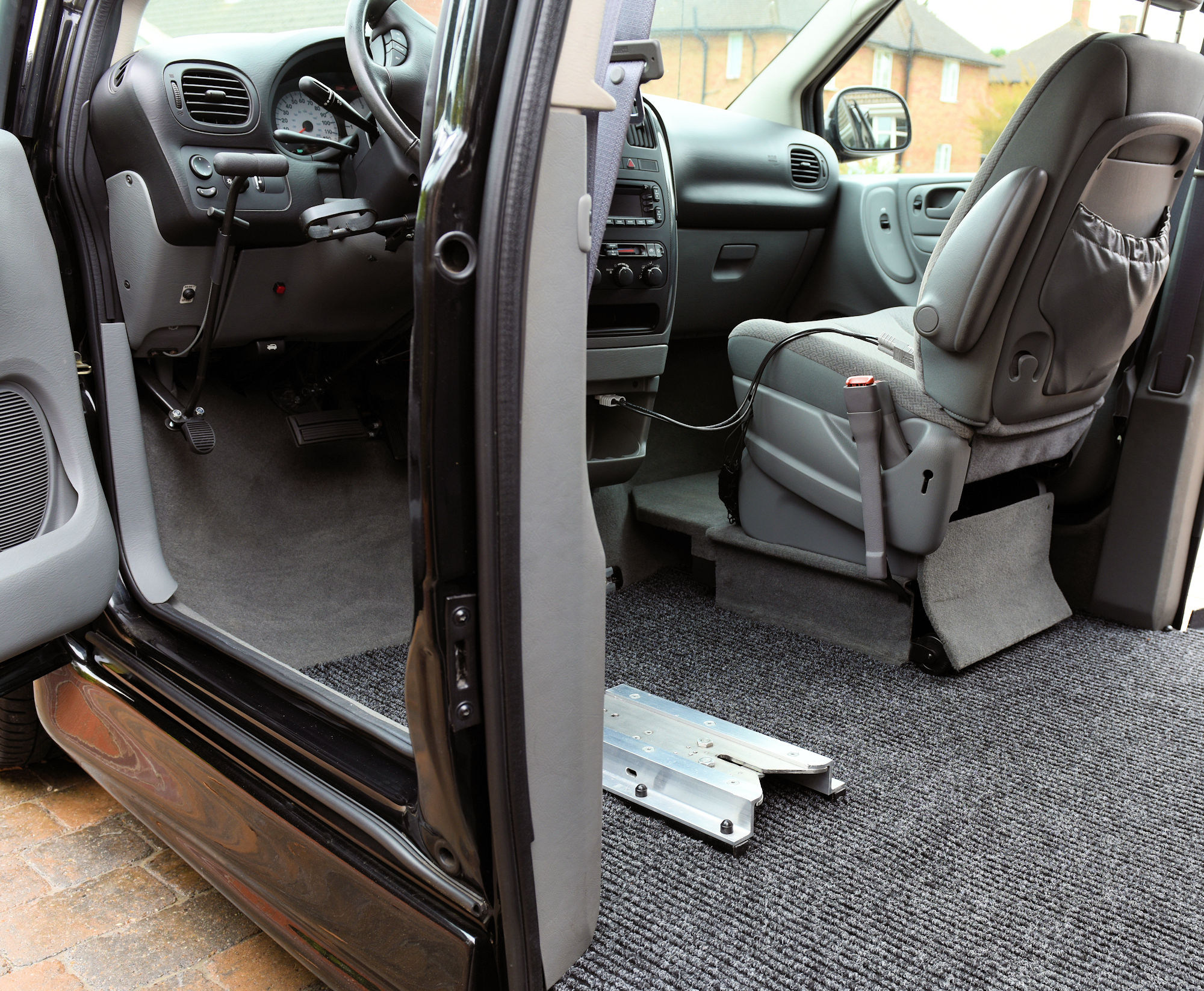

2. Look at image. The hand control is on the right and hidden. The OPPOSITE end of it extends to the left, as you can see. Its that flat loop. Its just above your knee.
3. Pull gently and it holds the brake on. Just the same as PUSHING the right side does. So pull gently with left hand.
4. Put it into drive with your right hand. Its very easy. Since its column change and right next to the hand controls.

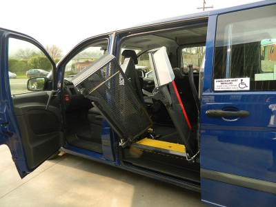

They do - you can have a ricon clearway lift that goes inside the van.
Posts: 70440
Re: LHD and placement of Hand Controls
Postby stevelawiw » 06 Nov 2020, 15:39
I looked at that lift, it's awful! It's like a massive ugly mechano set bolted onto the side of the van,
