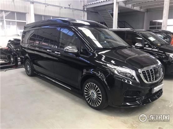

See attached, a custom job, raised roof, on a V class… I was thinking something like this but on a voyager.

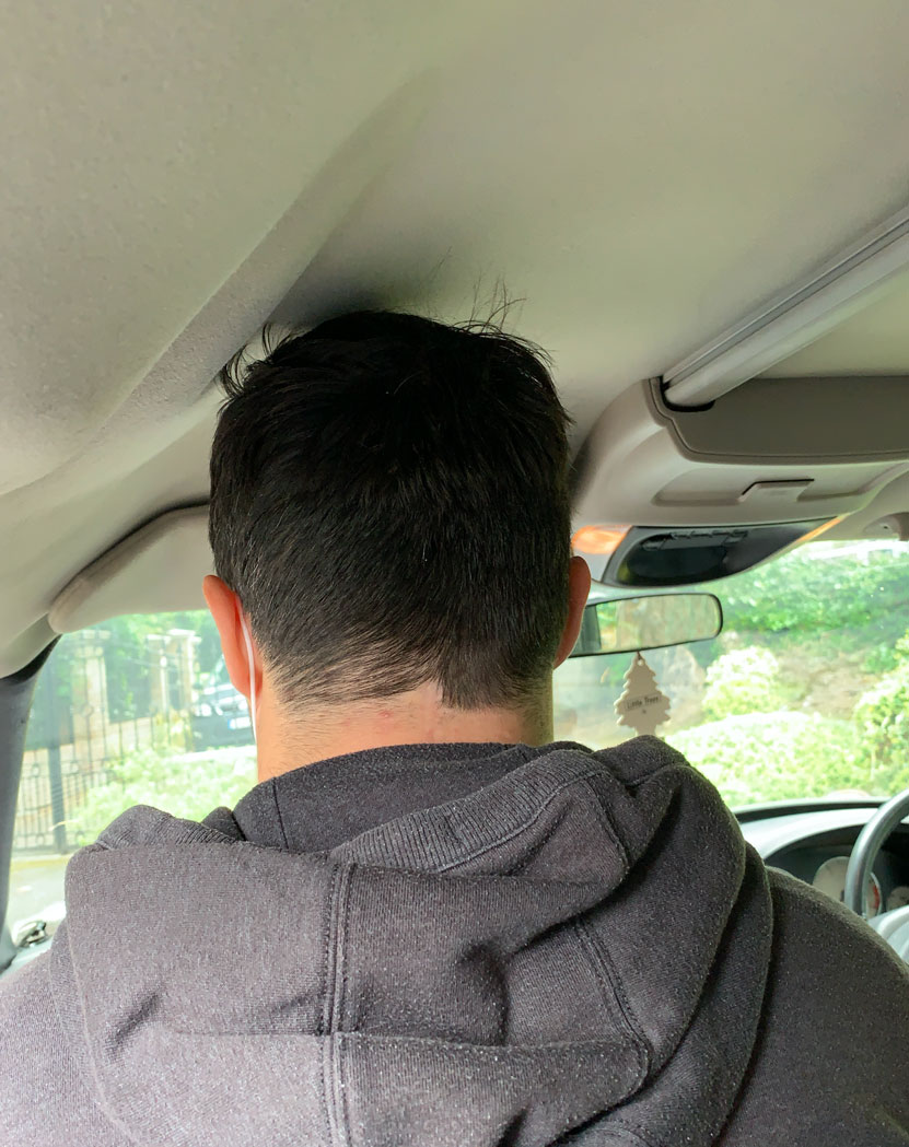

I’m about 6ft tall. I can’t find a power chair that will sit me lower that 55 inches. The latest chair I tried was the Q300m mini. Attached is a pic of me in the Q300m in the passenger side of the car.

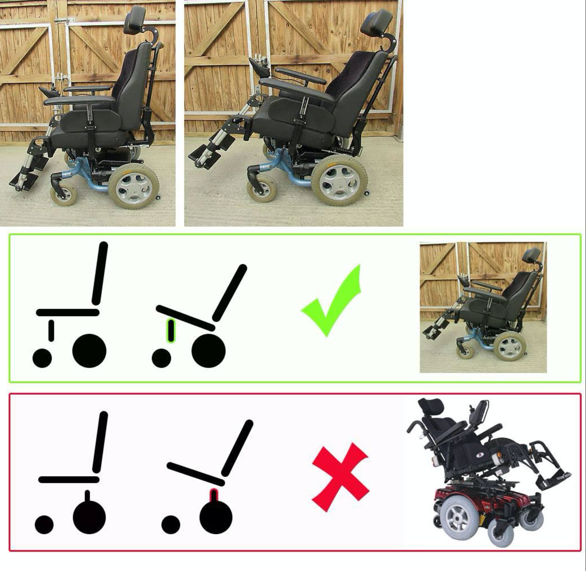

Tilting any chair I know of, except the iBis, doesn't lower head height.... they maintain your head height… and head height won’t really lower until you are so tilted that you are too far back to do much. See ibis chair example attached.

Postby jazzh1 » 04 Aug 2021, 16:53
e.g. Tilt of iBis vs other tilt type

Postby jazzh1 » 04 Aug 2021, 16:54
Me in the passenger side of my car using the Q300m mini (demo chair)
