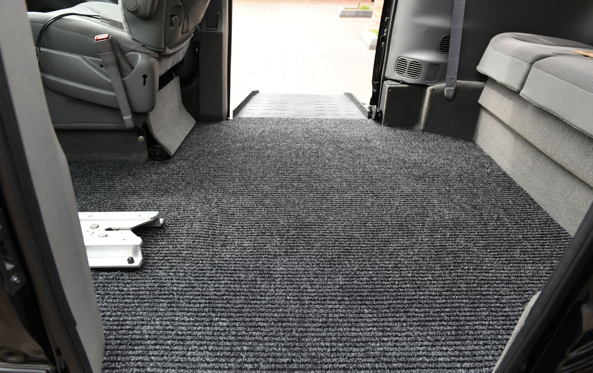

Note. The floorpan is reversed, not just the dashboard, The door on the right wher the ramp is has the steering on the laft. And the opposite is also true. So attempting to reverse the left drive setup is not really practical or affordable. It just makes no sense.
Left drive, right side ramp.
