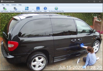

Postby Burgerman » 12 Oct 2020, 18:09
289 pic?
And 2006 van. You need a Michelle. As new 14 years old. Inside and out.
Reason for pic, note 50W solar panel on roof at rear. In the rear side cover there is a good Solar charge controller. (Voltage adjustable). Set to 13.7V in winter, 13.3/4 in summer. With IOD fuse now a switch, it NOW keeps up in winter too! Battery always 100% charged. Even unused for months in january.
Posts: 70441

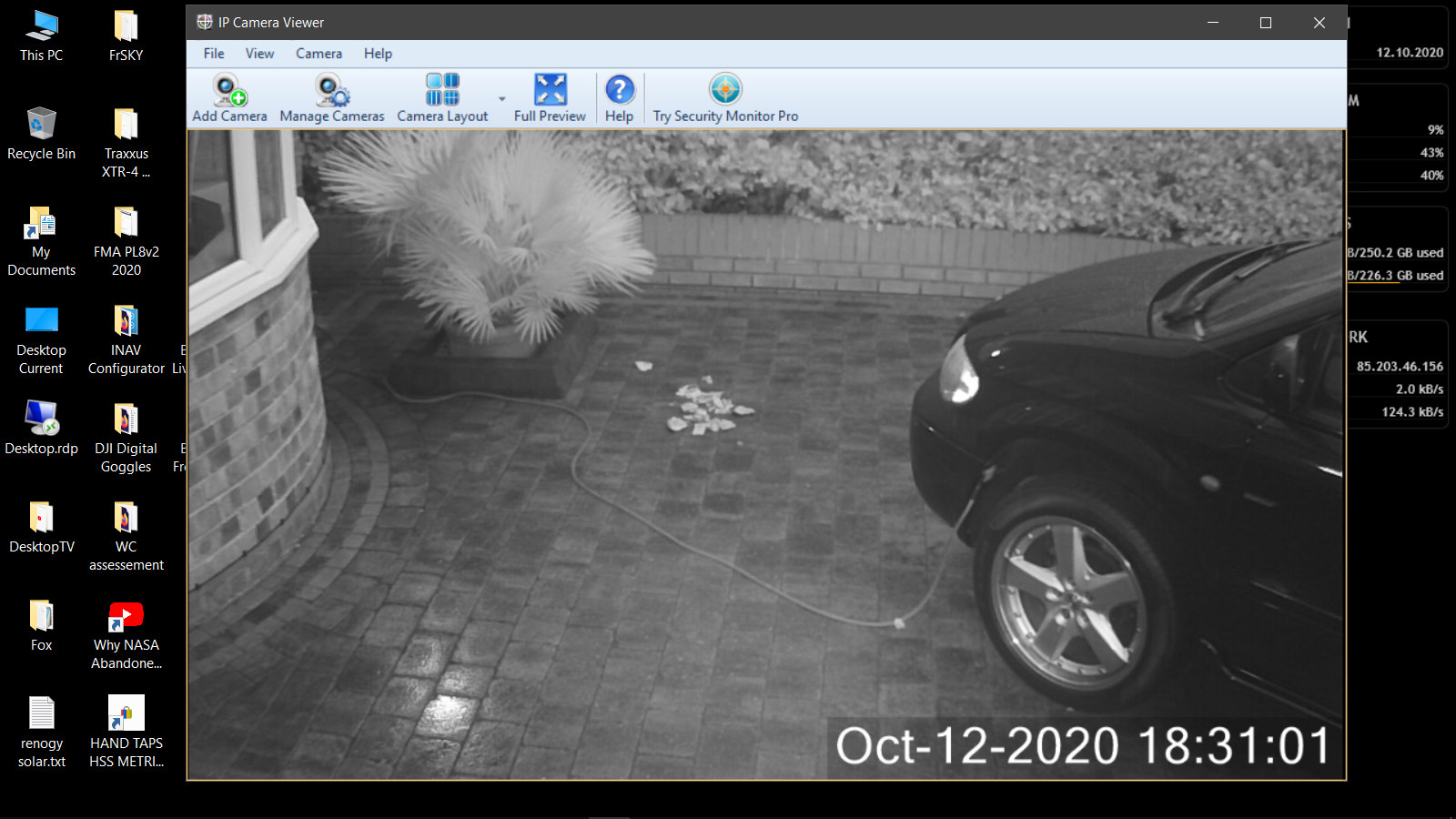

Postby Burgerman » 12 Oct 2020, 18:45
Theres a few things to see here.
1. Under my wheelarch there is a heavy cable that goes from battery to an anderson connector that is bolted to the plastic wheelarch liner. It allows me direct easy access to the battery at all times without lifting the bonnet/hood.
2. It means connecting a charger, an inverter, or a 12V ANYTHING like the PL8 at the flying feild to charge helis/quadcopters etc is simple. It also means that I can start the van even with a dead battery if that happens while I am out FROM a powerchair. It also allows rapid charge of a powerchair from a RUNNING van. It means that I can plug in a chair, and instantly operate the ramp even on a dead battery.
3. AS SHOWN HERE there is a long cable, good for 25A, with an anderson on the end plugged into my van. The other end goes through the wall and ends with another Anderson on my bench.
This allows me to connect to the PL8, or my bench supply, or a voltmeter to monitor volts over time. It allows a maintainance charger, the PL8, or a bench power supply to maintain or charge the van... Right now its connected only to a cheap LED volt meter from ebay. A 5 digit one. Showing 12.95V in the dark. In this way I can monitor it over winter from my bed easily! I can see the volts rise in the sun. And drop slightly overnight. And I can see if the battery is healthy. I can also plug it into an inverter and have 240V AC if theres a power cut... Yes thats even better as I can start the van, to keep the battery topped off while using the power to charge a chair, work lights, bed, computer etc. IF needed.
Note the meat thrown on the ground for the foxes! I watch them on this cam.

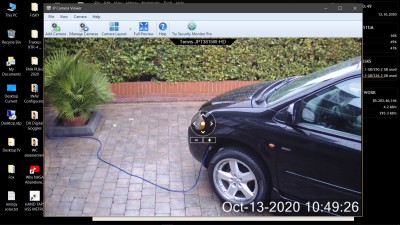

Postby Burgerman » 13 Oct 2020, 10:52
