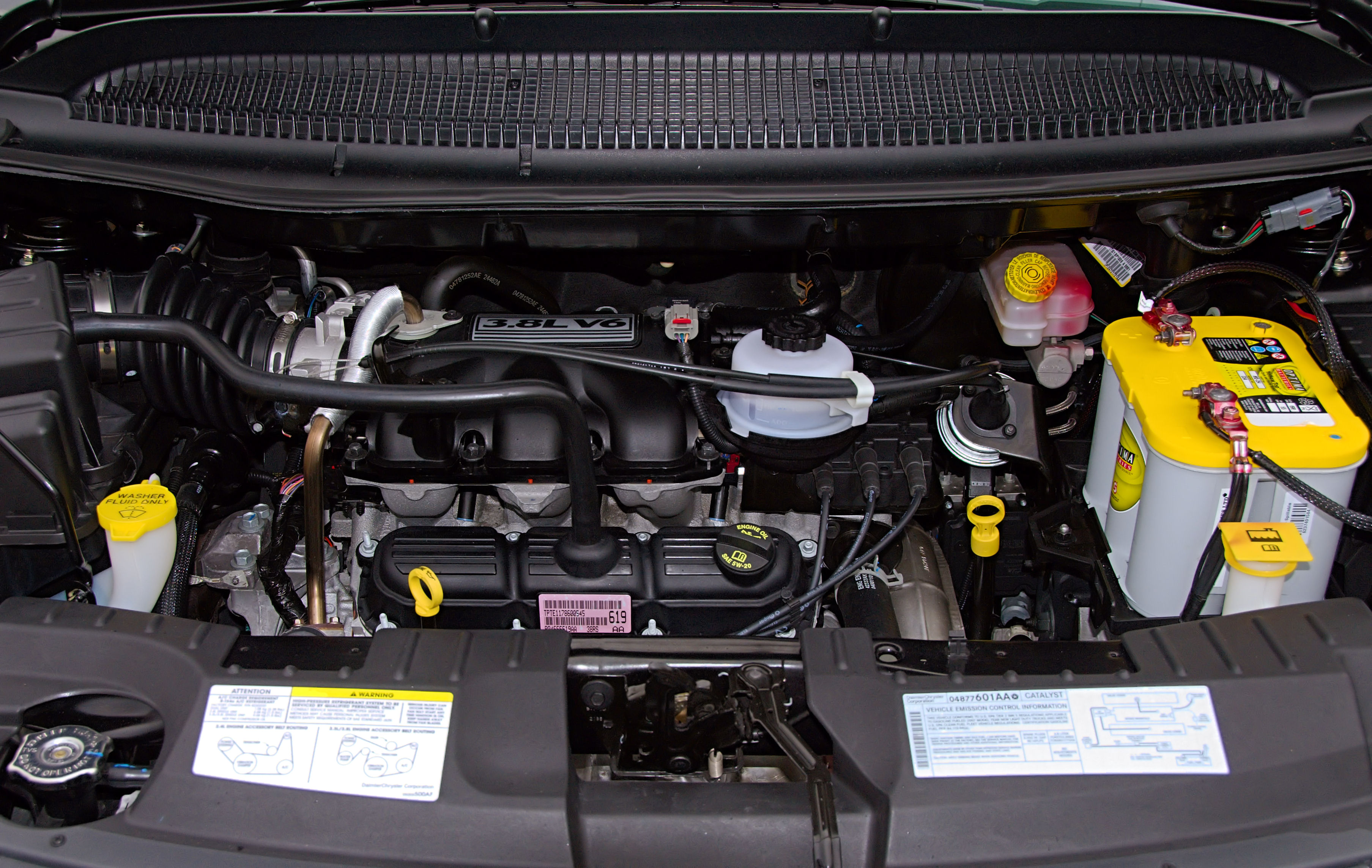

Theres another in a wire connected to the battery with a fuse in the engine bay On mine at least.
Theres a fuse in one of the two cables connected to the battery that have a nylon braid on them. Those are supplying power to the ramp system. You can see the cables here but not the fuse.
