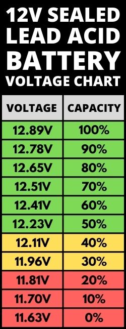

It can help some. But you also need some understanding of what its showing you.
When you say monitor the battery, I am not sure what you think its going to tell you exactly. Unless you understand the following it wont likely help a lot.
A FULL battery or a battery at 99% full, will read around 12.95 to 13.2V. If its not connected to anything.
A battery at 90% full that is not connected to anything will read around 12.8V.
A battery at say 12.4V is either around 50% discharged, if its just sat disconnected, or 80% charged if its been sat in a van that is gradually discharging it.
The AMOUNT that it reads is "artificially" low, depends on many things such as the length of time since charge, previous charge or discharge history (called peukert and takes around 16 hours to recover correct voltage). And so on. So a small drain of even 70mA will cause a battery voltage to read much lower than its actual open circuit voltage and give an incorrect state of charge measurement.
So a battery at say 12.5V can be either nearly full, or less than half charged. Depending on recent history, current drain current, temperature, and peukert level and any slow drain current that it has from the van.
What are you hoping to see?
I suspect that you will see around 12.4 to 12.6V after its been driven, maybe 2 hours later. At that point its still 98% or better charged... But will look as if its not.
In my own van I do what is the only sensible solution.
Since all lead batteries have being discharged, even a little for long periods, I hold it at 13.2V which is the level that holds it 100% full, without any real charge current which would otherwise damage it long term. This is done witha solar panel, and charge controller, and in winter via an extention cable and a wall wart set to 13.2V. In both cases a perfect long term float voltage.
That way I know the battery is always at the perfect 100% charge. And will live at least a decade.
I also have an anderson connector on the dashboard, and under a wheelarch.
So I can connect my chair to it to start it in the event I leave lights on or something, and so that as I drive the van charges the chair.
THIS is only valid if you disconnect he battery competely, wait 16 to 20 hours before measuring.
As if there is a small drain as in your van the voltage will otherwise read way less, than it otherwise would.

Worse, the engines starter draws anything from 100 to 500 Amps depending on temperature as you crank it.
This means that in winter a 65% fully charged battery likely cant start your engine. Because the impedance increases as state of drops and temperature.
In summer though a 40% charged battery will probably start it great.
But heres another thing. If you have a fully charged 13.00V battery, and crank the engine for 3 seconds that will make the voltage drop to around 10V instantly, and then it will rise again. Initially it will do so very fast. After 2 or 3 mins it might be 12.5V. After 15 mins it might be 12.75V. Its really still 99% charged. And it will eventually get back to almost 13V again over around 16 hours. During this time the voltage continues to increase, but state of charge remained the same or dropped a little. This is why when you try and start a car it stops cranking. But leave it an hour or so and it fires up.
Unless theres a small residual drain current caused by a fault. In which case it may never recover or get past say, 12.5V... Yet still be almost a fully charged battery.
So state of charge DOESENT = Voltage.
So any gadget that tries to determine the battery state of charge based on its voltage cant really tell you very much unless you disconnect it completely and wait 16 to 20 hours... Lead batteries are terrible things. All this inaccuracy is caused by a thing called the surface charge effect or Peukert after the guy that discovered it.
