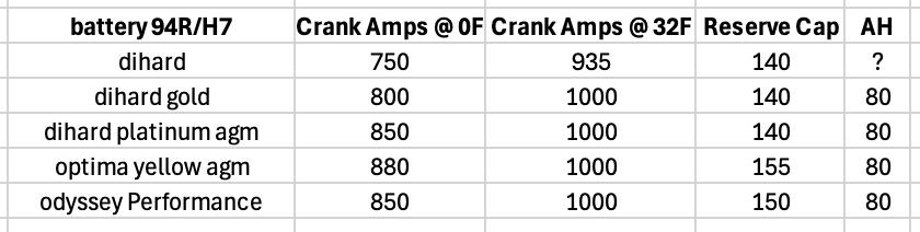

My van's battery size is 94R or H7. Odyssey makes the Performance series in this size, but not the Extreme series, and I don't feel like measuring and researching what other sizes would fit.
It looks like the batteries this size at my local auto parts stores are all 80AH. The Optima Yellow has the better CCA and RC specs.
