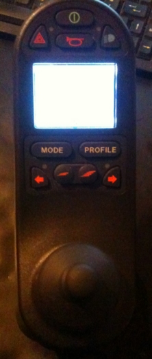

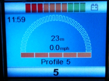

MY OT seems to think that it is and was not happy when I told her I had taken the chair out to a hospital appointment. I don't give a shit either way but my chair is stuck at 2MPH and I think they will reprogram it for its maximum speed once I take the test.
Unless I Program it myself? Is there a step by step guide with software and programmer needed?

Postby Burgerman » 30 Mar 2012, 13:29
2mph?
You have to be kidding?
Theres no legal requirement to do any test in a powerchair. Tell them to get a life and sort out your chair!
Posts: 70435

Programming R-Net
Postby Martin O Refurbisher » 31 Mar 2012, 01:10
Programming R-Net
Ask your supplier to enable on-board programming.

Postby Burgerman » 31 Mar 2012, 01:50
On board programming does NOT allow any meaningful adjustments to be made. Its basically end user or dealer only. It doesent allow access to the stuff that you actually need to make it steer and drive properly.

Postby Dan » 31 Mar 2012, 12:54
Well i'm aick of the 2MPH limit. Can I reprogram it myself and if so what do I need? God knows how long I will have to wait for a chance to take the test and then for them to change the settings.

Postby Burgerman » 31 Mar 2012, 20:06
Really you do need access to an OEM programmer. Because theres a great bunch of settings that need changing. Max speed is just one. If you wanbt it to steer properly, accelerate properly, etc theres a lot more.

Postby Dan » 07 Apr 2012, 15:14
Is it possible to get an OEM programmer for my controller? And not for silly money. And software. Or build one myself if the parts can be bought?

Postby Burgerman » 07 Apr 2012, 15:37
If its R-net, then no. The OEM controller that you need requires a PC and a dongle. The only place you can get it as far as I know is PG drives - IF they will sell you it. More likely they will try to persuade you you dont need OEM and sell you the useless dealer version. Which canm be done using your joystick controiller and screen. But its a waste of effort. Its like the difference between being a customer in a resturant or the chef! As a customer you get to choose from a small list. As the chef you get to decide everything.
