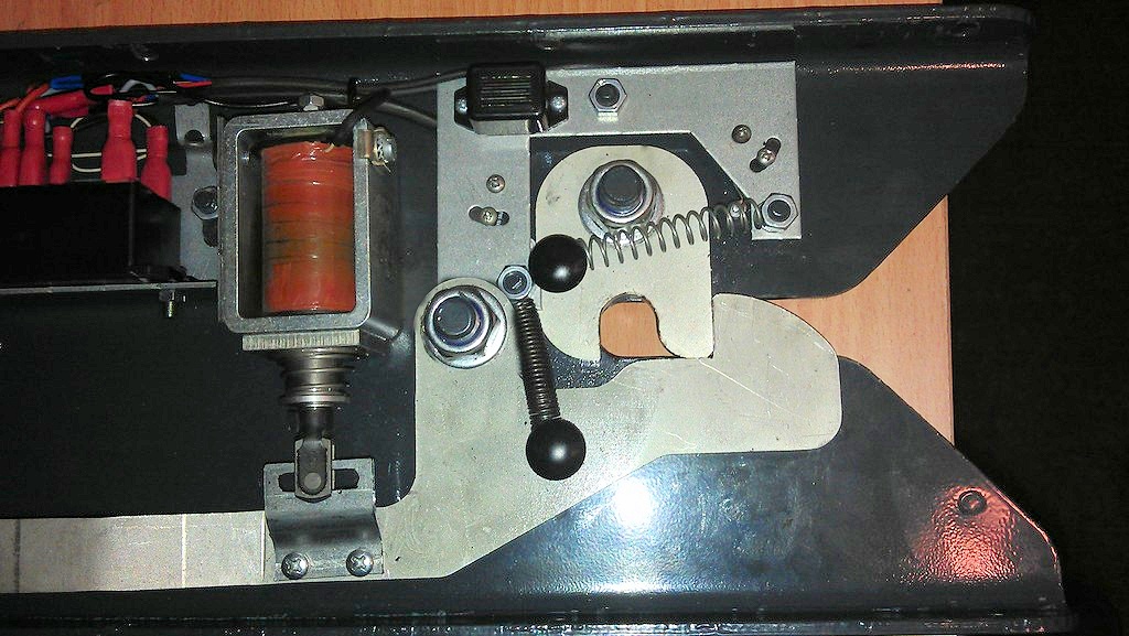

I drive a 2010 voyager from my powertec f50 and recently my EZ lock has worn and will not lock. I have had the EZ lock replaced but my confidence is shaken as I have been using EZ locks for almost 20 years and these ones seem to be unreliable after a few thousand miles of use. I'm weighty and I use a heavy powerchair that puts strain on the EZ lock but I'm struggling to accept that the slight wear (see pics) is responsible for the unreliabiliy issue. I am hoping that the wheelchairdriver legend BM and forum users my have experience of this issue or some idea of why my EZ lock is effected this way?
Any response appreciate, thanks

Postby Burgerman » 23 Sep 2013, 12:53
AFTER LOOKING
The LARGE pivot bolt is in the wrong place. Any rearward loading will try to spring it open. Look at the following two pictures. I Edited one of them to put the pivot bolt in the correct place. On the centreline. NOT offset! Look carefully.
Looks like one of bekkers. But totally different to mine. Take it back and tell them its not designed correctly. Someone that doesent understand physics designed that, and its dangerous. A stronger spring will "appear" to fix it. But if you get hit from behind, or on a steep hill, it will release.
Fundamental design error. They will/should do a recall. Going to look at mine!
Photo 1 WRONG!!!
Photo 2 FIXED!!!

Postby Burgerman » 23 Sep 2013, 20:03
If you don't believe me, then visualise that bolt even further to the side. Or mentally draw a line from bolt to the flat 90 degree sliding edge. That edge would need to be at about 5 degrees anti clockwise to give security.
That pivot bolt MUST be central, *(or the contact surfaces angled so that they are at 90 degrees to the pivot point at a tangent to an imaginary "circle").
One look at the videos will tell you I am correct. Saw the error as soon as I looked at it. Pretty obvious.
What's more, mine is the same. So I tested it hard. If I try, full power reverse chair, and parked on an uphill section of road I too can reverse out if I rock the chair! It pushes the spring out of the way as the geometry forces the latch to open.
Like this. http://www.youtube.com/watch?v=NsYqJ-l3 ... e=youtu.be
As usual, I will need to repair it properly myself because this is an accident waiting to happen.
For EG, at a busy junction. Waiting to turn onto a main road from a side road on an uphill slope. See gap, gun van, roll into the back and cannot steer or stop... :shock:
Why would they not see this? And its not just one manufacturer since they all copied the same error from each other!

Postby Burgerman » 24 Sep 2013, 15:19
is the solenoid supposed to be 'on' all the time when the pin is captured?
No its just a release. It is still / remains powered though until you reverse out. Then a micro-switch turns off power again.
even with the pivot off center there would not be much force req'd to hold the arms closed.
The Geometry is simply wrong. The greater the force the chair applies (say you get hit from behind, hard or whatever), the greater the force opening it against any spring fitted. A stronger spring will hold it close more securely, but push hard enough and it will release. That is simply not a safe design. Its a fundamental design error. A schoolboy one that any retarded engineer would spot. Who designs these things... Its like saying 'lean hard' on the car door un a turn, and it will spring undone... Not acceptable! It SHOULD be the reverse. It should hold harder under load.
There should NOT be any 'opening' force applied by the chair. Just a rearward one. The bolt needs to be central for this to be the case. These look like bekker devices so far inc mine, are you telling me that all the US ones from eZlock are the same?
Huge liability issue. Its simply unsafe.

Postby Burgerman » 24 Sep 2013, 19:52
Trust me the angle will need to be about 5 degrees, to make it 90 degrees to the pivot bolt before its safe. They don't understand what they are looking at.
Any less than 90, and it WILL open if theres a sudden or high load. They do not understand the geometry. The chair is PUSHING that bar sideways.
I suggest you send them a link to this thread.
Filing yours isn't a solution, even if it stops you pulling it open. Because it will not be safe unless the whole part is filed by around 5 degrees. They need a re-design. Remember, I too can get my chair out of mine!

Postby Burgerman » 24 Sep 2013, 20:30
For it to be safe, it MUST be either exactly 90 or steeper so it locks it shut under load. Yours is doing the opposite.

Postby tomcmo » 25 Sep 2013, 15:03
Just to get my head around the locking action I have put together an altered image of my lock side by side with the original. I think that is the general ptinciple behind the orifinal EZ lock that increases the lock with the direction of the force, opposed to my lock that unlocks with increased force.
tomcmo

Postby Burgerman » 25 Sep 2013, 16:51
That's correct. That is one way to do this. That's what ezlock do.
On your altered image, that neither locks or unlocks under load. So the spring is adequate no matter how strong. The angle would need to be even more steep to hold it shut (positive locking) under load.
The other way is my altered image with pivot bolt central. They both result in the same affect, with zero opening or closing force - only more loading.
Original design = fail...
