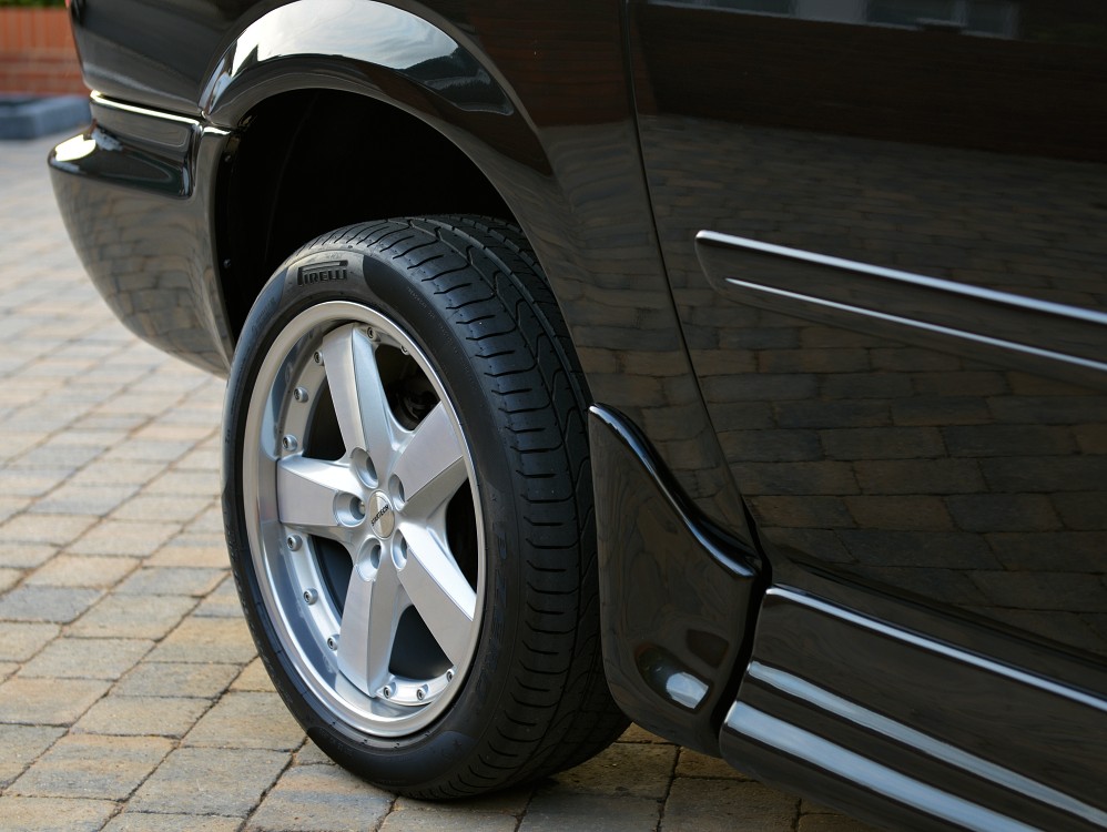

OK... Just finished.

And they do not feel any different to the tyres we removed. Slightly harsher (10 percent?) in curbs or speed bumps, otherwise they seem smoother and quieter. And thats expected since they are lower profile. Amazing considering the bad rep that runflat tyres get! Steering lighter too. Pressures at 34 psi.

Looks Very Nice.
Have you been on a dual carriage way with them yet?
Its the long distance that matters, You say they are smoother than the kumho 18s?

Yep went straight down the M180 awful concrete road (dual cabbageway)... Its loud... Has grooves cut left to right for drainage. Its quieter and smoother. And wheel balance perfect. Very impressed with pirellis every time I used them. Even on big bikes. Went to 120mph eventually on a slight downhill (on a private road :shock: ) just to test. Been on for 45 miles now.

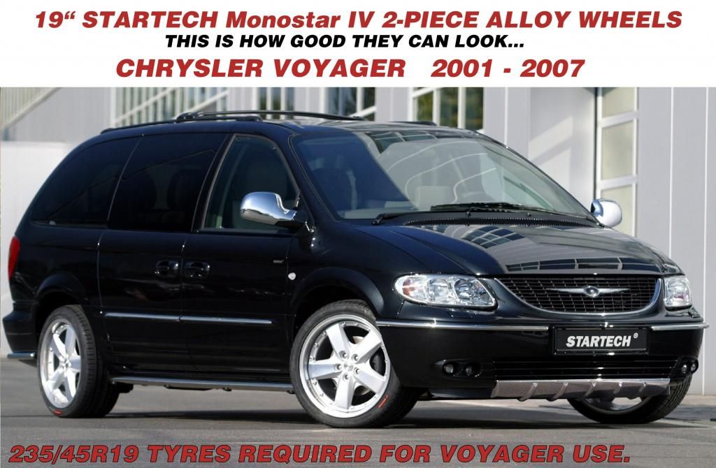

Hi BM
I'm back on the wheels n tyres subject again.
I have been looking at the "Tyre Size Calculator" on etyres - http://www.etyres.co.uk/tyre-size-calculator
The stock wheel size on 2001-2008 Chrysler Voyager / Dodge Caravan is 215/65 R16
I put into the calculator the tyre size you have chosen for your 19's - 245/45 R19 - For improved ground clearance with wheelchair conversion.
The difference in diameter is 2.48% & that is 17mm taller.
As I am a new driver using paravan sticks & not wanting any tickets, I am very concerned about the difference in the speed
For example & Just a guess..
If the speedo reads 30mph am I actually going nearer 32mph ?
If the speedo reads 70mph am I actually going nearer 74mph ?
A size 235/45 R19 tyre is different to stock by 1.17% or 8mm taller
It seems a safer size for the speedo, but then the rim does not have quite as much protection :?
How far out is the speedo really on 245 45 19's & can speedo's be calibrated in any way to suit a larger rolling radius?
No because STOCK tyres/speedo usually read between 5 and 10mph HIGH! For a bunch of reasons.
Just to begin with tyre sizes are nominal, not exact. Different manufacturers tyres vary by more than this! And 8mm of tread can wear off changing diameter by 16mm. Even inflation pressure varies this diameter. And by law a speedo must never read low. But ignoring all of this...
Almost all vehicle speedometers over read - often more so at higher speeds. And two identical vehicles may read differently too as these things are not very consistent.
The GPS in my phone is accurate. My vans speed used to over read quite a lot at low speeds and was almost correct at high speeds. The revese of what you usually find, but over reading all the same. After fitting "bigger" tyres it now under reads by about 1mph at 40mph And by about 2.5mph at 100+
That actually makes the error muchless than before... But in the opposite direction. Either way more accurate than you need.
What I am saying is that car speedometers are not accurate anyway. And the difference it makes isn't big enough to matter and may end up improving its actual accuracy...
Some start off more accurate than others. Test it with your phone, and then you decide if it matters. Anything up to a 5 percent error wouldn't make any practical difference to you would it? That would be just 1.something mph at 30mph town speeds. And you wont get a ticket unless you are significantly above the limit.
Read this. Fitting bigger tyres diameter usually just makes your speedo MORE accurate... http://www.thecarexpert.co.uk/how-accur ... eedometer/

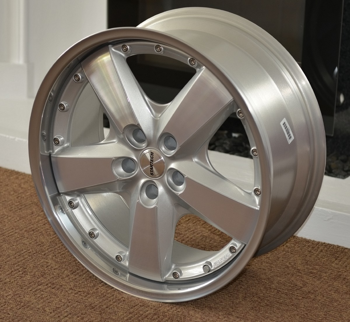

I paid 78 uk pounds each for these. Inc 2 sets of centre caps, and valve adapters, and nuts. And all wrapped in plastic, boxed etc.
So you can get 5 for 400 uk pounds. Or about 400 euros give or take a bit. Or you COULD about 1 year ago.
These are 2 part wheels. So IF they are a bit too far out (and touch your rear door trim when open) you could just add a washer or two washers to where the rim bolts to the centre. Mine don't. there's a 3mm gap.
These are actually branded Startech, but are in fact Brabus wheels. That may help you find some.

I can, but you are looking for any:
19 x 8.5J ET 35, (114.3 X 5 STUD) WHEELS. 245/45/19 tyres
OR
20 X 9J ET 35 (+/-5) 245/40/20 tyres.
OR
18 X 8.5J ET 35 245/50/18 tyres.
ET may vary 5mm.
