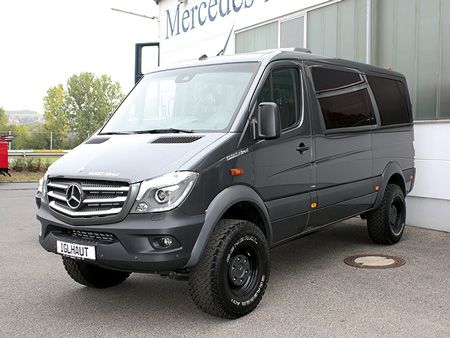

Thats because fuel is around 8 dollars a gallon! So big stuff is always turbo diesel.
THIS is available as 4X4 and can have a set of serious wheels and tyres. Lowered floor. Lift in side door. And can be wheelchair driver/passenger as well as capable of some serious off road.
Sprinters can be ordered 4X4 and then raised and bigger wheels like this. Interior fitted out any way you want. Sprinters are a common wheelchair conversion. Side or rear door. Plenty interior height and door height.
