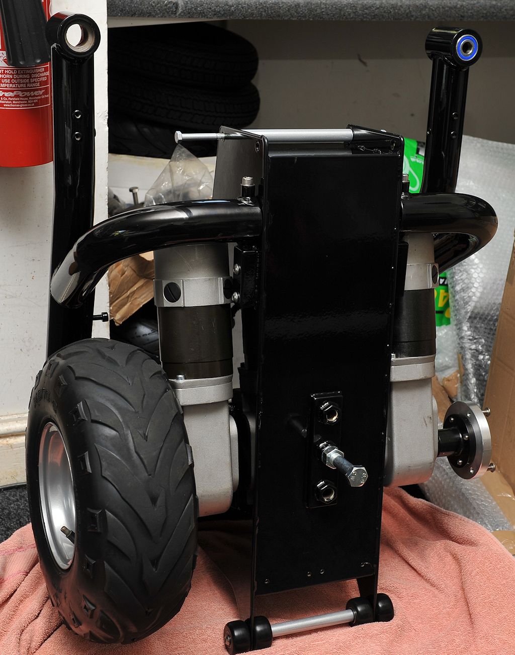

I make my Attachment "pin" bolt VERY solid. Short, 26mm of thread, well and truly threaded and welded nut as well. (about 2 inches long with the tie down mounted high on spacers to give 2 inches of clearance in use).
I make sure that in a sudden stop the FRONT EDGE of the battery box is steel, 4mm, seam welded and has some 16mm bars across it bolted from the sides. Because one of the biggest issues is heavy batteries continuing forwards...
And The SEAT BACK has to be strong. And the tilt mechanism if you have it must be very strong. I dont, but have rubber mounted seat front. Thanks for reminding me. It will get a strong steel rope tether just in case too now to protect if I get hit from the rear. And it needs an anti tip floor mounting tie down that is strong too for the same reason.

Postby Burgerman » 24 Sep 2011, 22:37
See, tie down mounting (3 position possible, but the bolt needs to be radically shortened yet!) And thats not the wheel or worn out tyre I will be using...
See also the bar at the top (front) across to stop the battery moving forwards just in case. There will be another at the bottom too.
See also (JC) the point where the frame /centre section connects.
Posts: 70439
Re: Automobile Accidents and Wheelchairs
Postby Burgerman » 24 Sep 2011, 22:42
Notice too that the rear frame and anti tips are what its standing on. They dont protrude so keeps the chair shorter.
Posts: 70439
