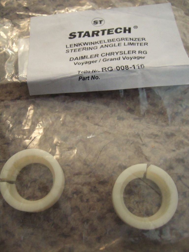

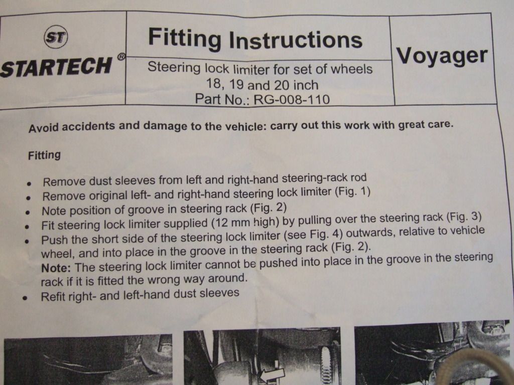

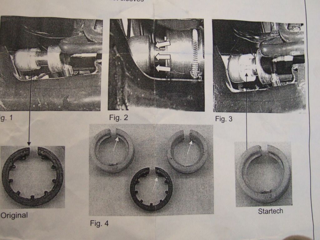

After a long 19months getting my set of wheels complete they are finally fitted.
They are 18x8,5j with 245 50 18 Rubber.
My car is slightly different to Burgermans in as much as the space in my front wheel arches is smaller.
These things rub the inner panel on full steering lock, so having to steer the car a quarter turn less in tight spaces in either direction.
A bit of a pain, But here is the answer... Thankyou Ebay...
My local garage mechanic has confirmed the limiters can be fitted to the steering rack in under 30minutes a side & should be relitively easy when up on the ramps.
I hope they do the trick.
The quarter turn on the steering wheel was basicly tested with a flat cable-tie, sliding between the tyre & panel. A few milimetres difference.

Postby Burgerman » 14 Sep 2012, 02:35
Or a slim wheel spacer. That 245 50 18 tyre size is perfect on that van.
