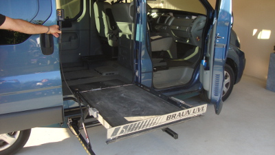

Hello, i'm looking for a used van for my daughter in France.
I have found a Renault Trafic with a BRAUN UVL Lift like JenR's van.
Is this kind of lift very usefull and reliable ?

Braun UVL Lift mounted on a Renault Trafic

Postby Pierrick » 17 Sep 2014, 21:29
The Lift was clean and lubricated, the van too ... i finaly bought it this week.
I havent got any problem to come back home with my Renault (1000 Kms on motorway at maximum legal speed).

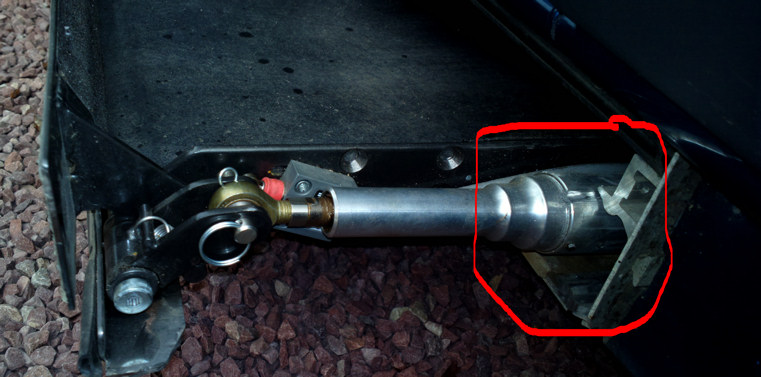

But i discover later than the barrier actuator was scraping the housing assembly as in this picture :
After many operations i finally modifiy the 'below stow switch', it seems to be ok.
Has anyone else got this problem with BRAUN UVL lift ?
P.

I finally found a solution for my barrier actuator : 3 hose clamps !

Postby Pierrick » 02 Nov 2014, 17:05
Hello JenR, i hope you still be enjoyed with your VW T5, every one says it's the best car (excepted Burgerman Dodge's) for disability.

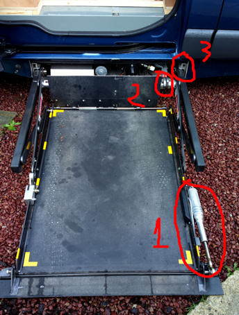

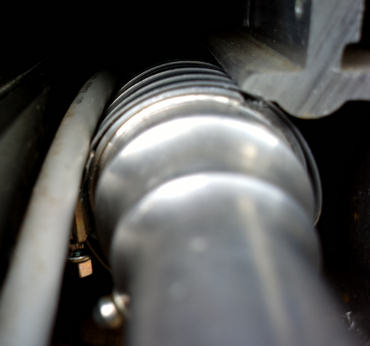

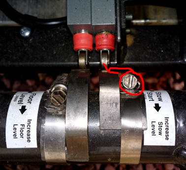

My Braun UVL Lift works well (it has 3 years old) but i noticed that the cylinder (Vérin in French) of the front gate actuator rubbed against the frame.
I shot 3 pictures to explain.
On the first there is in 1) the cylinder, on 2) the adjustments rings, 3) the place were the cylinder is rubbing on the frame
Uvl Lift
On this one this is the cylinder rubbing on the frame when the lift is stowing.
Front barrier actuator when stowing the lift
On the third, the adjustment cam that I placed as best y could :
Stow position Adjustement cam
Have you noticed something like this on your UVL ?
P.

Postby JenR » 05 Nov 2014, 09:36
Hi everyone.
Sorry for my (very) late response. I kinda forgot about this topic...
@Pierrick: The mechanism to adjust the stow position of the lift when it slides into it's housing is indeed very sensitive.
You can change it with the 'increase stow level' clamp that is on your picture.
If that clamp is set correctly (very sensitive, 1mm is a lot), the cylinder does not rub against number 3 on your first picture. But if you lower the stow position too much, the lift can't be stowed anymore, it gets stuck when it's almost al the way in (sticking out about 7cm).
I regularly have the issue that the stow position is too low, then the lift gets stuck when stowing... This is mostly caused by my dog that jumps on the lift when it is not completely out yet. This screws up the setting of the clamp...
I now have a good setting on the clamp, in which it stows completely, and doesn't scratch number 3 (barely, half a mm of room).

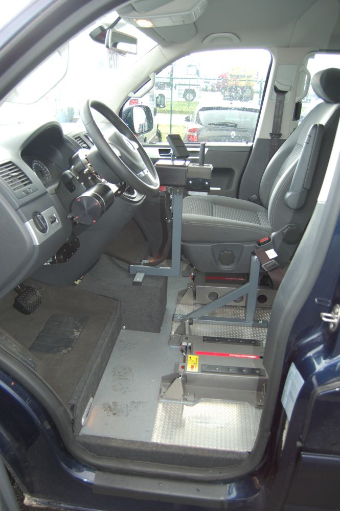

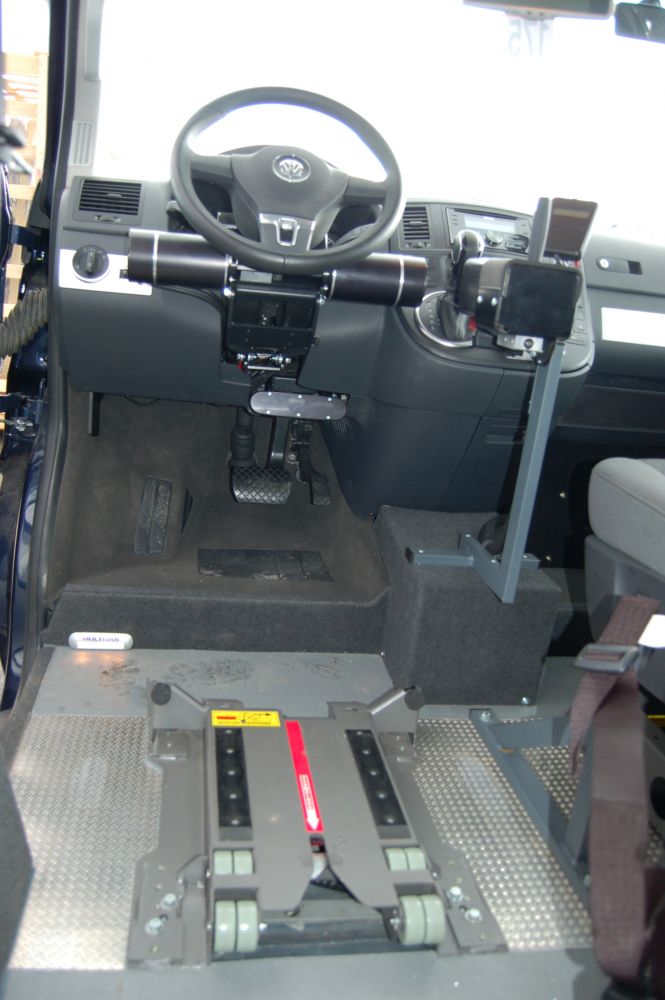

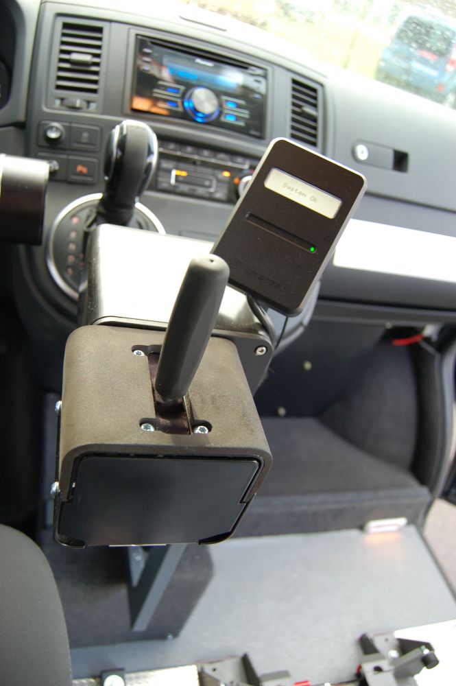

@red dragon, here are more pictures from the inside:
The 4-way joystick:
Here you can see the permolock, and the amount of floor that was removed. The box on the floor (below joystick) holds an extra battery for joysteer, and some of the electronics.
Here you can see the other chair that is on a permolock as well. The chair can be moved to the driver side, and my wheelchair can be placed on the right side so I don't have to drive.
