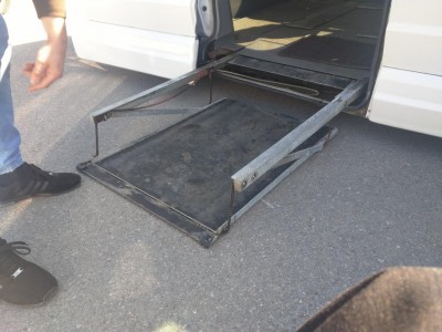

i do not know anything about Kangoo, but let me elaborate about my case. the car i mentioned and i am intending to buy (Chrysler Town and Country) has air suspension and is able to get quite low to the ground. the car is actually a WAV, but it was adapted for manual wheelchairs. we tried to lift me with my electric wheelchair but the existing elevator was not able move me at all. i just saw maximum possible straight ramp length, the floor height from ground (unfortunately i did not measure it) and though that it may be doable without too much engineering.

So already has a lowered floor. You could just buy the correct motorised ramp from the likes of braun or rollx?
Designed for the job.

If you plan to do DIY regardless, try and buy a used Ricon Clearway Lift. At least that will be simple to fit and reliable.
Or a ricon folding lift. Less sutable, but also easy bolt on fit!

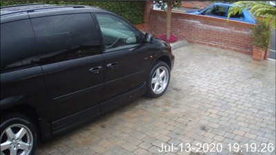

Heres mine. It was bought in 2006, and first driven in jan 2007. Thats a 13 year old van.
Its paint is like glass. Unblemished, probably better than brand new. About 100 coats of wax! Every last mm in every corner or edge. No marks, inside or out. The ramps clean. Looks like it was never used. The tyres are £1200 worth of low profile 109 inch pirelli P6 runflats. On split rim 9 inch wide alloys. Because I cant change a wheel. And theres a fifth one with tyre. There a factory sat nav, 3.8 litre motor, cruise control, etc and even the carpets are as new. I fitted an extra fitted carpet on top to protect. If compared to a brand new one it embarasses it, makes it look old and dirty. Inside and out.
Its done 11k miles... Never saw a winter road. Still smells new inside. Engine bay is polished. Again better than new. How much do you think it would sell for? Here, in the UK, maybe 5 to 10K if you can find a buyer as they are scared of Left hand drive... God knows why. I cant say I noticed after the first 10 mins.

Rained on, but waxed and shiny right now, my security cam.
