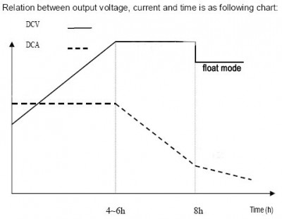

Stage 1, CC = Constant Current. This is also called BULK by the ignorant. In reality on a cheap charger this is simply the max power the charger has. So it will charge at say 8A as the battery voltage slowly rises. The charger is of course simply trying to charge at 14.4V or whatever. But hasnt the power to instantly push the battery that high. So its called a stage, but in reality its just go inadequate Amps (power) to hit CV instantly!
Stage 2, CV = Constant Voltage. Also called ABSORPTION, ACCEPTANCE ETC) This is when the charger or power supply reaches its preset voltage. It should hold this very steady, as the Amps naturally drop away as the battery becomes more full. When a typical lead battery reaches around 1000th of its Capacity then it is FULL 100%. This almost always takes 5 to 16 hours. When the current reaches this level, (E.G. 70Ah battery reaches 0.070 or 70mA) its charged. NOT reaching this level, usualy means the battery is not as healthy as new, and in any case for reasons of safety, and battery health CV should be limited to around 8 to 10 hours.
Stage 3, Theres a 3rd stage used for crappy chargers that end CV too soon, (typically 100thC or earlier) or used for long term storage. This too is a CV mode, and is at a lower voltage. If set to 13.6V AGM and GEL it continues the charge from stage 2, and completes it. At this voltage, limit this to say 3 days. But this takes a long time to fully charge the battery at the decreased voltage. And if this voltage is reduced further to say 13.35V then you can leave connected indefinitely for long term float storage to keep the battery healthy.
3 STAGES...

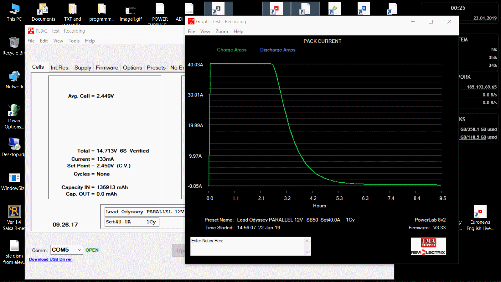

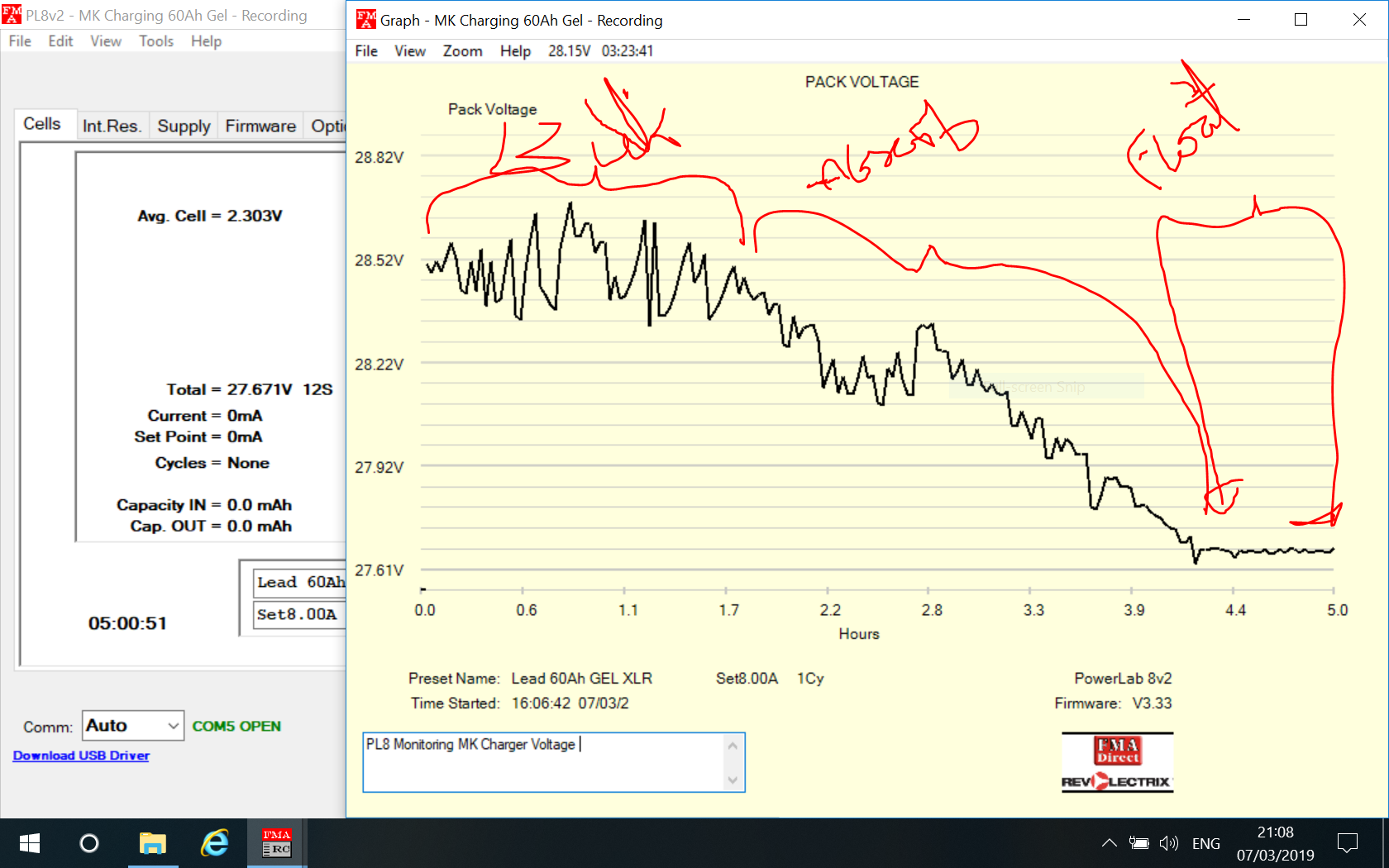

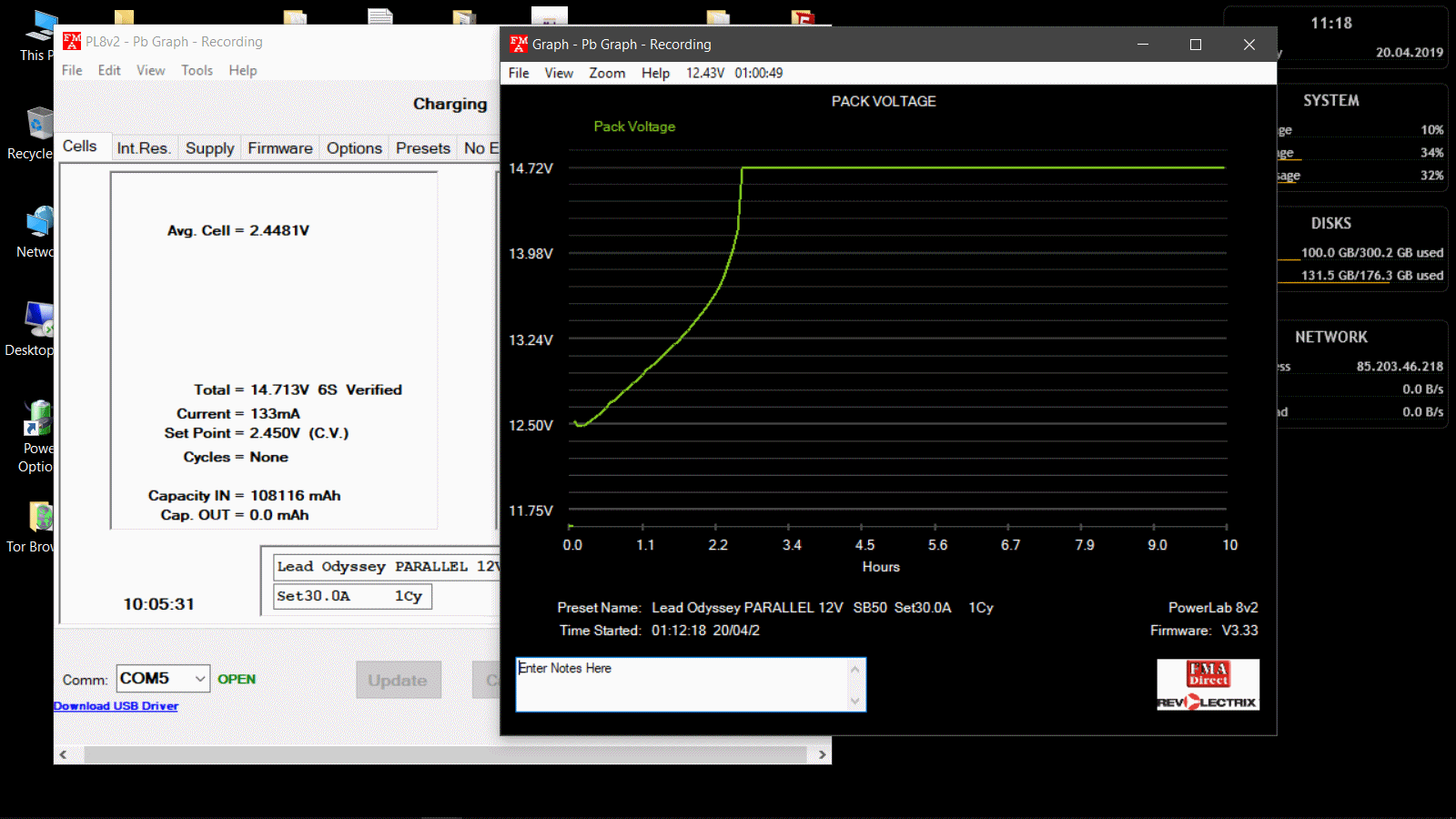

Below shows a typical SHORT CV stage, and requires long float to complete the charge.
Better to monitor CV current untill it drops to a really low level instead in cyclic use, as we do not have time to wait for a CV voltage to complete the charge fully. Doing this means no CV required. So faster charge. AS SHOWN BELOW on my PL8 charger. 8 hours CV and no float.

Postby Burgerman » 20 Jul 2019, 13:23
This is a MOBILITY charger, the upright type.
This is what it did when MONITORED BY THE PL8 ONLY! :lol: And you wonder why battery soon dies!!!
