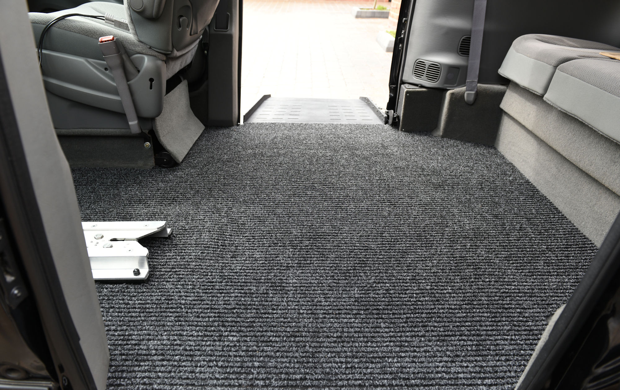

Postby Burgerman » 31 Mar 2021, 19:38
Can you see why I am finding it hard to imagine how its not possible to use absolutely any tie down? A little confused. What van is it?

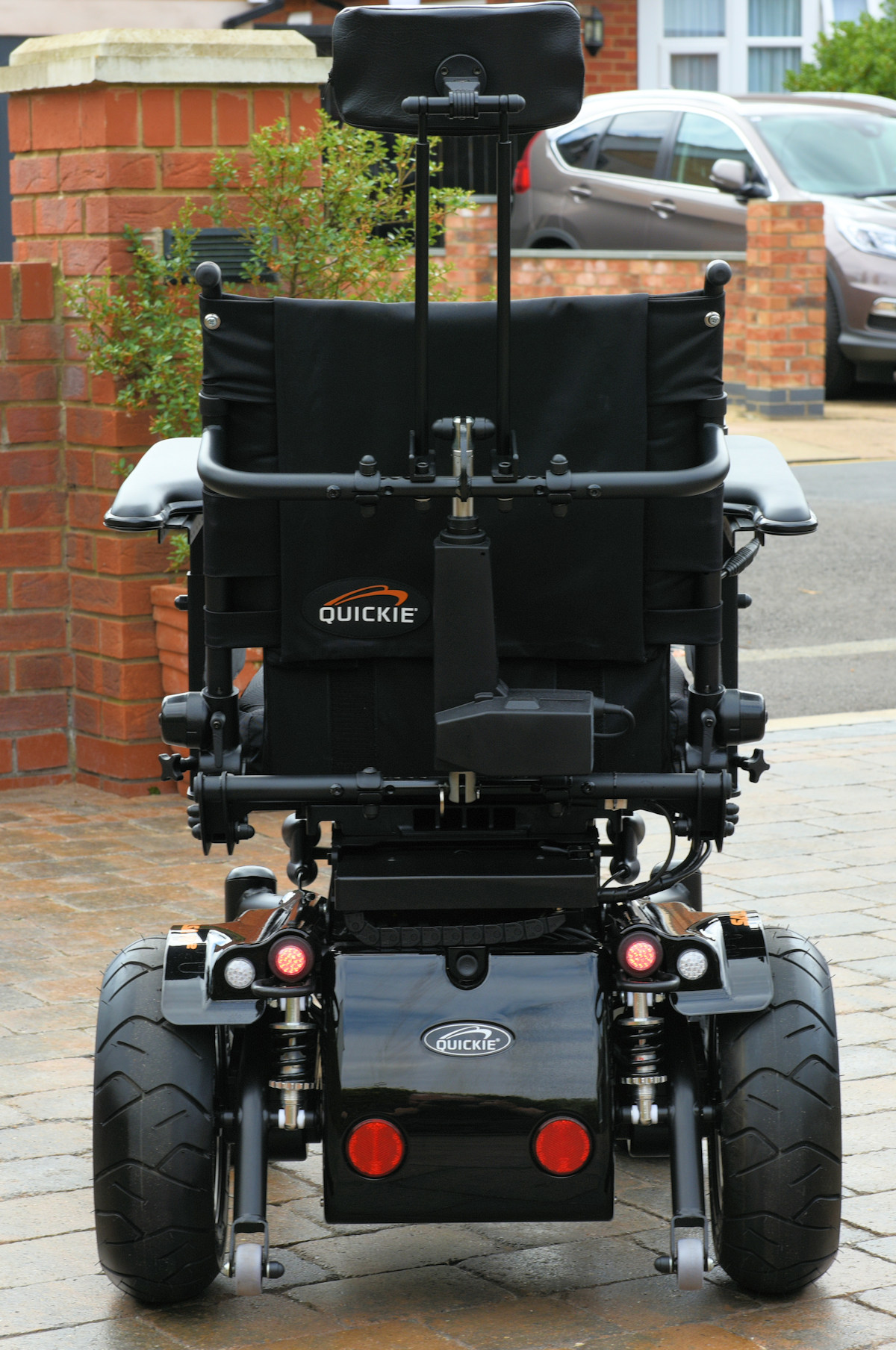

Postby Burgerman » 31 Mar 2021, 19:46
This shows the bolt sticking down. On all my chairs it is 55mm off the tiled floor. Thats the correct height to sit in the slightly raised tie down. Its a simple M16 bolt.

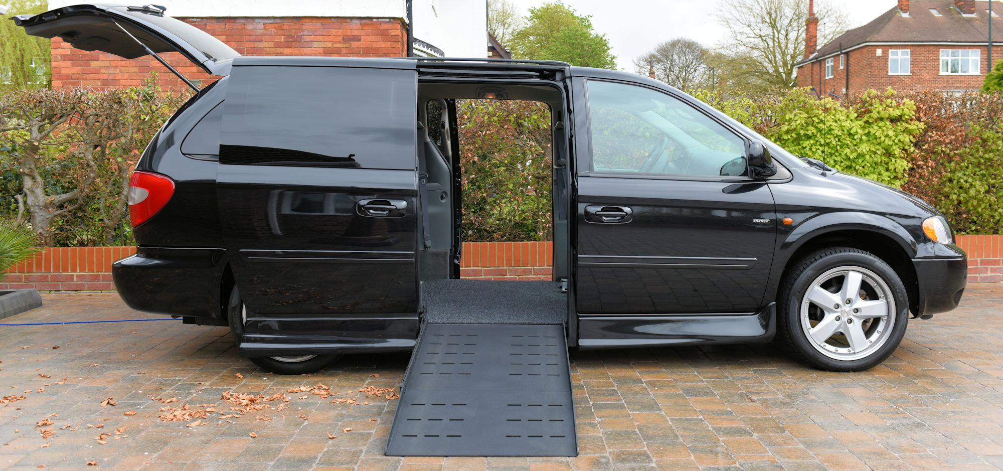

Postby Chairman » 31 Mar 2021, 21:08
Burgerman wrote:Van. And dock. Side entry. Plenty room. All my chairs.
That's not a van! It's a feckin' car with no driver's seat, no wonder you have the room. I use a VW Transporter, get in from the nearside (left) and park the chair directly behind the passenger seat and to my right is a six-way drivers seat that I transfer into then take that forward to the steering wheel. If I drove from the chair I too would have the room.

Postby Chairman » 31 Mar 2021, 21:15
Burgerman wrote:Can you see why I am finding it hard to imagine how its not possible to use absolutely any tie down? A little confused. What van is it?
No, if you read what I said I can't see you having any difficulty understanding at all. I reverse into a lock and not forward. Dahl haven't crash tested their docking stations locked in backwards. Fitters won't touch it without certification.
I will more than likely stick with my Q'Straint system which works well, it's just the pin can be an arsé just when you don't need it to be. My next chair will have bigger wheels at the very least. The pin height works with too many variables, tyres wear and so does suspension move.

Postby Chairman » 31 Mar 2021, 21:17
Burgerman wrote:This shows the bolt sticking down. On all my chairs it is 55mm off the tiled floor. Thats the correct height to sit in the slightly raised tie down. Its a simple M16 bolt.
That ground clearance looks good but of course it will with circus wheels on. That's what I need to prevent intermittent scraping.

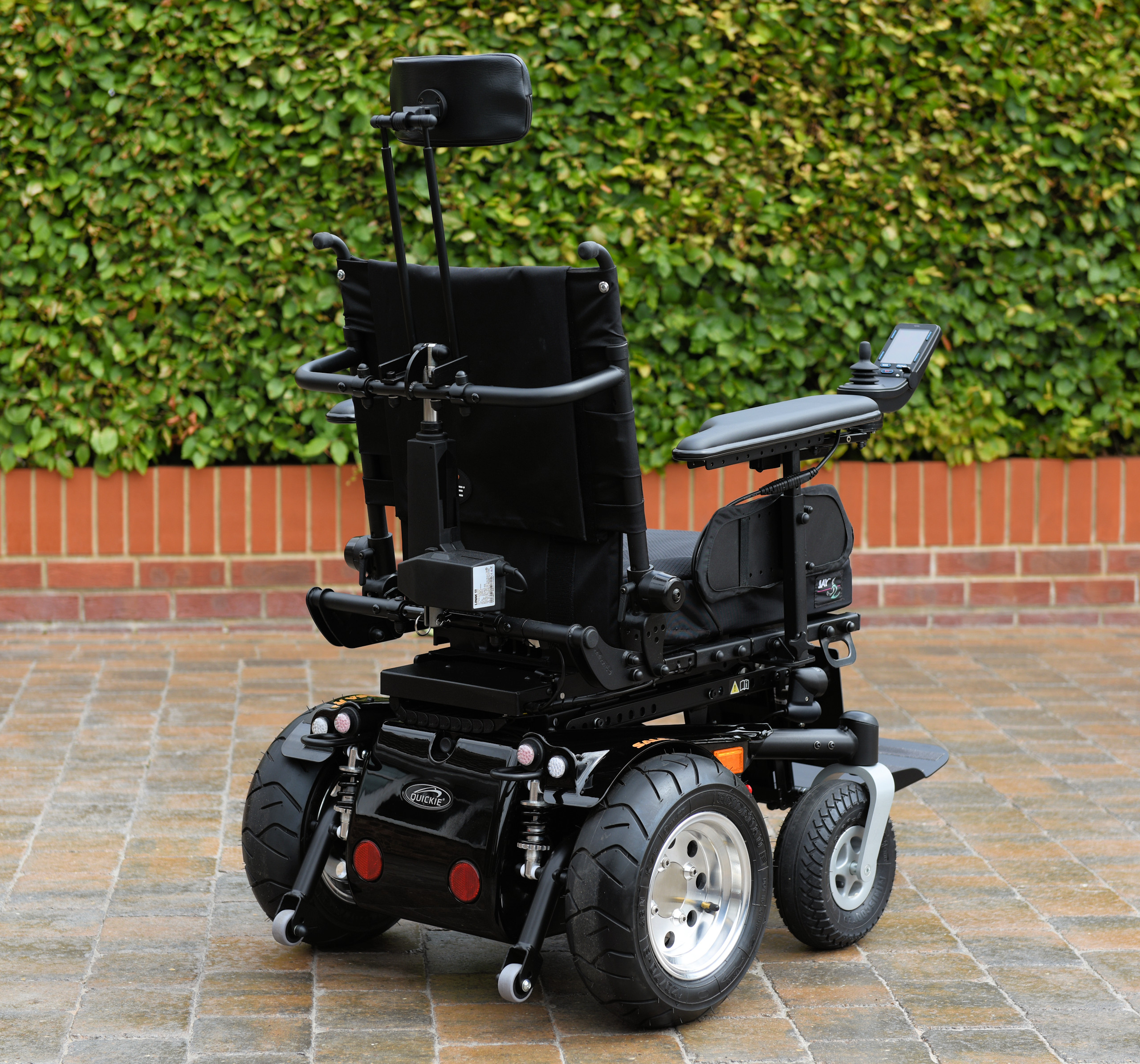

Postby Burgerman » 31 Mar 2021, 21:31
No!
The wheels are irrelivant. It does not matter what wheels you use.
The bolt height is the same 55mm from the ground on every chair regardless of wheels or tyre size because thats the correct height for my tie down. You adjust the bolt length by screwing in or out to get a 55mm gap to the ground, regardless. Or by shortening a longer bolt. You AIM for 55mm floor/bolt head and then I know it will fit the tie down perfectly.
That chair with the "circus" wheels above is as narrow as your Salsa at 25 inches. The whole chair is also shorter than a salsa. Its has a better ride because of the low pressure, large cross section tubeless tyres, and doesent sink on soft stuff. The wheels are the opposite to a styletto heel. Like snow shoes. Why would you think that the wheels are "circus"?
Heres another pic.
Its narrow. I designed it with the motors inboard and battery north/south so the fat tyres did not make the chair wider than the usual skinny tyres chair.
http://www.wheelchairdriver.com/images- ... mp-car.jpg

Postby Chairman » 31 Mar 2021, 21:46
Burgerman wrote:That chair with the "circus" wheels above is as narrow as your Salsa at 25 inches. The whole chair is also shorter than a salsa. Its has a better ride because of the low pressure, large cross section tubeless tyres, and doesent sink on soft stuff. The wheels are the opposite to a styletto heel. Like snow shoes. Why would you think that the wheels are "circus"?
I'm not comparing chair widths though, it's clear to see how much wheel is inboard gaining the benefit of big wheels with no disadvantages except maybe looking a bit like the circus is in town. That's not a bad thing unless you have to wear the suit and wig of course. To make something work properly it'll always mean stepping out of the norm.
