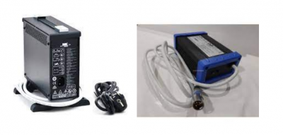

You will probably have a charger like these.
Quality gel batteries are charged in the first phase at a maximum of 28.2v at 20º.
MK Powered's mobility charger supplies 28.8v
When it's hot you have to discount voltios.
If you charge the batteries immediately after a long ride the batteries are hot and you have to deduct volts.
Excess voltage during charging shortens the life of batteries.
Many members of the forum use Shirley's charger.
