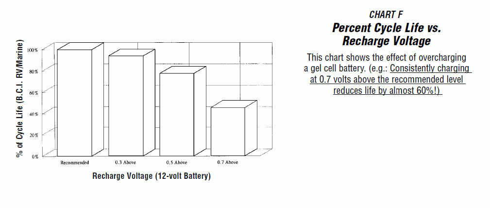

That "24V" that they all show is not the charge voltage. Its a way to describe that it charges a set of 12V lead batteries.
A dead lead battery when your chair shows you a fashing light is around 12.2V each or 24.2V for both when you actually measure it.
The correct CHARGE voltage on an AGM battery is around 14.4 to 14.6V (actually double this for 2 batteries in series so 28.80V to 29.2V) and thats what mosst mobility chargers do. But they are pretty bad at this and they actually wander around, and dont stay at this voltage properly. Then before the battery is properly charged, they stop charging at 14.4 to 14.6V per battery and drop to a lower float voltage that can be 13.3 to 13.8V (it should ideally be 13.6V x2 so 27.2V) indefinitely. At ths point the green ready light is on. But they ARE still charging.
So a gel battery needs a lower voltage, if you are to get the full service ife. That is a MAX of 14.10V per battery. 28.20V and 27.2V float. And almost no mobility charger even get close. So the battery doesent last. They dont anyway if they are too small for the job and yours are. So theres 2 things torturing your batteries.

As range and reliability are the main things I need, can I ask why the 45ah gel would be better than the 56ah non gel by the same maker?
Because an AGM battery is great for capacity, (but more Ah does NOT always mean more range as internal resistance is if anything more important) but they offer around half to 2/3rds the cycle life. So you get 350 cycles, from AGM and around 500+ from gel. So in a battery that is very heavily discharged, the gel is the only one that makes any sense.
The deeper you discharge a battery the less cycles it gives. And gels are much better than AGM when it comes to deep cycle discharges.
So if you want it to last, get GEL and charge it CORRECTLY!!!

But it doesent give anything close to the battery service life that you should be able to get.
Let me show you one small graphic from MK who specify 13.8 to a max of 14.1V for their gel battery.
So the perfect voltage (at room temperature) would be 13.85V.
And most charger are for AGM and can be anything up to 14.7V...

And UNDERCHARGING which most mobility chargers do, by stopping the charge far too soon causes even more damage! They rapidly become sulfated which likely costs at least as much loss of service life as charging at the wrong voltages.
Then people complain that the bateries lasted 9 months or less in some cases.
The MK can do 500 deep cycles. Or charges. Or it can do 200 quite easily if you dont treat it well. Or less.
But this is life. Knowledge is power. And most people just dont want to know and dont care and then they complain when it all goes bad. Not just batteries, everything!
