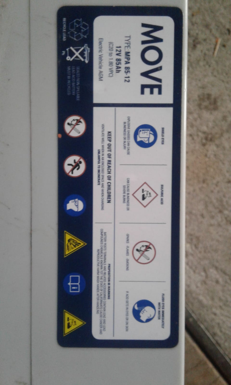

I will now add my specs.
Controller: Q-Logic 2
Control unit and module: still unknown, I’m trying to figure this out with the serial number.
Motors: DRVMOTR1306 and DRVMOTR1307 high speed motor
Battery: brand: Move
Type: MPA 85-12 12V 85Ah see attached image as well. I have two of these batteries.
I also have lift, tilt, recline and leg move functions.

I may add that thos https://movebatteries.com/assets/upload ... -85-12.pdf batteries are terrible.
5.5mOhm impedance means that you have high voltage drop under load. Thats more than double the impedance of the smaller 68Ah odyssey. And it follows that you also have high Peukert value. Which is why the battery is only a 46Ah battery at the 1 hour rate, down to a voltage way lower than a powerchair needs to keep rolling. It also claims a cycle life of just 350 to 400 at 75 % DOD with is half the service life of an MK gel for eg.
So your first upgrade step would be to fit 200Ah of LiFePO4! And get at least 5x the range. And a decade of service life. Charge faster, and do it once a week in winter.

How do you think you are going to fit a roboteq controller? Heres a few images from years ago. http://www.wheelchairdriver.com/BM3-construction/ Scroll through them. Non of this is plug and play. You will need to make all of this and source all of the parts. More importantly its not a paining by numbers puzzle, you will need to understand what you are doing and why.
