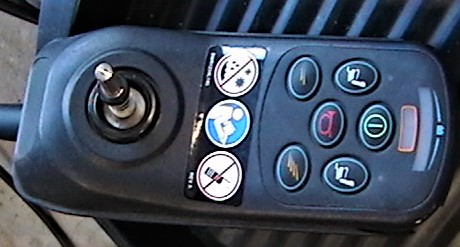

Postby PA PA BOO » 30 Oct 2020, 23:43
THE JOY STICK W/O THE UP/ DOWN OPTION IS D50401.03 ---- CTLDC1323 ABOVE
THE STICK WITH OPTION IS D50402.03 ----- CTLDC1324 BELOW

Re: Joystick programing
Postby PA PA BOO » 30 Oct 2020, 23:55
Not sure what you mean by "speed inhibits"
The controller that has the up/dpwn option for the seat goes really slow no matter how fast you set it with the buttons on the board so I can only suspect it has been programed to only go a certain speed and no faster. the other controller with out the up/down option responds to the on board buttons and will go very fast or very slow by using the on board buttons
Postby Burgerman » 31 Oct 2020, 03:29
Not sure what those are...
Someone else will know.
Speed inhibit is like this.
If its got a seat tilt, or a seat lift, sometimes seat recline, then theres a sensor that tells the power module the seat is up... Or the seat isnt flat... The PROGRAMMING which you can change, then tells the chair to go slow to prevent it tipping you over...
That can be adjusted or disabled. Or it may just be programmed to be slow in forward or reverse for reasons we dont know. Shaky hands maybe.
Postby rover220 » 31 Oct 2020, 07:15
Vsi so will need the of software and an xlr cable.
