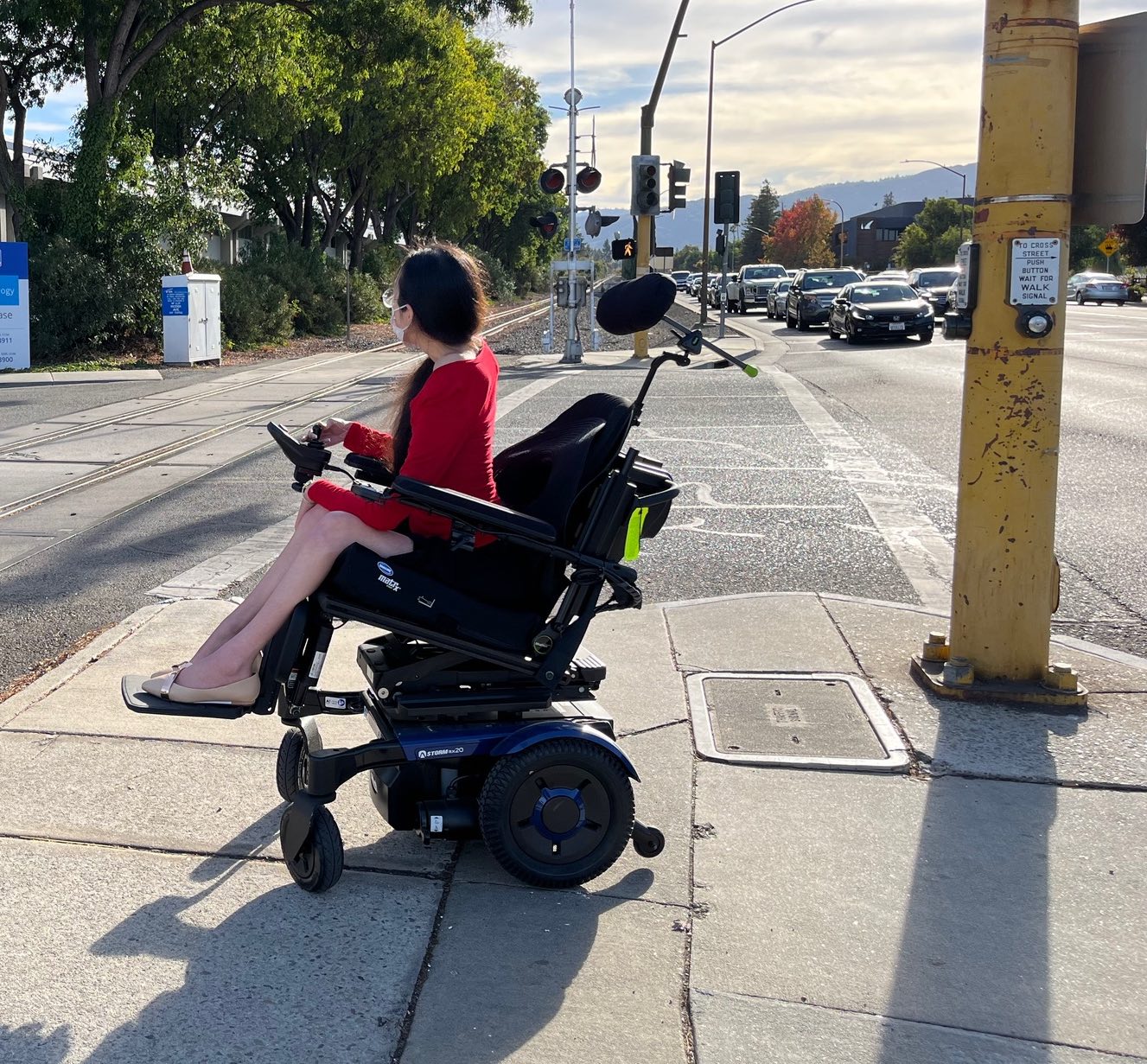

I tried the Invacare Aviva Storm RX. Great to know about the seat and heel positioning. I like having my heels tucked back anyway. Here's a picture of me in the demo chair.
I always drive tilted back to stabilize my sitting. I don't like having my feet extended outward. I want to be able to have my feet go back much further. I'm not even sure if that's possible with center post. I've heard it can go back a little, but can it really go back enough?
In a few weeks, I'll be comparing it with the Quantum R-Trak. Unfortunately I don't have many options beyond that if I want high speed, high speed at elevation, and a smooth ride. At least that's what I'm understanding.

You are small and light. So CG position doesent matter that much compared me or any bigger overgrown human! But you are sat a long way forwards. That may feel a bit unweildy indoors. And lose rear traction (and steer control) on uneven surfaces.
You might want to cut off that huge spike sticking out behind the headrest as it will hit everything around you indoors and confined spaces.
You seem to be tilted back a little. Maybe 12 dgrees. Its more stable, and less bouncy (greater rigidity) if instead you adjust the base tilt angle (the initial dump angle) so that it is where you want it to be when the seat is at its fully lowest position. I always do that so that my initial "dump" angle is 6 degrees on my chairs for my own purposes. So that theres no bounce or flex in the tilting mechanism. Feels much nicer to drive that way.
How far back the footrest and your heels can go is determined by a guy with the tools, and the front casters. These must be free to rotate as you manoever around without hitting the footplate. Even a 3mm gap between tyres and footplate is enough.

Great advice. About the huge spike—my plan and hope is to get a backrest that goes up higher and also serves as a headrest, so that I don't need a separate headrest attachment. Have you seen anyone do this?

Even if you like to drive so upright, you should not have the backrest so reclined. You have less stability than if you were supported and you would suffer less jolts in large potholes. If possible, I would also raise the tips of your feet a little. It always gives a little stability if you allow it. your physiognomy It's just advice, everyone decides in their own way in the end.

In your picture you look to be sitting on the friont edge of a seat that is too wide and too deep. And so too far forwards. And in a position that isnt stable. And yes footrest angle needs to come up at the front as you seem to be "standing on tippy toes" if you see what I mean. EVERYTHING including arm top height, forward position, joystick position, etc is all adjustable to fit you. If its not you need a guy that gets it, with a saw or a drill.

In your vid on the road hump, you nearly fell out of the chair because you are sat over the front! TOO FAR FORWARDS and sat upright with no weigh on the backrest. And so as soon as the front wheels on the rear drive chair touch the start of the speed hump it launches you into the air! Your backside needs to be over the drive wheels! And you need to be leaning on the backrest. Not sat up hanging over the front!

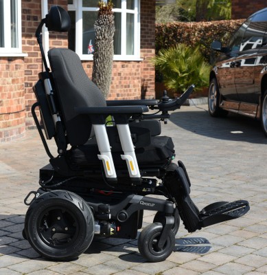

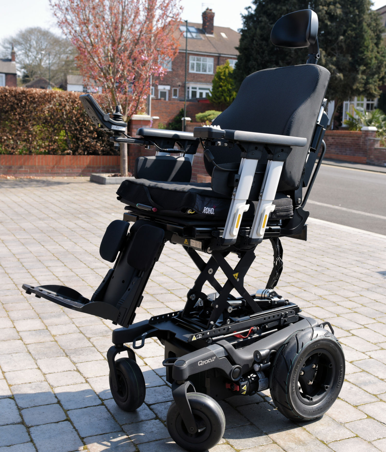

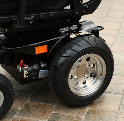

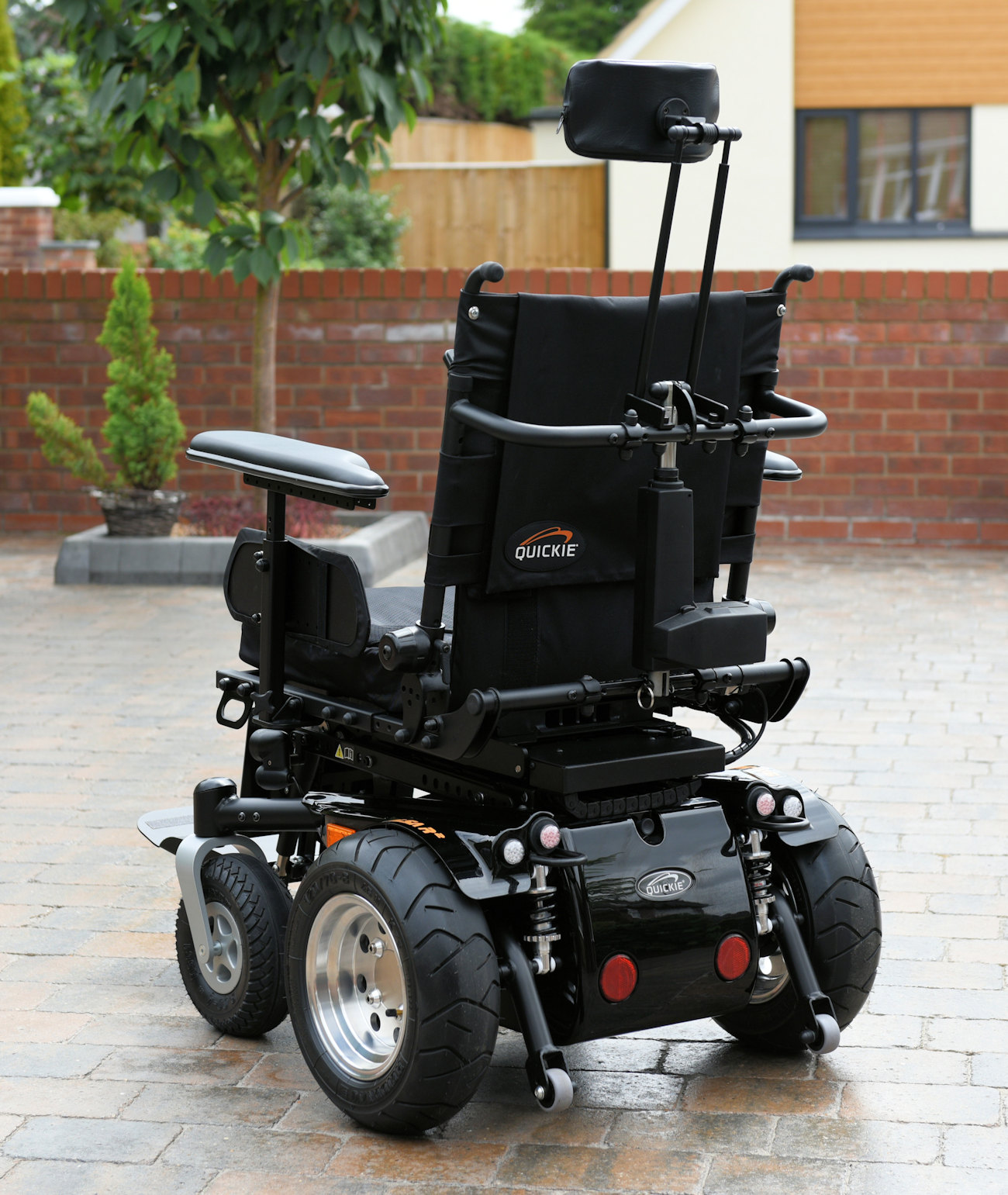

Heres a few of them.
NOTE that all are modified a little or a lot depending on what needed to be done to configure them properly! With me seated correctly, and programmed to steer and drive properly.
I got this for free, UK government, my assessement etc.
https://www.wheelchairdriver.com/board/ ... =2&t=12461
Scroll...
It fitted my requirements. Not how far back the seat is.

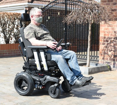

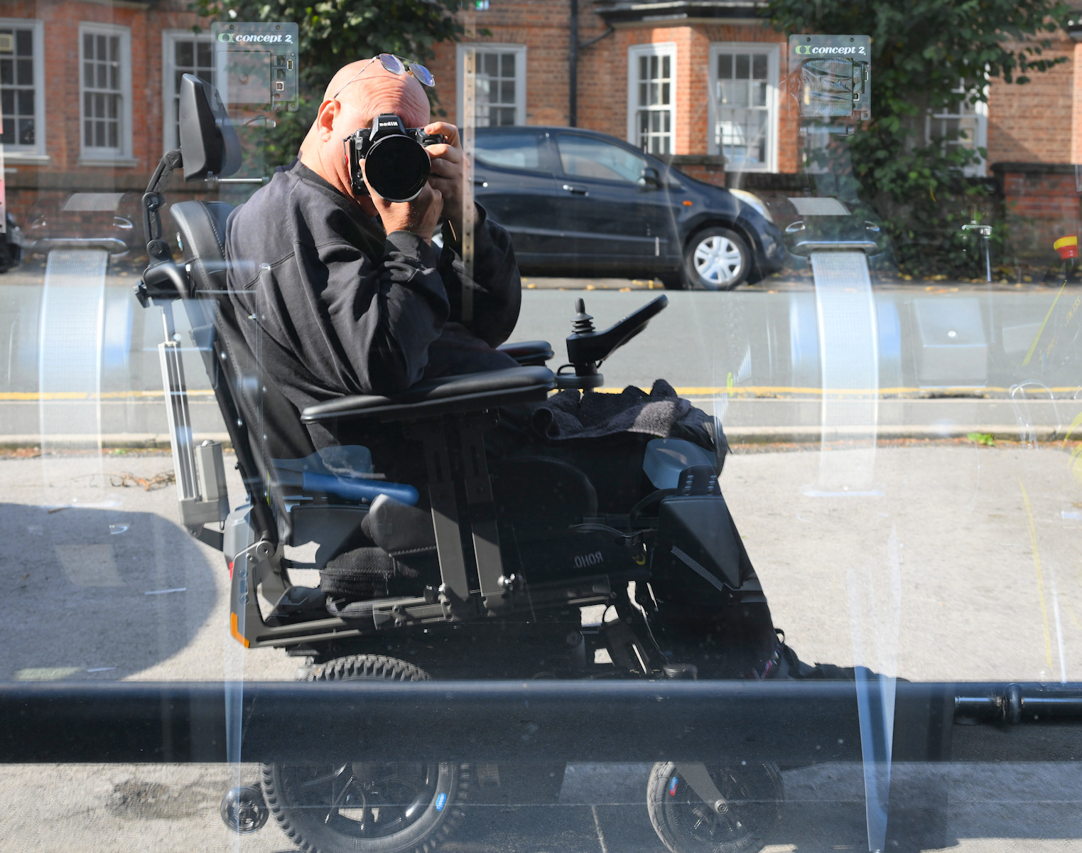

A reflection so I can photograph my position...
Also note headrest mountings. All shortened and some of it thrown away so is compact.
BUT NOTE ESPECIALLY the position of my backside in relation to the drive wheels...
This is true of all my chairs (to a greater or lesser degree) regardless of what it took to achieve. Or they all drive crap!!!
Seat moved back, correct static dump angle, armrests confiured etc.
Posts: 71119

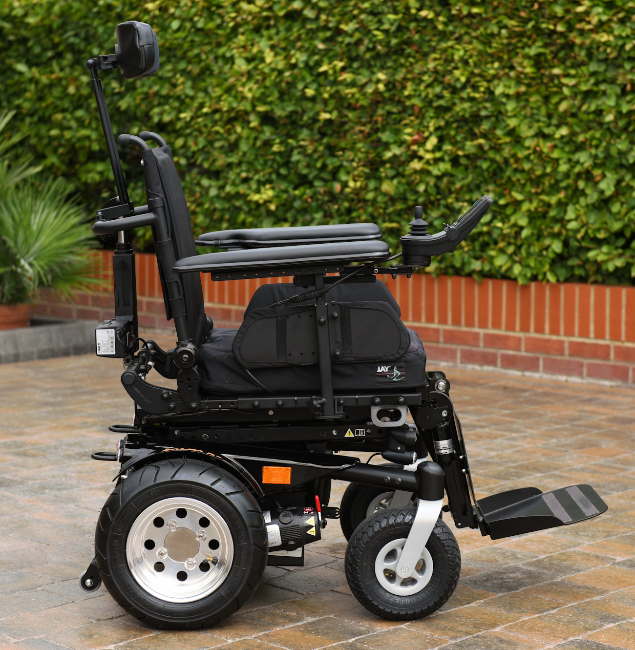

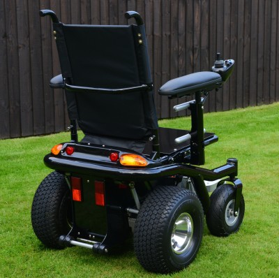

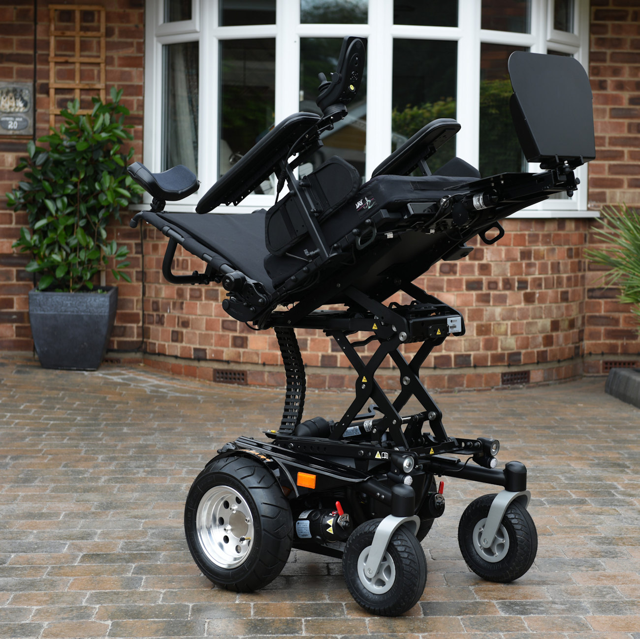

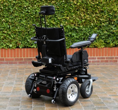

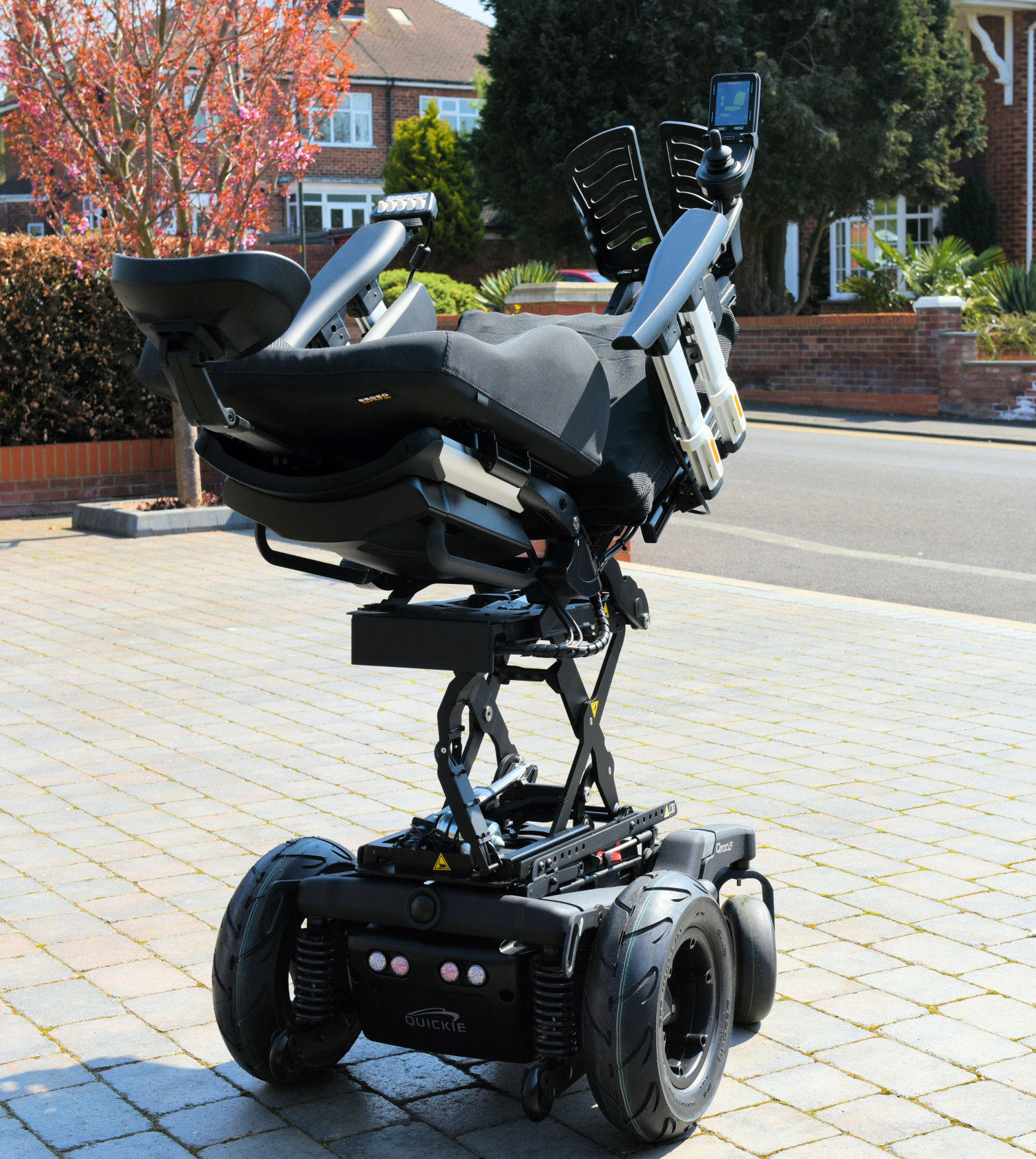

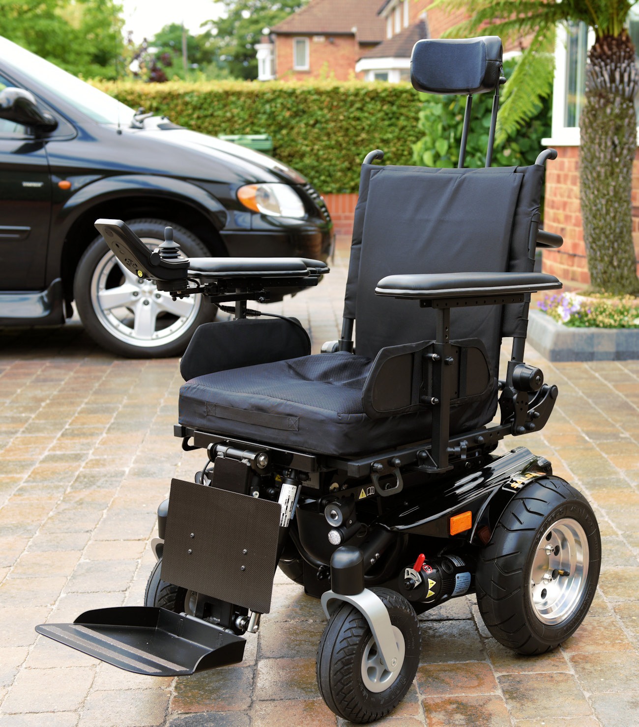

Some of my other rear drive chairs, all similarly set up.. All feel same to drive.
DIETZ SANGO ADVANCED
And INVACARE STORM 4 XPLORE...
BEFORE ADJUSTMENTS
BEFORE ADJUSTMENTS
Posts: 71119
Re: Hello
Postby Burgerman » 09 Nov 2024, 20:57
SALSA best of the lot!!!
Posts: 71119
Re: Hello
Postby Burgerman » 09 Nov 2024, 20:59
And a BM1, BM2, BM3, etc...
All same layout, similar programming, same seating position, same CG etc.
BM1, BM2, BM3... A series of chars, all similar and all different!
Posts: 71119
Re: Hello
Postby Burgerman » 09 Nov 2024, 21:06
Q700 R (Sunrise Medical)
Martin my carer...
More...
Posts: 71119
Re: Hello
Postby Burgerman » 09 Nov 2024, 21:12
Theres more but you get the idea...
