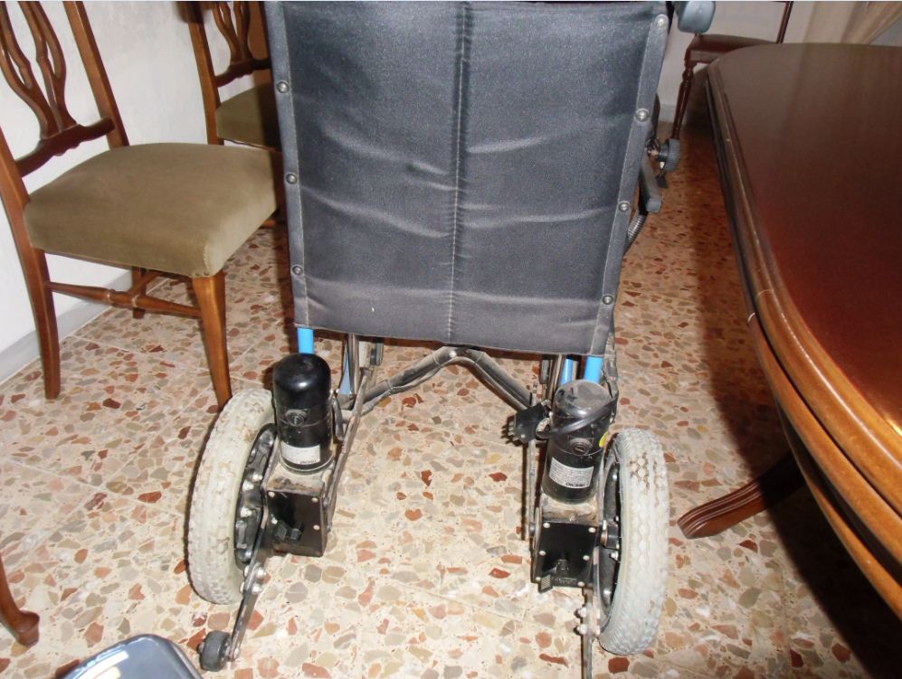

This is my power wheelchair.

I use premium batteries.
My battery charger is broken.
I need to buy a new battery charger.
A charger for to 30 ah batteries (sonneschein A512/30,0 G6).
