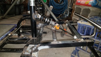

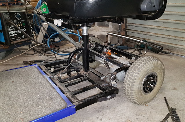

I like to go on bushwalking trails and to botanical gardens, but my moby has no rear suspension and the frame material is crappy 20mm x 20mm x 0.5mm wall square tube. I have broken the frame in a few places & welded it up only to have the frame crack around my welds.
The frame has a separatable rear subframe with the motor/transaxle can detach from the front half with the batteries. I never take it apart for transport so it seemed natural to hinge & spring the rear subframe to address comfort on rough trails and the frame breakage problem.
A non-independent rear suspension makes it less tippy than some 4 wheel independent scooters I've tried.

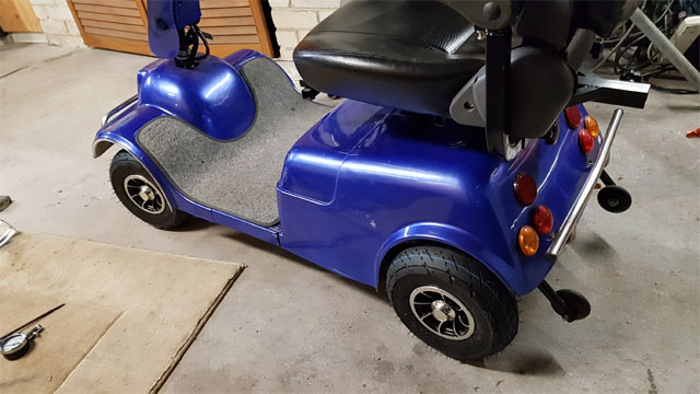

Grey tyres are awful, turn an ugly grey/yellow and just scream 'disability,' so I've replaced the medical meats with some pocket bike tyres. Looks much better.
