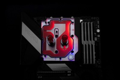

Postby Burgerman » 20 Jan 2022, 02:29
That monoblock now fitted to Crosshair Dark Hero motherboard. And the 16/32 core 5950X. And so is a huge amount of 3600 CL16 RGB ram. And 2x 2TB NVME 980 pro ssds. All looking great.
So now as soon as the hole in my foot finishes healing I will be building a new custom water cooled PC. Maybe 2 weeks. As the sore on my coccyx is also looking 95% healed!
Still need 3x radiators. Tube. Fittings. Water resorvoire. D5 Pump. And some EK cryofluid...

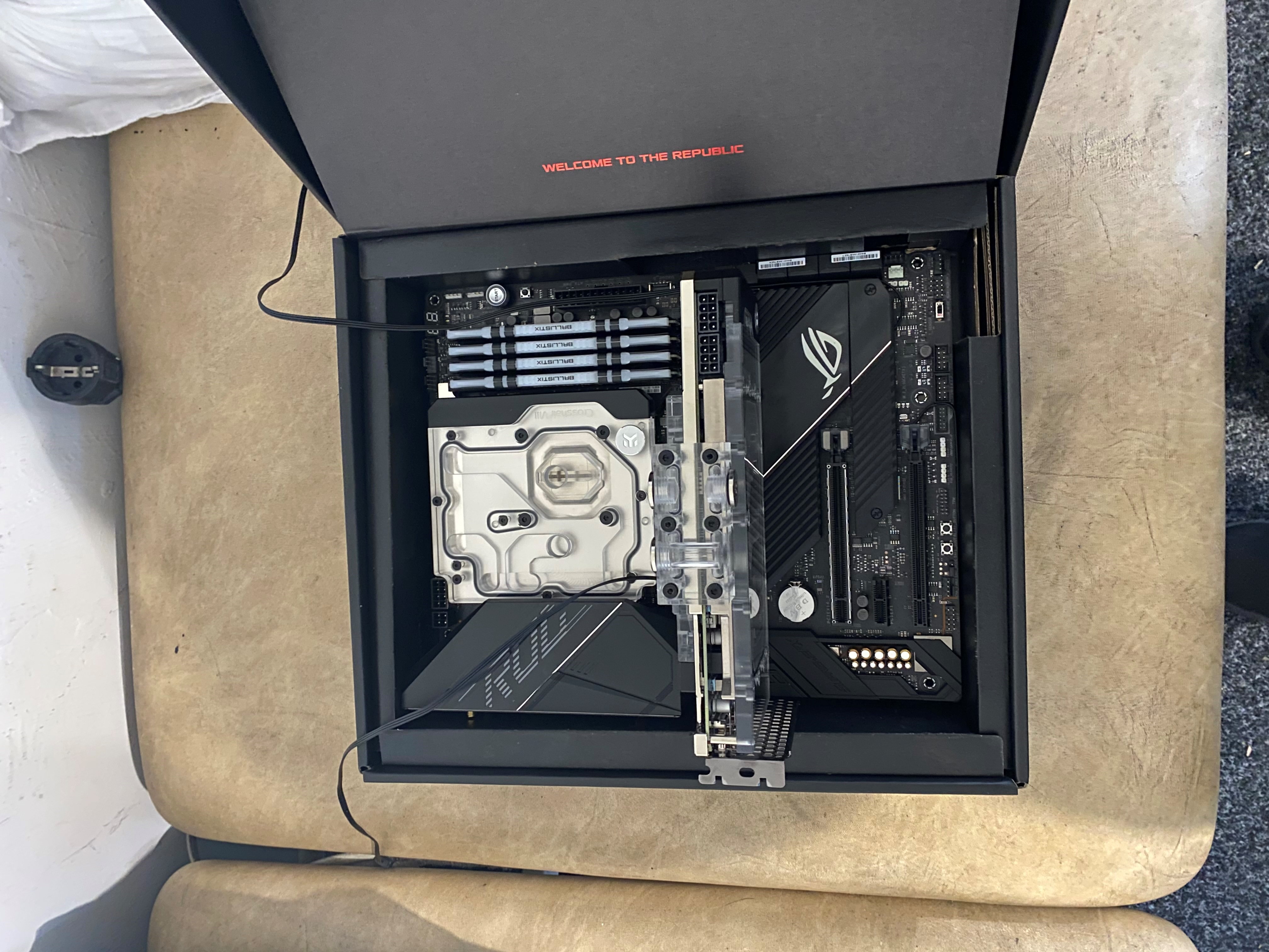

Postby Burgerman » 04 Feb 2022, 13:29
ASUS Crosshair Dark Hero
Two of, 2TB 4th gen. 980 PRO NVMe M.2 drives
128GB of 3600 DDR4 Crucial Ballistics Memory
16 core 32 thread 5.1ghz binned Ryzen 5950X CPU
Nvidia 3080 Ti graphics card
EK Monoblock water cooler for motherboard / CPU.
EK Water block for GPU
EK Water block active backplate for rear side GPU/memory/Card

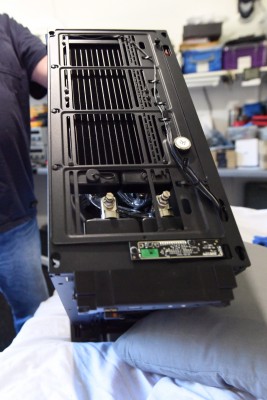

Postby Burgerman » 26 Mar 2022, 20:36
Whilst STILL on my bed, I completed the pipework, and everything else.
Does it work? Will tell you soon. Should have tested it before assembly. And before fitting later blocks, liquid metal heat past, and all the rest. This is almost done!
Will be filling loop, teting tomorrow and monday. 16 cores? 32 threads? 5 plus GIGAHERTZ? 64GB fast mem? And a stupidly expensive 3080 Ti graphics card. This is a years or more savings! Around 5k.
My carer took these pics. Sadly it looks a million dollars in real life but these are flash shots in a dark room... So bloody awful photos. Like its caught in the headlamps.
But will do some proper pics when the top, front, and glass sides are on. With the acid green or yellow solid coolant, and the RGB lighting is on. Later!

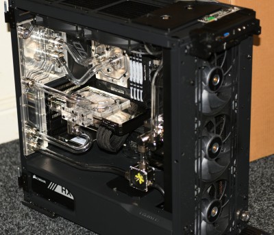

So, no messing about. Do it right! czy This will be silent. And very future proof.
It has a water temp sensor to control fan speed, and cpu tep censor to control the pump speed. And all the d-rgb contrlled by the motherboard.

Re: Ordered...
Postby Burgerman » 27 Mar 2022, 16:43
Theres not even any mess. I have a fill loop at the top (the silver cap with EK on it. Its a 1/4 thread. And 2 vents from a bathroom towel rail on top to vent any air from the two high points on the front rad. And a drain port that looks the same, on the front behind the front cover. I attach a 6mm rubber tube and a 1/4 thread fitting to these ports to drain or fill. Without even moving the computer. There are 2 red valves connected inline behind the side panel, to shut off any flow until I have the tube connected. So unlike all the mess you see on jay2cents etc I dont have a single drip...
SEE below.
UNDER TOP COVER, which removes with 2 thumb screws, is the following.
1. A nickel coloured fill port. Remove with fingers... Reveals a 1/4 thread.
2. A black temp sensing resistor probe screwed into the top 280mm radiator.
3. TWO air release vents that are really designed for a bathroom towel rail. But they are also 1/4 BSPP thread just like the water fittings to vent traped air.
4. The top radiator. This is smaller and only 30mm thick like an AIO sized radiator. Unlike an AIO it is copper... So no corrosion!
With and without a plastic plate that prevents the air cycling back to the case.
UNDER the top cover. NO plastic air deflector.
UNDER the top cover. WITH the plastic air deflector.
