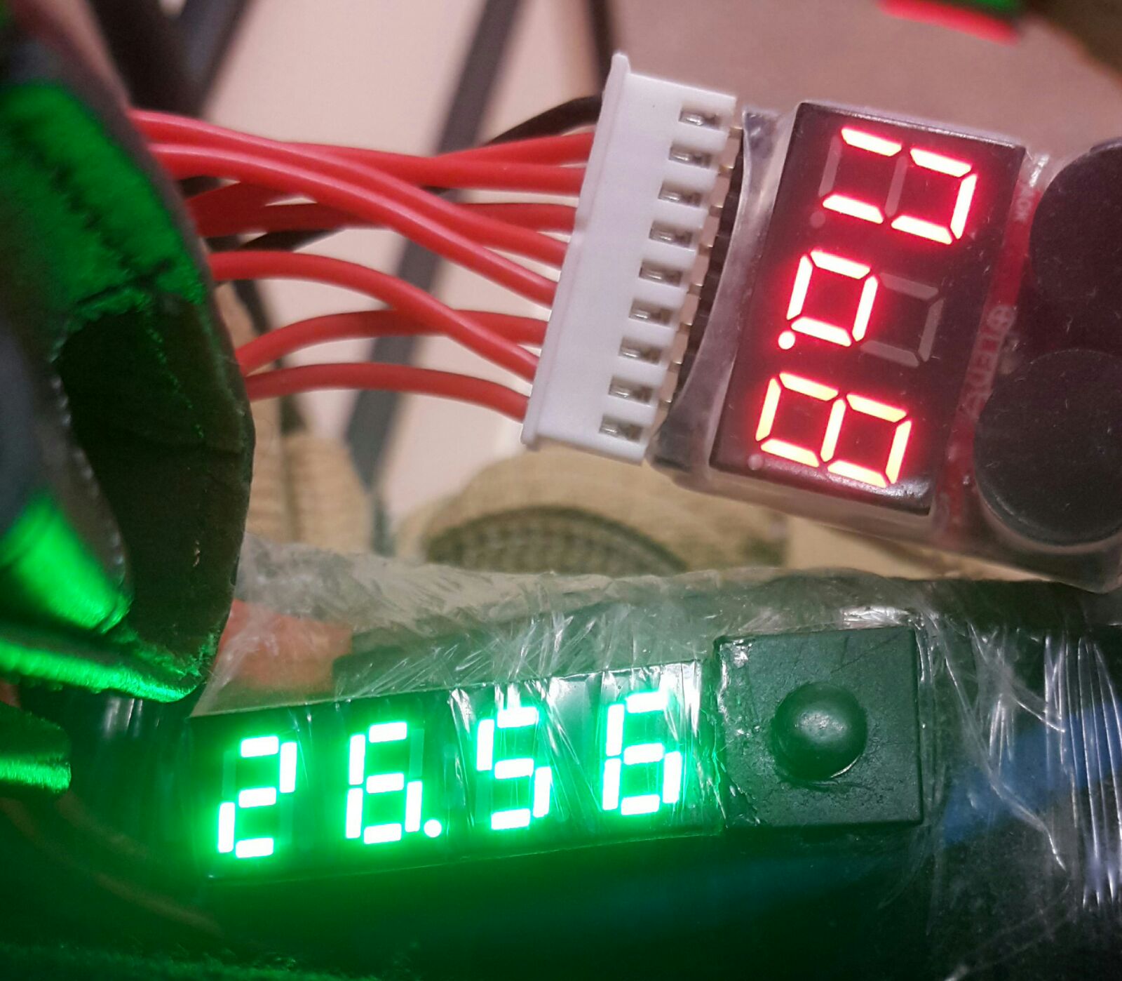

When you fit a lithium battery in the way that I do and that many others here do, you dont need a battery gauge. Because you get so much range (typically 3x that of lead, or the same as 6x lead grp 24 batteries) that you are exhausted first. Unless you specifically get up early as expresso has done, and spend a full day driving to see how far you can actually get. After a real 40 miles or so you will have had enough! In any case, with various different controllers, like dynamic for eg, you can configure the gauge via software so that it reads lithium more accurately. If you cant, or dont, then you still wont do any damage as long as you stop soon after you begin losing lights.
Or use an external $3 plug in gauge. In any case I charge once every 3 days in winter, or fully if I plan on a long day outdoors and never got close to fully discharging a battery no matter how hard I tried. The charger I use counts Ah back in as you charge. So you can tell how much you have used.

BCrip71 wrote:Besides knowing your chair, is there anyway to deal with no battery gauge with lithiums?
A decent voltmetre .
Do a deep discharge , and jot down the total volt that the first cell hits 3.00V . YOU should avoid going beyond that voltage during daily use .
By rule of thumb , you will learn the SOD of your batt gradually .
