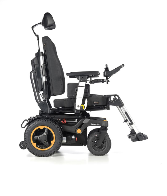

Q700R with centre powr footrest and all the power options. 6 pages of it but shows whats wrong with it and how I sorted it. I bought a eBay one, new, but 3 months old! Unused. It has the wrong "legs" so I got them to fit a centre footplate in the deal. And I then made a few simple minor changes to suit me. You wont have to. Just dont get the curb climber! viewtopic.php?f=2&t=10062
Awful footrests

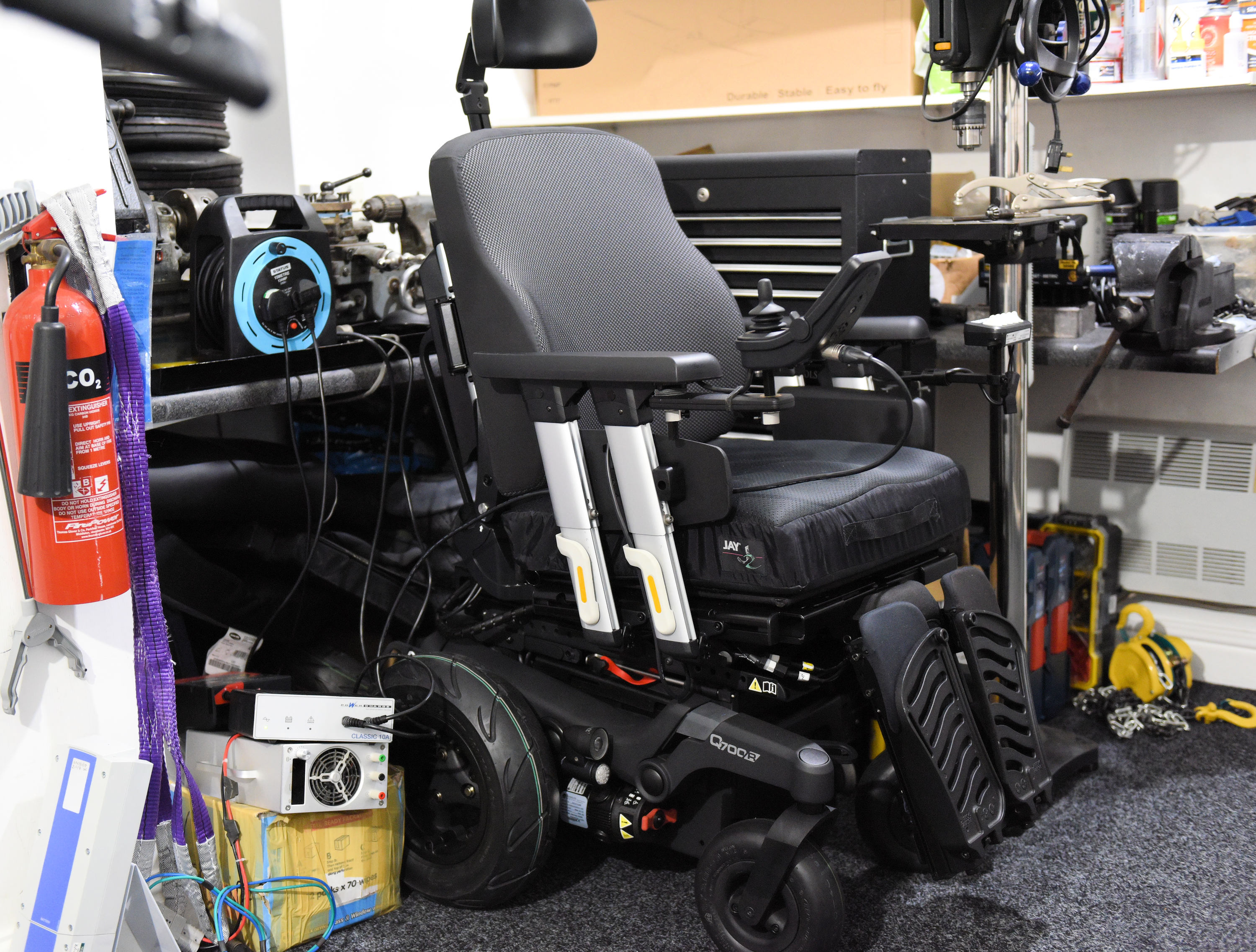

Mine. Seat moved back and strengthened armrests, and centre pootplate option. Pogrammed so it steers. Makes a way better chair. You wont need the arm mod.

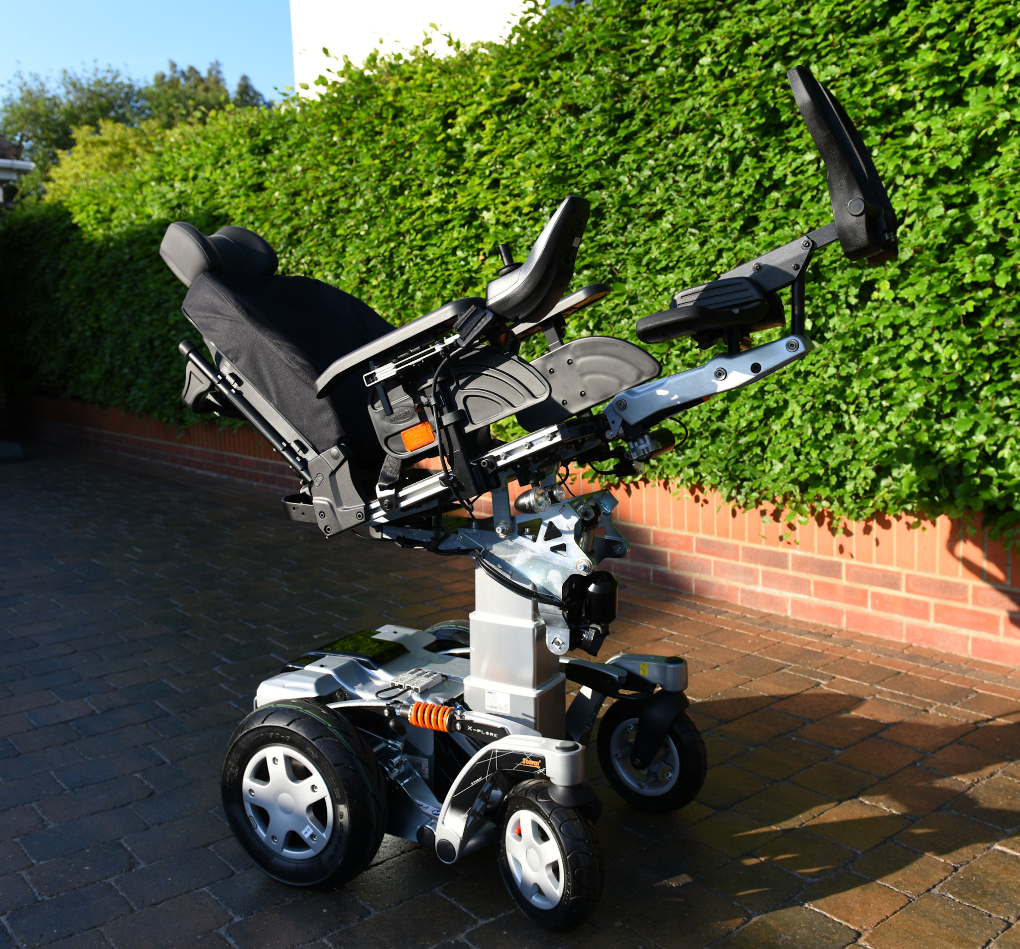

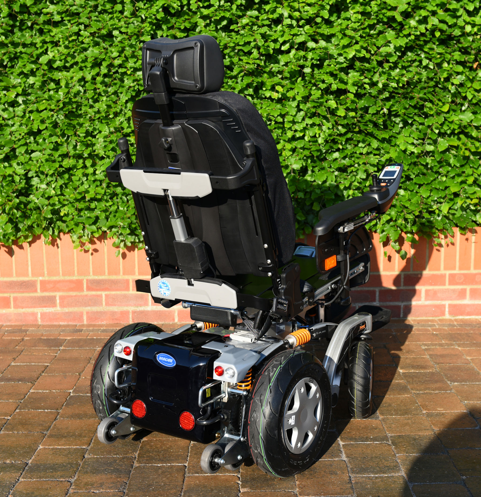

Postby Burgerman » 09 Feb 2021, 02:34
Another is the new version or the Invacare Storm 3 explore. They got rid of the problematic torqueless brushless motors. And use good 4 poles and that awful LiNX controller... But at least there is a OEM programming option we can use to fix it now. At a price. https://www.invacare.co.uk/power-wheelc ... wheelchair
But again, its a 190KG chair with all the best options. I actually ordered and tested one. I sent it back because the brushless motors were useless. I ordered with an essential centre footplate so I could move the seat back to get a sensible CG. Then it works OK. Other than those terrible motors. Now fixed!
