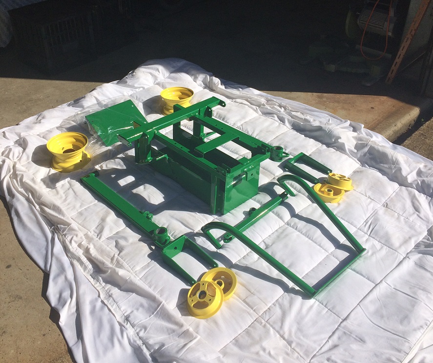

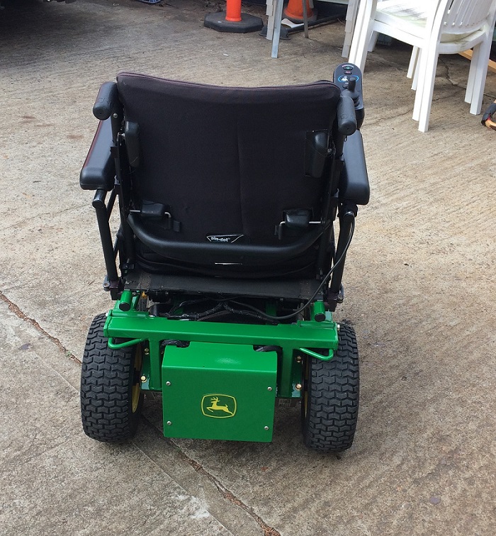

Postby charlie ford » 14 Sep 2019, 07:03

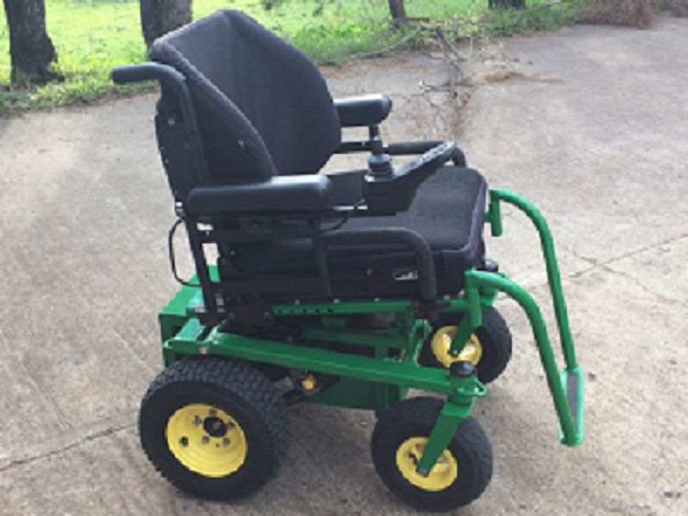

home made john deere chair
10kph
13x5x6 rear tyres
3x3x4 front tyres
120 rnet
2x 60a/h bat
quickie seat
100mm oscillation

thanks ,inspired by this site,wanted something unique and useful/capable.
sorry mechanic not farmer.

Postby martin007 » 14 Oct 2019, 22:52
What is the total weight of the powerchair?
What motors used?
Posts: 4100
Re: john deere project
Postby charlie ford » 15 Oct 2019, 07:00
do not know weight of chair,i think similar to salsa/f55 without tilt.
from memory pride/electrocraft 4 pole 220rpm motor assy

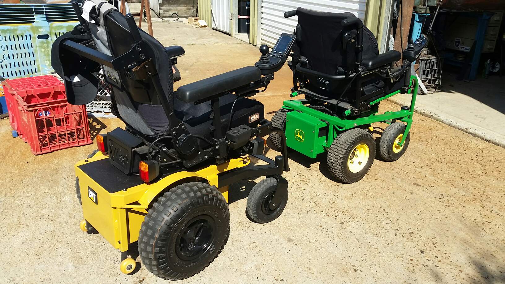

Postby charlie ford » 19 Sep 2021, 11:44
john deere and cat chairs

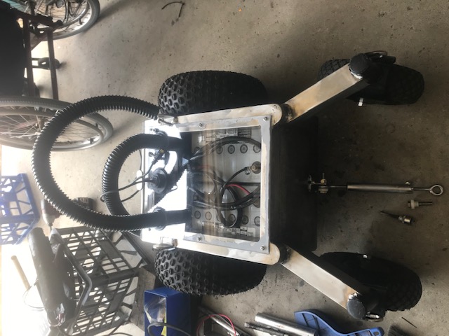

working on a stainless steel one at the moment.
trying for weather proof/light weight/robust.

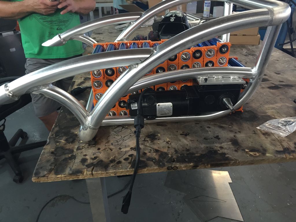

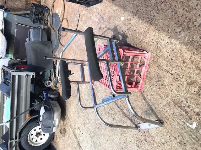

Postby charlie ford » 11 Jan 2022, 10:13

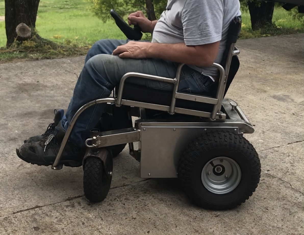

Stainless steel chair so far. Currently in testing stage.

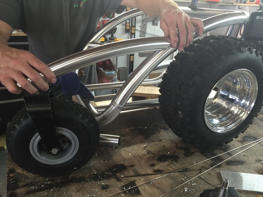

Postby charlie ford » 06 Feb 2022, 12:45
finance -is pension,rich is perception?
10 years of collecting 2nd hand chairs/parts,at the right time/price.
time with the drill,welder,grinder and shed also help.
stainless chair material all came from scrap shop,e.g.
note the marine boarding ladder made into armrest assy,canopy bow made into footrest,etc.
ebay ,for wheels,bearing and bolt shop visited a few times.second hand batteries.
back to the chair ,it goes well in soft sand and have not yet been able to test in water,
it should be good for 2ft deep,as long as we have no leaks.

Postby Snowy » 07 Feb 2022, 06:23
I like the monocoque construction method used by yourself and william clark.
Can you indicate the make and model of motor gearbox used on this chair?
Snowy
Posts: 12
Joined: 15 May 2019, 06:15
Postby charlie ford » 08 Feb 2022, 11:36
the motor/gearbox assy are out of a mwd magic mobility chair.
rwd,mwd,fwd motor are the same just mounted opposite sides to suit output offset.chair layout.
10kph, cylinder shape assy,seem to have good torque.
