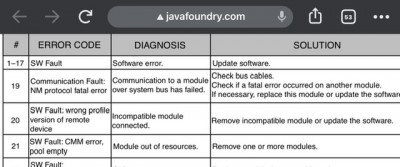

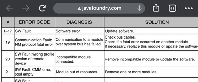

woodygb wrote:https://www.pridemobility.com/pdf/owners_manuals/operation_instructions/fault_list-q-logic-3.pdf
Code 20
The error code seems to indicate a bad connection or defective batteries.
Edit ...Whoops! ...Wrong Q-Logic .
This seems to be the error .
http://javafoundry.com/home/Q-Logic_Tec ... Manual.pdf
20 SW Fault: Wrong profile version of remote device
Incompatible module connected.
Remove incompatible module or update the software.
