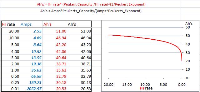

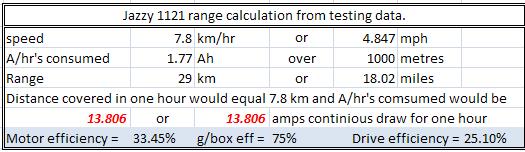

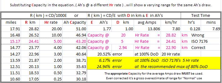

Postby woodygb » 17 Feb 2012, 15:04
Sam,
This may not be exactly what you want ..but it may help.
Motor and gearbox efficiency is my guesstimate/calculation.
note:- Testing station has erroneusly used an old range formula using the 20 hr rate and assuming 100% discharge.
The attachment TEST1.jpg is no longer available

Postby SamTexas » 17 Feb 2012, 17:54
Thank you woodygb (Woody in Great Britain?). That's exactly the information I'm looking for.
13.81A at 4.85mph. At 24V nominal that would be 331Wh energy consumed in one hour. So
68.3Wh/mile at 4.85mph. Almost exactly what I measured on my "3G Storm Series - Torque SP RWD", 70Wh/mile at 5.0mph.

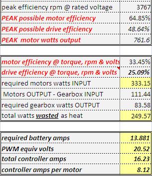

Postby woodygb » 18 Feb 2012, 01:36
Not surprised....
I modelled the Jazzy as best I could @ the test speed and mass .. and came up with this.

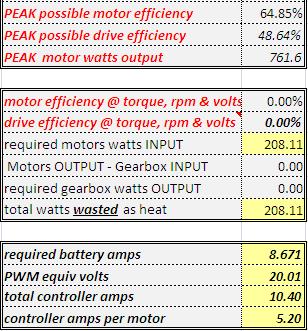

Re: Most energy efficient powerchair?
Postby woodygb » 18 Feb 2012, 01:55
OK ...Here's the same spreadsheet results with zero mass on the drive wheels.
208 Watts consumed @ 4.8 mph or 3722 rpm....
FLAT out ...the most inefficient rpm ...the watts loss rises to 247.17.

Postby woodygb » 18 Feb 2012, 02:15
What you have measured is the No Load current ... ( motor+gearbox amps pull with no load ) of around 5 amps per drive side....which is fairly standard.
10amps* 24 volts = 240 watts

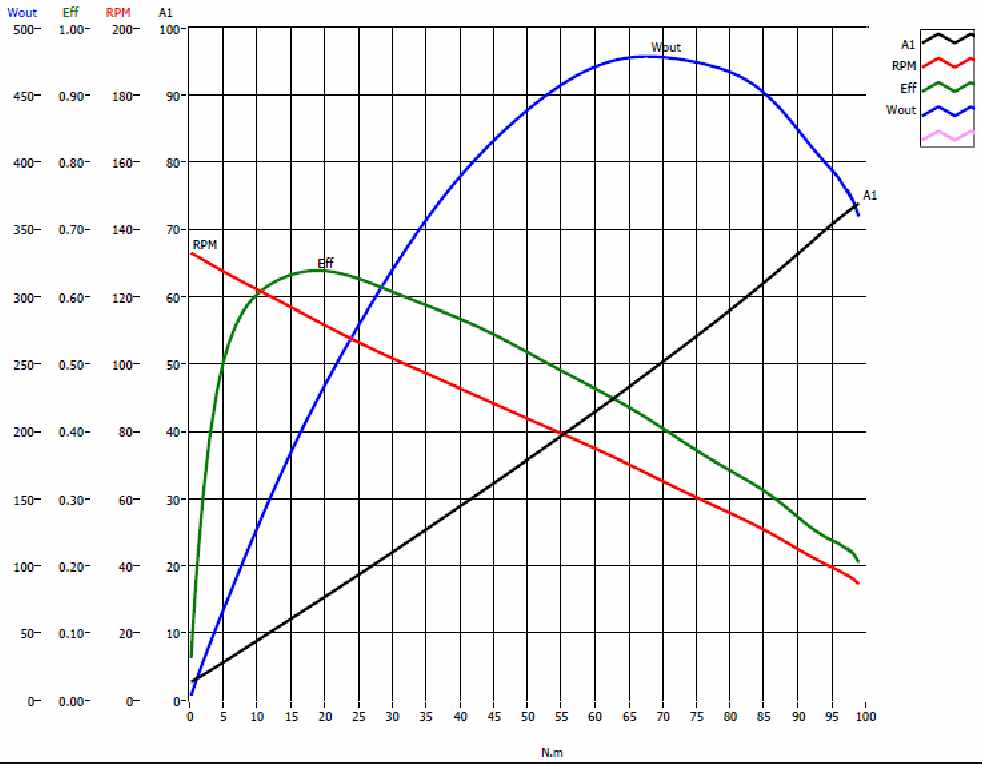

Just to add some data, here are the curves for Rachi's in-line motors.
MicroMotor PMNSt110_30_24V.jpg (71.29 KiB) Viewed 7601 times
Note that these are essentially 5MPH (with 14" wheels) so have the peak efficiency band in the 100 to 120 RPM range where efficiency is >60%. Continuous mechanical output is rated at 300W, and the motor will stay at or below that above 105 RPM, so in "cruise" it actually runs pretty cool. This has an in-line concentric 18.7:1 gearcase, but the mfr doesn't reveal whether this is planetary+planetary or planetary+spur or spur+spur, though from the physical layouts of this and the 500W model I suspect that it is planetary+planetary on the 300W and planetary+spur on the 500W (for which I've not seen curves). Note also that this is a rather low RPM motor (ca. 2200 RPM) paired with a fairly modest gear ratio, which accounts for the fairly broad efficiency curve. One could probably gain a few percent peak efficiency, at the cost of a faster fall off away from peak, with a higher RPM motor and higher gear ratio; life is full of compromises.
