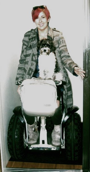

This was my last ride. I am sad to see it go as I have been using a version of the segway for the past 13 years. I am now considering the quickie S636 and I was wondering if you all have any recommendations for the specs (from manufacturer or after market) if I want it to be a burly street machine. Thanks again.
