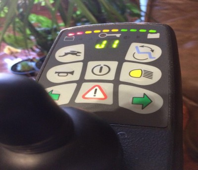

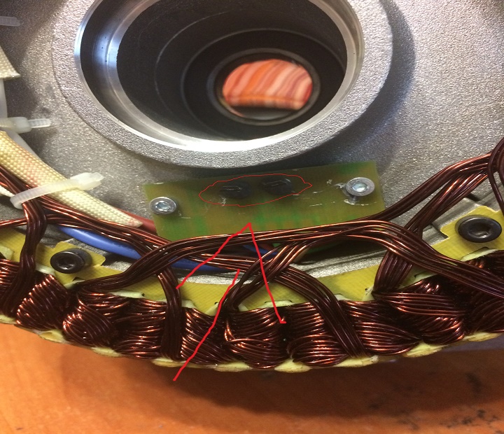

I have a Invacare Typhoon 2, and i read much on te internet and i don't found anything to help me, and i think is the sensor HALL from motor LEFT, when i open the chair is work to go back and ahead its works but when i want to go right is locked and left the same problem, and blink 3 flashes and i read on the manual is the motor LEFT, the brake is sound good and i feel when i drive ahead or back, and i think is the HALL sensor, but i think the power module defect the sensor from the motor, anyone can help me? please? Look to image! please :( :? the error from joystick is like a "J" and in the manual is not founding. i never see this error

If it drives forwards, and backwards ok, normal behavior, then there is no motor fault.
If the problem is only when turning, then the joystick or controller has a fault.

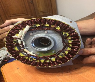

i try in more ways, i check both motors, and joystick and the controler with multi-meter check cable one by one, everythings is good, i check the sensor. if i have a DX-HHP programmer or OEM Wizard program, of God... no one want to help me

I also work on this type of motors, its very unlikely that there is anything internal at fault...unless you have had it in a lot of water or damaged it some other way.
What is more likely is that there is some surface build up on the connectors on your motor to controller wires.
Try connecting and disconnecting several times till the metal surface of the connectors looks a bit cleaner, clean with cotton tips and alcohol cleaner if you have any.
