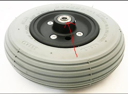

Postby martin007 » 12 Jan 2018, 01:47
I am looking for a spare bearing.
I have looked on ebay, but I do not know how to do the search.
P.D. I do not want to change the whole wheel.

Postby Burgerman » 12 Jan 2018, 03:14
Measure inside diameter. Measure outside diameter.
If its say 24 x 12mm then search for stainless sealed bearing. Pick correct size.

Postby ex-Gooserider » 16 Jan 2018, 01:30
Alternatively, if you look on the bearing sides - you may need to use a glass, or play with lights, there should be a set of numbers and letters on it. You may find it easier to read on the side of the bearing that faces into the wheel and isn't as exposed to the weather and abuse that messes up the numbers on the outside...
Any decent bearing supplier will be able to translate those numbers into the size - this is preferable to using measurements as it can be easy to get the measurements wrong, especially as some of the imperial and metric sizes can be very close... If you must do measurements use a caliper or micrometer, not just a ruler...
Also in addition to the size, you need to look at the seal on the bearings - you definitely want a sealed bearing as that will do at least some good at keeping the crap out of it... There are two main styles of seals you will commonly see - rubber and metal. Rubber is a little better in terms of waterproofing, but the metal shields will work (it looks like the bearing in your photo is metal shield)

Postby rover220 » 16 Jan 2018, 07:28
Axle bolt is M8 assuming that wheel is from a salsa m

Postby flagman1776 » 21 Mar 2018, 15:38
When I enlarged the illustration, the bearing shown is metal shielded with is inferior to rubber sealed for this application. The others are quite correct, stainless steel rubber sealed ball bearings are what you want.
I just did a similiar wheel (front wheel on my folding TravelScoot). I found a metal tube between the bearings inside the wheel... the metal tube is the same ID as the bearing so you can't push the bearing out "as is". This was my first one so I fully disassembled the wheel... only realizing afterward, I didn't need to.
Had I just loosened the wheel halves enough that I could move the center tube off center, I'd have been able to use a tool to push the first bearing out pushing through the opposite bearing.
The used bearing came out easily. I replaced the opposite bearing with strong hand pressure, reinstalled the center tube, pushed the second bearing. I put a dummy axle in place & retightened the wheel halves.
It was intimidating to start but was much easier than I expected. Good thing because I have 2 more wheels on this Travel Scoot & my spare TS to do after.
