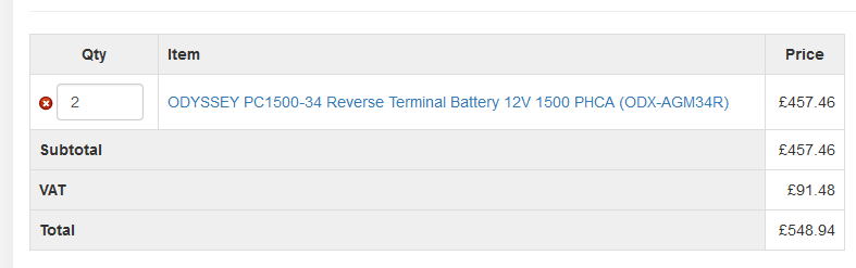

no I want to replace these , so I'm going to purchase these. Yes?

Why reverse termnal?
Will these have the DT so side terminals? Will that hit your chairs battery box sides? I cant see it.
I use the DT ones and CUT OFF the side terminals or order the PC1500 M as it does not have these side terminals.
Plus you would be better with the GEL battery that I fitted to the backup chair by Haze.
Unless your programming is set to wheelie like crazy, and jump to command. In which case go for the Odyssey. The HAZE gel battery will give a little better range, and with most peoles programming work just the same. It will last longer if charged correctly too.

But I can find the DT model with the terminals on the side which you say I can chop off. When I chop them off what do I cover the leftover exposed terminal area with?

Nothing. Its a thin bit of brass. Plastic covered. Just search PC 1700 MARINE. Unless like me you want to charge at 50 Amps, or get every last ounce of torque out of it with very severe programming than the gel battery I linked to is a better longer range, longer lifespan choice.
Or I think there may be a grp 24 bigger Ah version of the odyssey now?

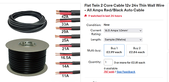

Postby Burgerman » 26 Oct 2022, 11:54
No. But its easy to use some 2 core 1mm cables. But you will need to solder.

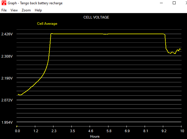

this can't be right can it? Using the "Lead AGM Odyssey 12 Volt 40A" preset.
Tango back battery recharge.CP8
(161.11 KiB) Downloaded 334 times

Postby wheelchairer » 28 Oct 2022, 11:35
it was that "fishing hook" on the end of the charge that made me suspicious that the charge had gone on for too long?

Postby Burgerman » 28 Oct 2022, 12:05
No thats correct. I stopped the CV charge when its gets to a low current, and changed to a CC low level end for a short period to prevent sulfation.

Postby Burgerman » 29 Oct 2022, 19:12
The reason is simple.
If you were to charge an odyssey battery and do it the safest way possible, so as to not shorten its life that you would choose 14.7V and you would charge it at 40A. You would continue this for 8 hours (max) or to 1000th of its capacity at the 20h rate. So thats whichever occurs first. That 1000th of its C is 68mA on the PC1500 one.
So your algo would be max amps until it reaches CV voltage of 14.7 (at 20C). Then hold it at 14.7 volts for 8 hours. Unless it first sees 1000th C or 68mA. (thats 0.068A).
But this gives us a couple of problems. It presumes the battery is say 40 to 80% discharged.
If its more than that then 8 hours would not be QUITE enough. If its less, then it shouldnt be an issue as it will terminate at that 200mA termination setting. Maybe after 5 hours or so. But different batteries vary. Some never get down to that low 67mA. Even some new ones... And esp if they have been subjected to a bad charger previously and are a little sulphated.
So instead of 68mA we can set 200mA. That is a figure most batteries will reach. In around 8 hours. If set to 68mA it may not fall far enough and so then the charger would say charge ended due to time limit. But its not full yet. With AGM we MUST put back a little more than we take out every charge. Or they will sulphate. So in this case an extra hour at a small fixed current. This ensures that a) it charges at the high 14.7 volts for no longer than 8 hours although it can be less. If it reached that 200mA point. But then it recieves a little extra without the high voltage at a fixed low current and so at a lower non gassing voltage. It means it will take around a couple of hours CC, 8 hours CV, and 1 hour at very low current where the volts will initially fall, and begin to rise when the battery is charged fully. It is just compensating for the fact that it never dropped to 68mA.
Theres another reason to choose a higher figure than the 69mA one. That being that the chair has a small drain current even when off. So may prevent the battery reaching this point. So the charge algo is a compromise. Also the voltage is a little less than 14.7 (29.4) too. Because the battery is typically a few degrees warmer than your room. If its summer, warmer than 25C this should be dropped to 14.4 (28.8) max.

Postby Burgerman » 29 Oct 2022, 19:19
After seeing the graph, you could reduce the TERMINATION/CURRENT by 30mA and test again on a similar recharge. To some benefit. It will add about an hour to the CV time hopefully.

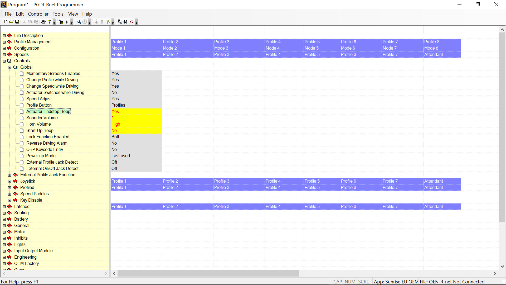

Postby Burgerman » 02 Dec 2022, 03:14
More specifically those in yellow :
Posts: 71082

Postby wheelchairer » 02 Dec 2022, 11:25
Doesn't it have a facility on this setup where the wheelchair will turn itself off after a set period of time, I can't find that so far. I did try a search for "off".
BTW I put the sounder volume to 0, and it switched it off altogether. :dance cheers
When does the actuator endstop beep? (I did had mine set to no, but have copied your suggestion now).

Postby Burgerman » 02 Dec 2022, 13:36
When it senses rapid current rise when it turns off automatically. Not if microswitch endstop.
Yes it can be made to sleep after x time. Look at sleep and standby in the CONTROLS section, no idea what does what here never tried it.

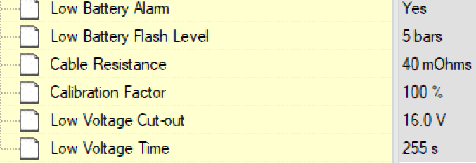

Postby wheelchairer » 04 Dec 2022, 10:42
And can I adjust any of these settings so it will let me know when the battery is is getting low earlier?

Postby Burgerman » 04 Dec 2022, 11:05
With lithium?
You can play with the calibration factor. It will never be accurate whatever you do. Its expecting the curve, and the amount of voltage change due to surface charge and peukert and internal resistance to be that of a lead battery. None of which happens with lithium. So it will read high and low all at once most of the time regardless...
