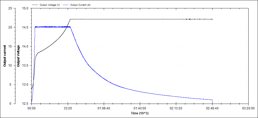

Postby Burgerman » 25 May 2012, 09:50
>>> for now i will use this one and see how it much distance it gives me
All the chargers will give the same distance. At least with new batteries.
The difference is in the last 1 Ah. That makes so little difference to range that its never noticible and must be in your head!
But that last bit DOES matter. Unfortunately, that last bit may take anything from 3 extra hours to 6 or 8 extra hours with older/gel batteries.
Knowing this, and with slow low powered chargers, the manufacturer cannot give you a green light when really full, because everyone would say charging takes too long. So they choose an earlier point, based on time, and current. Usually 100th of the capacity in amps, and/or 5 hours. The battery is 99 percent "done" here.
The last 1 percent is very beneficial, because it returns the lead sulphate crystals back to the acid before they harden on the plates and become permenant - which means you replace them much sooner. Some chargers continue to charge after the green. Some do not. Some drop to a safe lower (float) voltage, some stay at the higher voltage, which isnt good if left too long.
Without using a volt meter to see what is happening its almost impossible to say what any charger will do. Unless you have a full specification in detail.
Either way gel batteries are slower to charge, and slower still as they age. Batteries are not simple, at least if you care about them!
The best way to have good range, and make the batteries last longer before they deteriorate is to plug them in as often as you get chance during the day, and do a full charge every night. Better still to use a faster charger and a better connection via the anderson connectors shown here:

Postby Burgerman » 25 May 2012, 10:28
Heres an actual graph, of what is SUPPOSED to happen, and does happen, provided by my hyperion charger on a quick top up during the day as I sat at my PC.
These are Odyssey batteries. So Charge rate = 20 Amps, in parallel, at 14.7v. Cut off point was at 100th C.
Note how it charges at 20 amps at first, but once the batteries voltage rises this starts to fall away. Until its charging at a very slow rate, while still sat at 14.7v. Then it cuts off. This is the first 2 stages. Theres a third, not shown, that holds the batteries indefinitely at 13.6v for topping off that 1 percent, and long term health.

Postby Burgerman » 25 May 2012, 16:29
One of your existing chargers may be fine. As I said the only way to know is to compare what it does, with what you need it to do...
First are your batteries MK gel? If so you want up to 1o amps (no more through trhe charge port). And CV level of 14.1 (actually 2x so 28.2v). It wants to cut off at around .5 to .7 of an amp. Then it needs to go to float at 13.5 to 13.8v (x2) for those batteries.
As usual knowledge is power. Lack of knowledge means you need to rely on a dumbed down manufacturers charger and you or I dont know if its correct.
For EG most chargers charge at 14.4v. Slightly too high for long service life on gel batteries. They do this because it charges considerably faster, so that the weedy charger can have half a chance of a full charge by morning... And most cut off too early, so battery not fully charged. This also shortens service life. But it means happy user... Until he has to buy new batteries. These are all compromises.
I use the hyperion because all this is adjustable. helped and advised on the charge algo, and settings for it 4 years ago. So I can CHOOSE whats best for each battery, to store, or to fast charge, or to use a higher voltage if in a hurry, etc. But again this means battery knowledge is needed.
No I dont know of any chargers that will give the correct gel charge algo, without measuring and watching what they do.
Theres plenty for AGM batteries. Gel are more fussy, and charge slower, and are more easily damaged by even a small over voltage.

Postby Burgerman » 25 May 2012, 18:33
The problem with MK gel batteries is that on a hi end chair with 4 pole motors and a 100 amp controller thats programmed to respond fast, they cant really cope properly even when new and fully charged. You notice a lack of torque. What happens is that because they are about 4.5mOhm resistance, and have a large Peukert (surface charge) effect, and because lead based batteries always have a big voltage "sag" under heavy load, the controller kind of shuts off a bit, to be sure it maintains enough volts to safely stay "on" and in control. So as the volts sag to say 18 volts under the load of say a steep long ramp, the power falls off curtesy of the control system. I notice this horribly on a BM2 chair on the steep ramp in my local pub with MK batteries.
And as they become discharged throughout the day, the resistance goes up lots more... And its higher still in less than new batteries to begin with. So they are at their best here when charged full, and in the first few months. After that, they get slowly weaker...
Range doesent suffer even when they are all but useless to me, and a light user on the flat would think they were fine, in a typically soggy delayed action powerchair would never know the difference.
They would think they are marvelous batteries and they do go on forever like this. I have a set here that are many years old, they are crap under load! I mean much more crap than when new. But will still let me do 4/5ths of the original range as long as I dont expect too much from them.
Odyssey batteries that I and others are using on this site have a shorter lifespan, theoretically, but are HALF the resistance. So twice as good under heavy load with half the voltage drop. And they charge at a higher rate right to the end point so take about half as long to charge with a big charger. This alone actually helps them live longer than the supposedly longer cycle life MKs.
