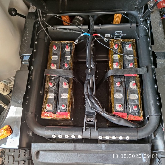

Postby terry2 » 28 Sep 2020, 15:26
Cells in :)
Re: Meyra optimus 2 a small review
Postby Burgerman » 28 Sep 2020, 23:26
All of them? As I mentioned on the other thread, seems that half the space is unused? Height and width?
Posts: 71087
Postby terry2 » 29 Sep 2020, 09:30
Burgerman wrote:All of them? As I mentioned on the other thread, seems that half the space is unused? Height and width?
In the middle are the controllers. Which stick out a bit.
The cells was in my puma 40s way before I bought the beast.
After the warranty is up.
I will move the controllers to the front length ways, and have a air scope to keep them cool.

In that myra you should be able to get 250Ah minimum, likely more. With huge service lifespan and range gains. Since its stock battes are grp27 or 31. And 100Ah+ lead.

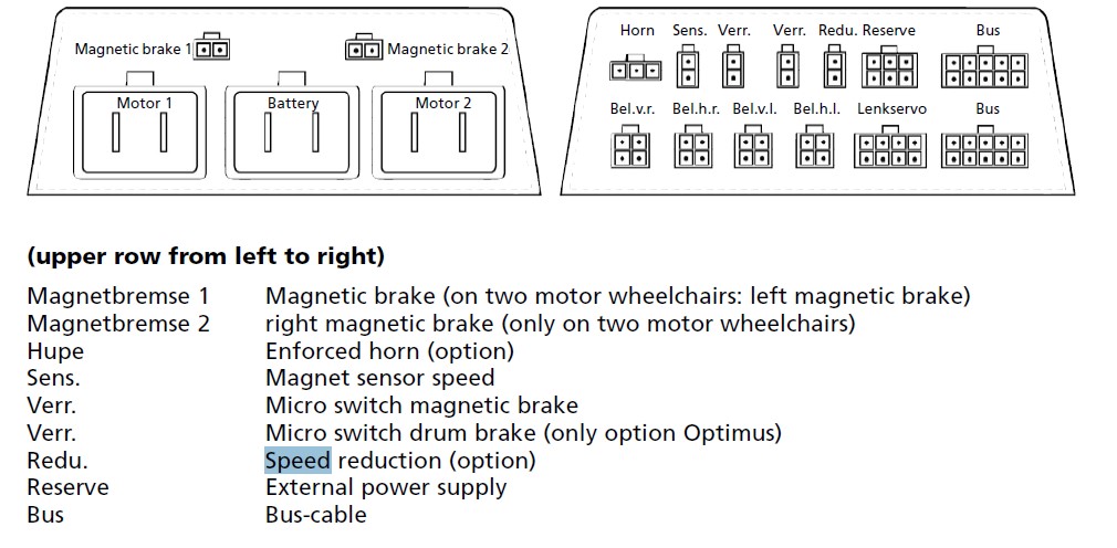

Postby rickystyx » 04 Nov 2020, 11:51
Terry in the maintenance manual it refers to the speed setting dongle as optional so I just wondered if you had tried unplugging that dongle to see what happens - in theory at least it should give you the full speed of the chair. I haven't got mine yet but I will try this when it arrives as I'm not paying for a bit of go faster wire

Postby rickystyx » 04 Nov 2020, 11:55
Connctions

Postby Burgerman » 04 Nov 2020, 11:57
If it just connects like a seating inhibit it may have various resistors to give different speed "bands". You can set all of those in programing to any speed from 0 to 100% or just disable the inhibit in programming. No need to unplug or try or test.
Added. Just saw pic.
That pic above isnt r-net... Its maybe myras own. So ignore the above.

Postby rickystyx » 04 Nov 2020, 12:30
They appear to have two modules (possibly in one housing but I'll find out when it arrives) the Rnet and an additional "adjustment module" that has the optional bit of wire but since it says it is optional it may well work at full speed by just unplugging the wire - I'll find out when it comes but i like to have ideas planned whist I await its delivery

Postby terry2 » 05 Nov 2020, 11:41
rickystyx wrote:They appear to have two modules (possibly in one housing but I'll find out when it arrives) the Rnet and an additional "adjustment module" that has the optional bit of wire but since it says it is optional it may well work at full speed by just unplugging the wire - I'll find out when it comes but i like to have ideas planned whist I await its delivery
If I take it out it goes back to 8 mph.

Postby rickystyx » 05 Nov 2020, 14:13
Hopefully I can override the speed reduction using the OEM software and a dealer dongle that I managed to get yesterday - if I can't figure it out I may ask you to check the resistance on your dongle Terry if that's OK? :0)

Postby rickystyx » 09 Nov 2020, 09:26
So I got my head around the bit of wire in the inhibit to control speed - it is in the R-net manual chapter 13 which explains the resistance values and how they set the speed - I am guessing that switching the drive inhibit to off will override the bit of wire as BM suggested.

Postby Burgerman » 09 Nov 2020, 10:56
Its here http://www.wheelchairdriver.com/program ... 981-14.pdf
I know. Thats why I said to disable the inhibit. You could also just change the speed in the band that the resistor is in. But its easier to disable all. I also suspect that terry2 may be taking his speed indication from the joystick. And that can read anything. It simpy shows the joystick position as forward speed. It is set or programmed to suit the actual speed of the chair. So you must set that to whatever your phones GPS says.
Although that may be differet as that is not a ISM module in your photo its a meyra part... But I suspect its the same working method.

Postby rickystyx » 09 Nov 2020, 11:43
Sorted
Changing the programming to Terrys gave me 8mph in mode 5 and disabling the inhibit gave me 9.5mph
I don't think there's much difference or that it is worth worrying about but more importantly for me it has changed the flashing light to a steady light so there's nothing else causing a warning light to flash and I like that :0)
