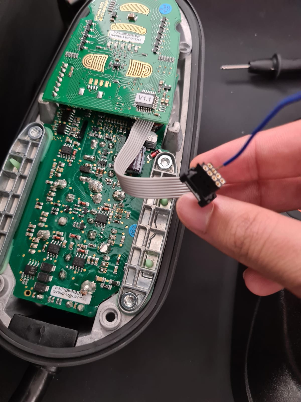

The controller can only be turnt on when the joystick cover is alligned probably with the PCB
.... ODD! I have not come across this problem with any of the various pod types.... BUT ...I have not had a NEW VSi in my possession.
download/file.php?id=15768&mode=view
Your pic seems to show a possible microswitch "tongue" in lime green in the left hand side casting rail.
