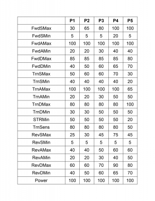

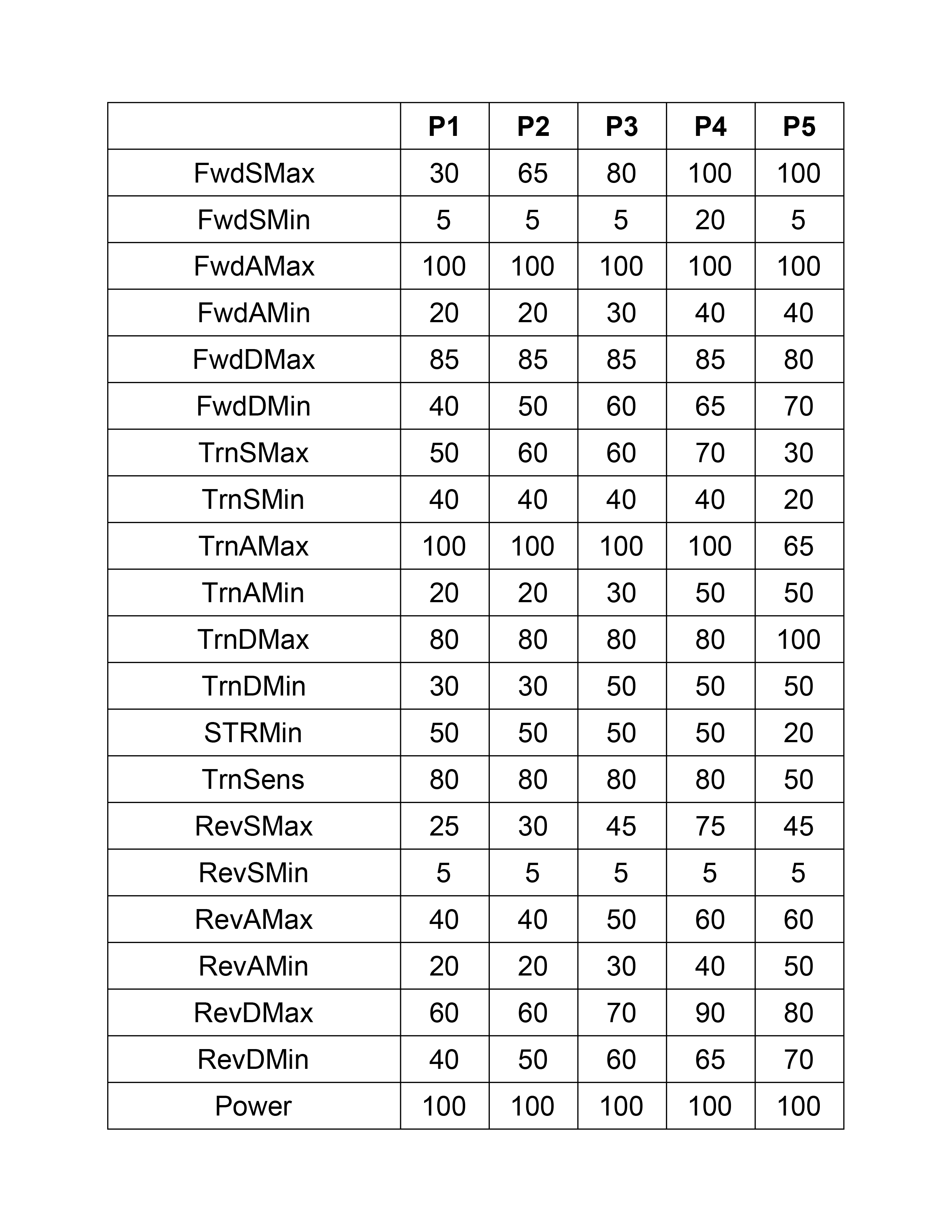

Not sure if this helps at all for the moment. You sound like you are comfortable with no restrictions as I am. Here is a list of the power settings of my Q6 Edge (first model). These settings worked well after I got them set to my liking. I have a handheld programmer as well. Older version (They had a second hand controller come out before the Q6-2. It is very faint to read but it works great (for my chair). Anyway, just wanted to show you what I had set until you can get your programmer in your hands. No more crushing knees into desk legs or holes in a wall because it didn't turn when you wanted, lol.

The min turn acc and turn dec are all set way too low for accurate control on that list above.
And its better to have all the turn decelerations set to as high as possible, and at least as high as turn acc settings.

Burgerman wrote:The min turn acc and turn dec are all set way too low for accurate control on that list above.
With it being center wheel drive, those settings made for smoother cornering leaving the turning "fine tuning" at the joystick giving me a range of control. For me at least, it gave me more control (at least in my mind). With both at max and if I wanted to simply turn 90 degrees to face someone it would jerk me to begin the turn and again to stop regardless of how far I moved the joystick?
Burgerman wrote:And its better to have all the turn decelerations set to as high as possible, and at least as high as turn acc settings.
Wouldn't this end up being an "all or nothing" setting? So, if maxed at 100% then you are full on and if you let up you are full stop?
Now that I have a new chair I may have to break the Q6 out of the garage and play with settings again. If nothing else but to see how difficult I had made it for myself. :dance

Postby Burgerman » 31 Dec 2017, 21:54
No. Setting all 4 turn accelerations and decelerations to 100 simply removes almost all of the time delay. So it responds when told rather than later on.
If its then too "sharp" for you, reduce turn speeds! The AMOUNT you turn, (the speed you turn), or stop turning depends on how far you move the joystick and:
Turn Speed. (full stick deflection) Typically 40.
Minimum Turn Speed. (small stick deflection or lowest speed setting) Typically 15.
So that the chair moves in an exact replication of what you do with the joystick. like a PC mouse. Instead of doing it some time afterwards... When you decide to stop turning left, so does the chair, instead of continuing to turn, for x amount of time before obeying you. True linear direct control.
If you want to turn slowly, move the stick slightly. If you want it to keep turning hold some turn it in! If you want to stop turning, centre the stick. In will obey in real time. Not some tme afterwards...
Imagine how difficult it would be to click your mouse on a button, if every time you move it it responds 5 seconds later. And then keeps moving for 5 seconds after you tried to stop it. THAT is what setting turn acc, dec, at high and low speed to say 30 is!!! That is exactly what less than 100 does.

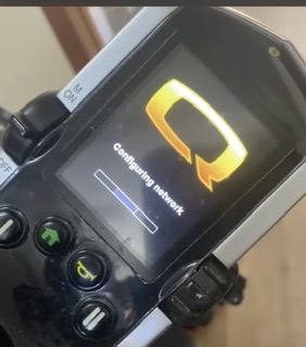

Good afternoon ! could someone guide me what might be happening, Quantum Q6 “CONFIGURING NETWORK” I didn't find this information in any manual I consulted!

Postby woodygb » 10 May 2022, 09:11
Q-logic 3e.
https://www.pridemobility.com/pdf/owner ... boi_om.pdf
Page 17
Item that indicates that the system modules are being configured. Shows animated
bar below.

good morning woody. Thank you for your help. now, it's indicating. “ Error Code 20 SW Fault: wrong profile version
of remote device” unfortunately the chair is not here with me yet, but it will be soon!! Is there any function, like reset? or restore ?

Postby woodygb » 11 May 2022, 10:17
https://www.pridemobility.com/pdf/owner ... ogic-3.pdf
The error code seems to indicate a bad connection or defective batteries.
Edit ...Whoops! ...Wrong Q-Logic .
This seems to be the error .
http://javafoundry.com/home/Q-Logic_Tec ... Manual.pdf
20 SW Fault: Wrong profile version of remote device
Incompatible module connected.
Remove incompatible module or update the software.

woodygb wrote:Q-logic 3e.
Page 17
bar below.
of remote device” unfortunately the chair is not here with me yet, but it will be soon!! Is there any function, like reset? or restoration ?
