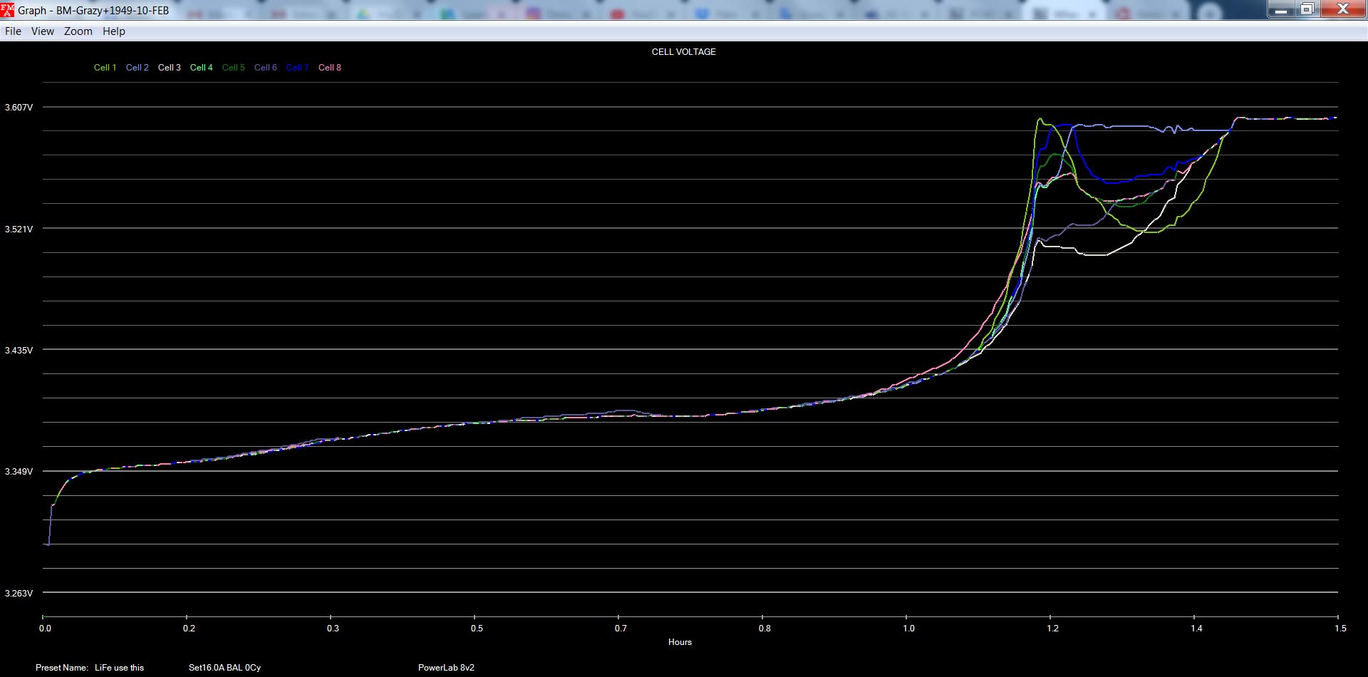

Postby Burgerman » 10 Feb 2019, 10:54
I suspect the pack is pretty unhealthy. But at least it is FINALLY getting charged correctly. It was unbalanced on this charge (that mess on the graph) and may have high resistance cells. And is still too small capacity to do what you are doing. So is getting tortured still.
You now must use a CELL MONITOR. Never allow any cell to go below 2.9V stationary, or 2.5V under load. This is really only needed because the pack is too small for the load. And likely not very healthy so will have high volt drop under load. The cell log will plug into the 9 wires that go to each cell.
Also, you can now REDUCE the termination current, in your preset by 30 to 35%. Cant remember what I set it to, but it was a "safe" figure. Charge is ending very soon. Its not essential.
Also, from experience, looking at that graph, your pack is now about 38 to 40Ah. If it was 50Ah or more before, its probably not now...

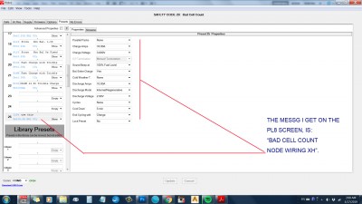

Hi Guys,
I am pleased to report that the removal of the BMS from my 45 Ah LIFE pack, has been a great success. By using a Cellpro PL8v2, I am getting more power into the pack and this is clearly noticeable on the steep hills I climb.
I have ordered 16 pieces 3.2v 120 Ah cells from China and will provisionally run my all terrain rover, configured as, 24v 240Ah. Eventually when I find a suitable trans axle with a 48V BLDC motor, I plan to reconfigure the pack.
However : right at the moment, I can't get the PL8V2 to charge the pack. I am using a preset that BM developed and sent to me, which has been excellent.
The problem started when I tried to initiate a charge cyl. and I got this error message on the PL8
"Bad Cell Count, Node Wiring XH"
Please note that the current charge level of the pack is 25.4v
I checked the voltages, continuity and ordering of the 9 balance wires and I found that the small 22 AWG negative was open circuit, so I stripped the pack down and soldered it back in place.
This evening , I have checked the individual voltages of the balance wires and they are all correct, however the error message persists and I cannot charge my pack.
I would really appreciate any help, suggestions and advice that you guys can give me , to get things working again.

Re: Removing BMS & wiring in Pl8v2
Postby Burgerman » 17 Mar 2019, 05:36
First tick the ADVANCED box!
2nd, check that there is 0V and correct full pack Volts on the + Banana plugs and that you plugged them in.
Three things cause that.
1. Missing or no connection balance wire. Was it soldered or crimped? Are any connectors crimped? The one that came off? If that wire touched a low or high voltage part of the pack you may have damaged the PL8 but that takes a lot of doing normally so dont panic.
2. You forgot to connect the PL8 Banana connectors or they have no connection to the pack.
3. You unticked the "use bananas" tick box on the screen that you see just after clicking start.
Or you didnt reset the charger. You are using the PC right? Or you changed a setting, use the wrong preset or something. Turn off FUEL. Set to NO.
Posts: 70429

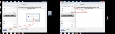

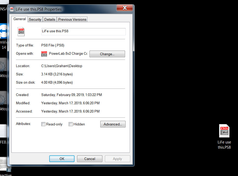

Postby grazy+1949 » 18 Mar 2019, 12:59
Hi
The excess heat occurred at the pos outlet from the PS. The PS currently powers up and shows 24.5v
The PL8 powers up and the SW opens on the PC, but even with PS and PL8 powered up. The software will not import the preset file BM sent. [NB: the file has the correct icon and file extension]
When it experienced the failed charge cyl. it deleted the preset from the PL8.
I have the preset file from BM called "Use this one.PS8". How do I get the SW to import it (Last time I did it . I imported it with the complete system powered up.) I imported it into preset slot 25. It would not import into slot Nº 1.
I am now going to study the PL8 .PDF to look for info on CRS errors and perhaps how to format the the PL8 presets.
Any ideas please?
Postby Burgerman » 18 Mar 2019, 13:09
Non because I dont really see what you do or know what you are doing wrong.
This also baffles me.
Frankly thats all but impossible. So maybe you were seeing it on the CCS software and it wasnt on the PL8.
Does that USE THIS preset appear on the PL8 screen at any time?
What possible other way could you do it? :problem: Please explain.
The preset can be imported into ANY slot. If you know how to drive the computer. I have no idea what you are doing wrong.
And if it will not load (upload to PL8) when you click update, then you either have the FUIM3 plugged in backwards, or a faulty USB cable, or a bad USB port or the wrong COMM port selected.
Or a faulty power supply.
