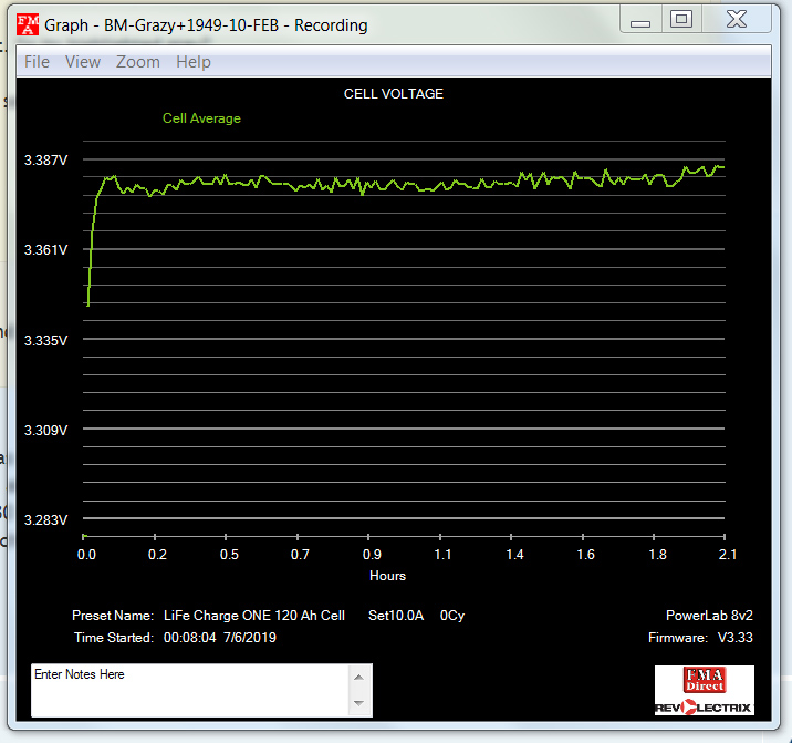

It has been running for <2 hrs, but the graph doesn't show that it discharged to 3.3v or that it has charged to 3.6v. Is this a valid preset? How long should this process take per cell?

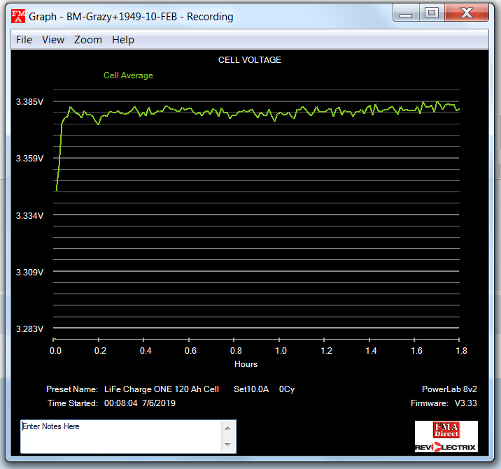

Graph after 2 hours:

Postby Burgerman » 06 Jul 2019, 01:45
I cant really tell what you are doing.
But you appear to be:
Charging ONE cell?
Which is 120Ah?
At only 10A??
Lets say it is 50 percent full. It may be only 10% full. At 10Amps that will take 6 to 7 hours...
Set it to 40A. That will take 2 hours.
Lipo is short for Lithium Polymer. WE dont want or use those. They explode, burn, and have very short cycle life.
We are using LiFe or LiFePO4 which is Lithium Ion Phosphate. Must longer service and calender life, and they dont explode or burn. And they charge at different voltages. Charge a LiFe cell that we use as a LiPo and you will ruin it.

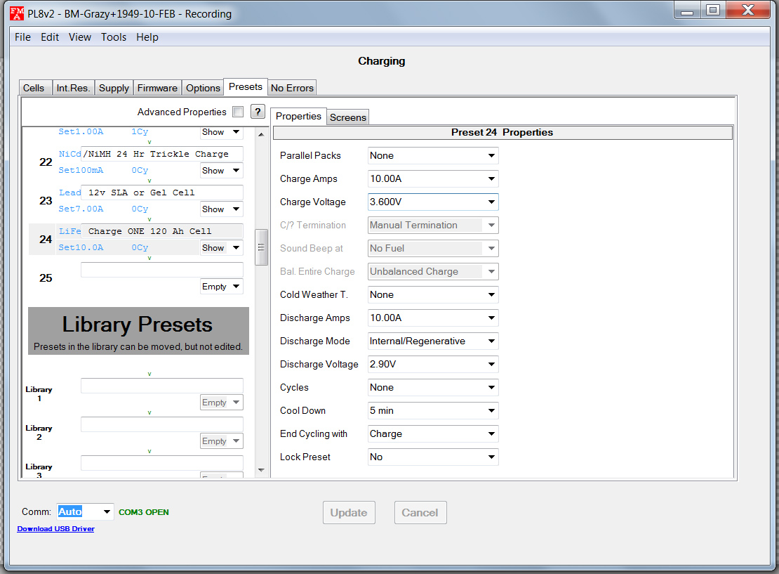

Postby Burgerman » 06 Jul 2019, 10:33
You are using one of my presets already?
If so, then change only the charge Amps to 40.
When starting the charge, choose DISCHARGE. It will discharge at a max of 10A. Down to 2.90V per cell, which is around 95% discharged. Why do you want to do that? So will take 12 hours.
What is this 3.3V thing all about? You cannot gain anything by discharging to a 3.3v figure. Why would you want to do that too?
Charge all full, and assemble the pack. Then charge as a pack to balance it.

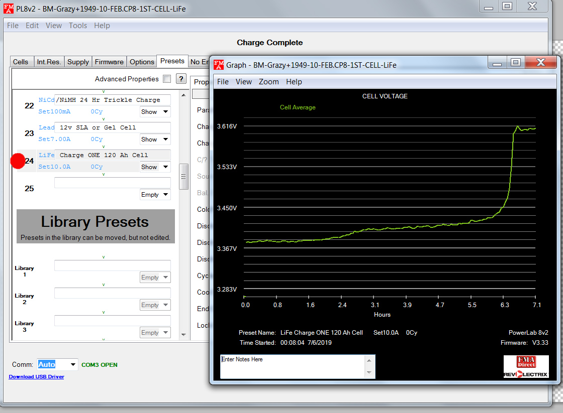

It reached 3.612v in 1.7h but the PL8 is still running after 2.2h. Can I alter the preset config to shorten the charge time to circa 2.0h?

Postby Burgerman » 06 Jul 2019, 11:41
No. That is now the cv stage. Charge will end when its fully charged.
You are not just charging TO some voltage. Providing you have the correct CV termination current set. And the cell is healthy.
TICK THE ADVANCED BOX.
GO TO EDIT,
Under the termination tab, what is the termination current set to (Manual A setting)? And what is the CV timeout set to?
CHOOSE 240mA
CHOOSE 4 hours.
Stop the charge, update the charger, restart the charge.
Posts: 71087
Re: Removing BMS & wiring in Pl8v2
Postby grazy+1949 » 06 Jul 2019, 14:45
I checked and your original values are still as you set them ie: CHOOSE 240mA
CHOOSE 4 hours.
:worship

Hi BM,
I charged #14 of #16 , 3.2v 120A cells. They all charged to 3.6v and all took between 2.2h and 2.4h to charge. The graph displayed correctly on my PC. When I reached cell #15
I got a message from the software "No data from PowerLab 8"

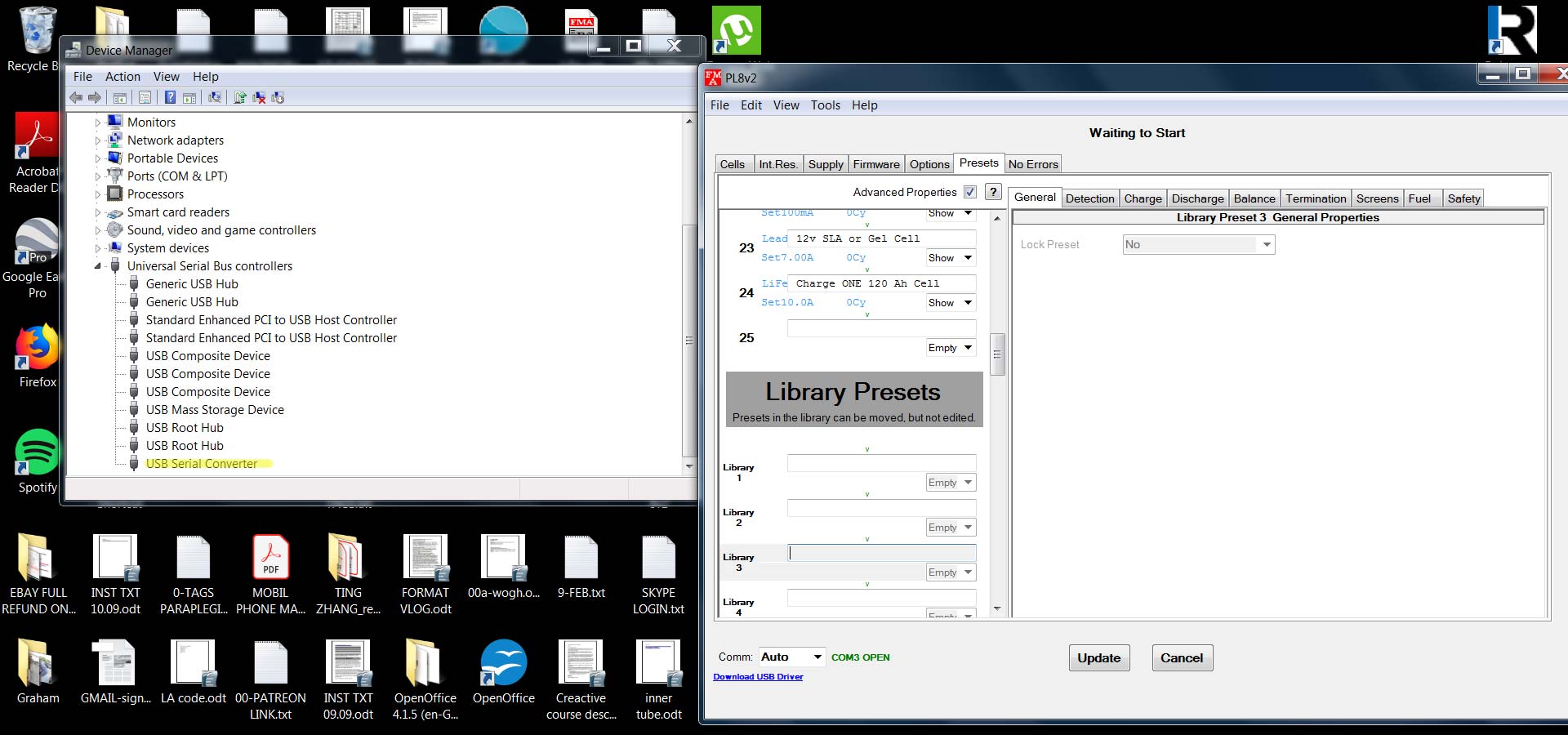

Whilst I was loading the Single Cell preset, the info displayed on the screen of the PL8 was correct and the charge initiated and the cell was charged correctly However I had no data shown on the graph.
The red light was illuminated on the USB cable connecting the PL8 to the PC as I was running thru the stages leading up to "charging 1S Confirm?" When I pushed Enter the red light went out and the cell charged without the Pl8 communicating any data to the PC.
NB: When I received the PL8 back from Indonesia, the 3 pin micro plug socket from the PL8 had 1 pin bent over which was not connected to the male plug and the PL8 wasn't communicating wit the PC. This was the original problem I'd had before I sent it for repair and they failed to find it and thus returned it to me in the same condition. My son straightened the bent pin and then he was able to install your preset. I am asking your advice before taking any action to repair the micro socket.
(I suspect that the pin that had to be straightened is now loose and I want to ask you , if it will be OK to remove the socket and by pass it?)
NB: I have tried plugging the lead into different USB sockets on the PC, but that does not fix the problem.

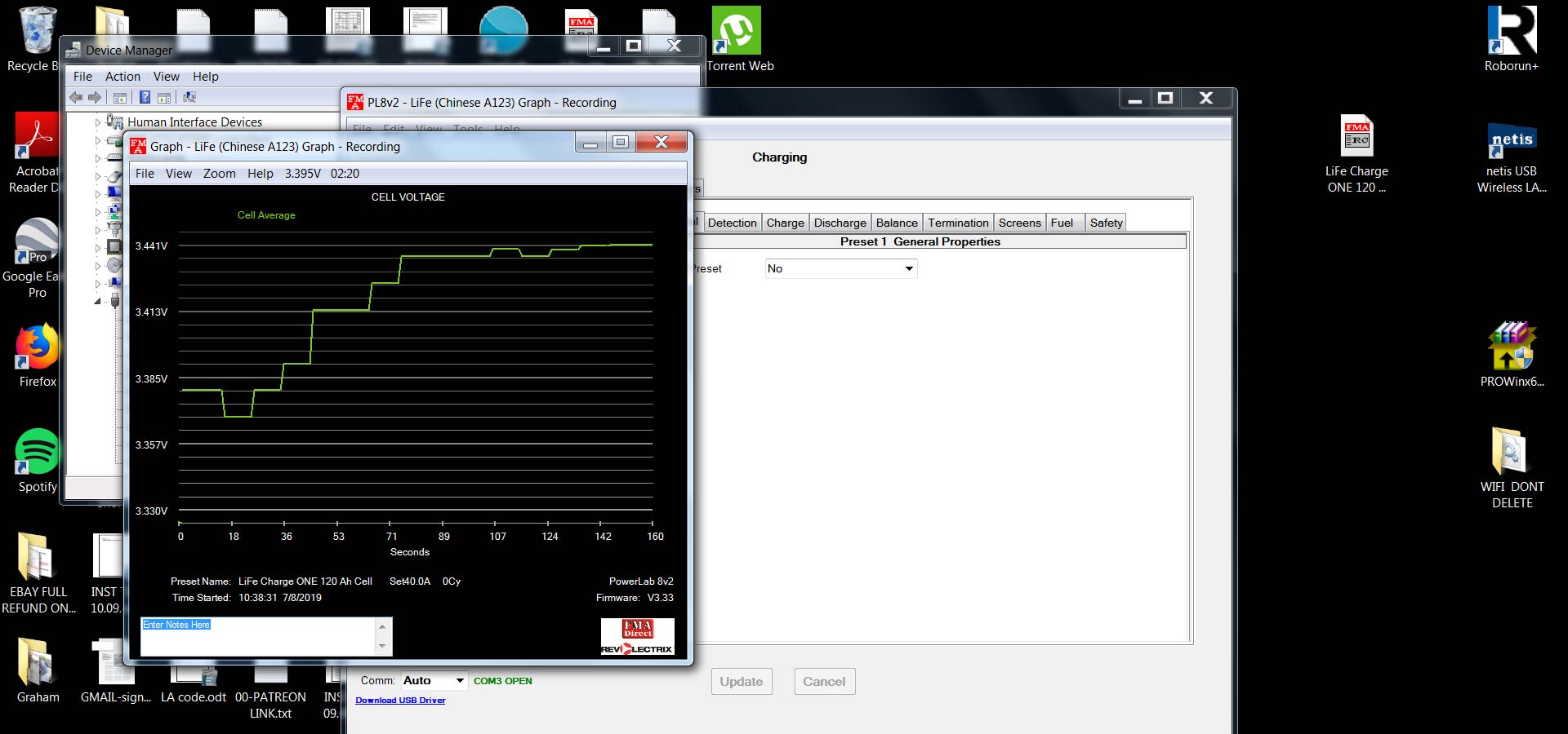

My son has just reinstalled the USP serial port converter driver. We now have communication between the SW and the PL8. I will try to run the 1S preset now and let you know what happens.
cheers

My son spent another 20 min on the PL8 before rushing back to Madrid. I am happy to report that he got it working again, so the problem wasn't with the multi plug socket for the USB lead to the PC. I am now charging cell #16. After that I will get the battery boxes constructed and then configure the 2 x 24v 120Ah 8S packs and wire them up for balance charging.
