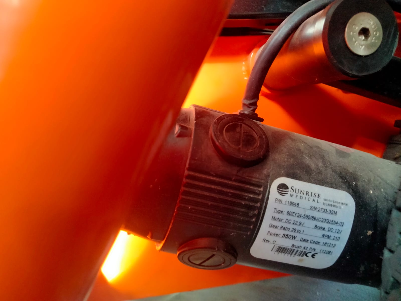

Hi John, can you help again please. It would be interesting to try your BM2 R-net settings for speed control et cetera on this chair, before I messed with it myself. It has the Odyssey batteries with the Sunrise medical motors. Could you also give me a copy of the PL 8 preset for charging the batteries.

Those are 8mph motors, linix. I dont have those on any chairs. I do have a set in a box.
My BM2/3 chairs were pilot plus/roboteq not r-net.
Tell me what you are trying to do, if it has any seating/gyro stuff, and I will see wat I can do.
So hHat I get the motor settings correct, and left right/back forwards etc in the right direction, its best to let me mod your profile. So upload it here.
I will do a Odyssey profile when I know if you are charging via anderson or XLR!

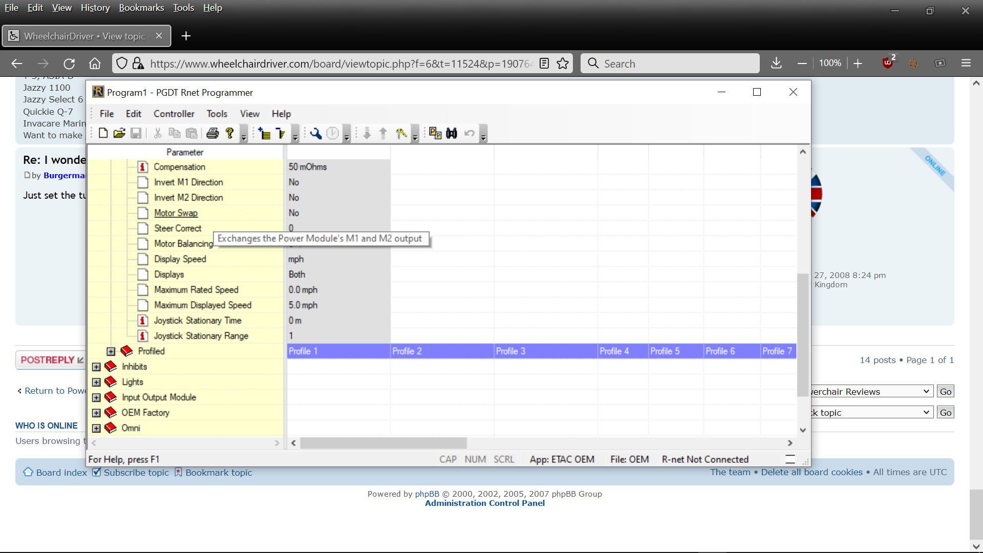

It seems I have the wrong software.
And I don't know whether the above is related to the fact pressing left goes right pressing right goes left pressing forward goes back pressing back goes forward. Everything is in reverse from what it should be.
R-net wrong software.PNG (9.45 KiB) Viewed 7453 times

wheelchairer wrote:It seems I have the wrong software.
Which motor goes to which plug on the controller is more or less arbitrary and random - try swapping the motor plugs... In addition which direction a motor spins is also depends on how it's wired... Most of this can be fixed in the programming software, or by simply swapping plugs / motor wiring... Basically you swap the plugs until moving the joystick to one side makes the correct motor spin, then swap the motor wires so they spin in the right direction...
For the programming error message, this is normal if you have a 'dealer level' dongle, as you are trying to load a file that has stuff changed in it that can't be changed by the dealer level software... However it will load if you say yes...
(There is a work-around to use manufacturer level R-net software w/ a dealer dongle that is described elsewhere on the forum...)
Re: I wonder where they get their ideas from for this wheelc
Postby Burgerman » 18 Oct 2022, 08:56
Just set the turn direction, and the motor spin direction to the opposite in the software under motor. All fixed. NOT in joystick.
Here, to swap left/right, and the two above as well (should you need to swap forwards and reverse too). There is no standardised or correct settng here. You use what works on your chair/motors.
In your case you would set all 3 to "yes".
As exgoose says.

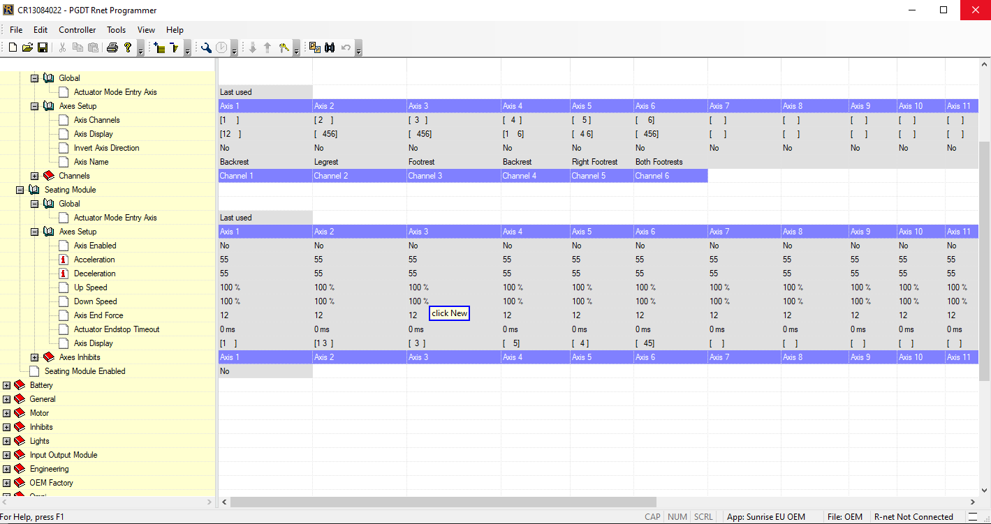

So when I loaded Johns settings, the back rest worked as normal. The foot rest did move down and backwards, but it wouldn't move forwards and upwards, so it is now stuck in the fully down position stopping the casters from turning when steering. I have been messing about with this but I am not making any progress. Any suggestions please.
C4/5 tetra
wheelchairer
Posts: 478
Joined: 29 Mar 2021, 18:34
Postby Burgerman » 18 Oct 2022, 11:25
I didnt change any of the seating settings. So they should be unchanged from what was there before.
So I am confused as to what you did.
All I did was take the two files above that you uploaded and set the DRIVING characteristics, and the motor compensation to match each motor type.
No seating options were changed. Likewise directon and forward and reverse, and brake voltages etc are all unchanged. It should work exactly as previously with only driving parameters altered.
Thats why I wanted YOUR 2 chairs profiles to modify rather than just sending you mine.

yes that's my fault. Somehow I've got the files mixed up and cannot find the original. If you can point me in the right direction I will fiddle with it until things are sorted. :worship

well I thought I had given you the original file, but the original file did not put everything back to how it was, so my mistake.
