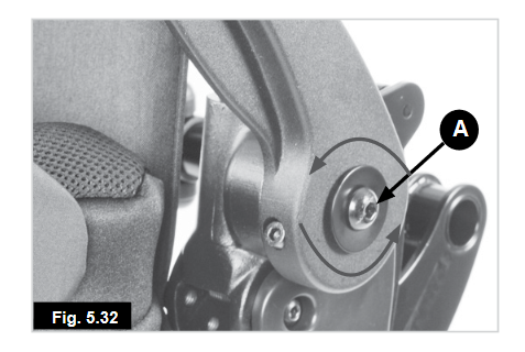

Helsbells wrote:We can remove the back on the Quickie but not the arms, they will only pivot upwards which means it will not fit in either of our two car options.
A lot easier to remove the armrest and refit, than it is to get used to using a whole new chair.
My thoughts on a Kymco Vivio or a Roma Marbella is pavement use will be painful.
To Remove The Standard Armrest:
• Use a 6.0 mm Allen Key, (Hexagon Wrench), to undo the rotation screw, (A).
• Remove the screw.
• Pull the Armrest assembly away from the bracket, (Fig.5.32).
• To refit, reverse the above procedure.
• Tighten screw to 20 Nm.

Or fit 2 thumbwheels instead. All stock metric sizes.

Am I correct in thinking the thumbwheels would be in lieu of the allen screw?
I am a very novice diyer but can figure most things out, we have a drawer full of allen keys. Just trying to find the simplest option, I hated having to dismantle his previous chair to get it into the boot in pouring rain.
Yes same metric threads. Just measure it. Will be x mm diameter (will be 6 or 8 or 10?) and x mm long from underside of head to end of thread. Then look on ebay/amazon etc.

Found some M10 x 40mm male wing knobs online and after removing the back and arms the chair goes from 80 cm from joystick to ground down to less than 60cm from seat to ground :ugeek:
The chair will now fit into the Nissan X-Trail we can get on Motability allowing plenty of room for a hoist, that is what I call a very positive result cheers
