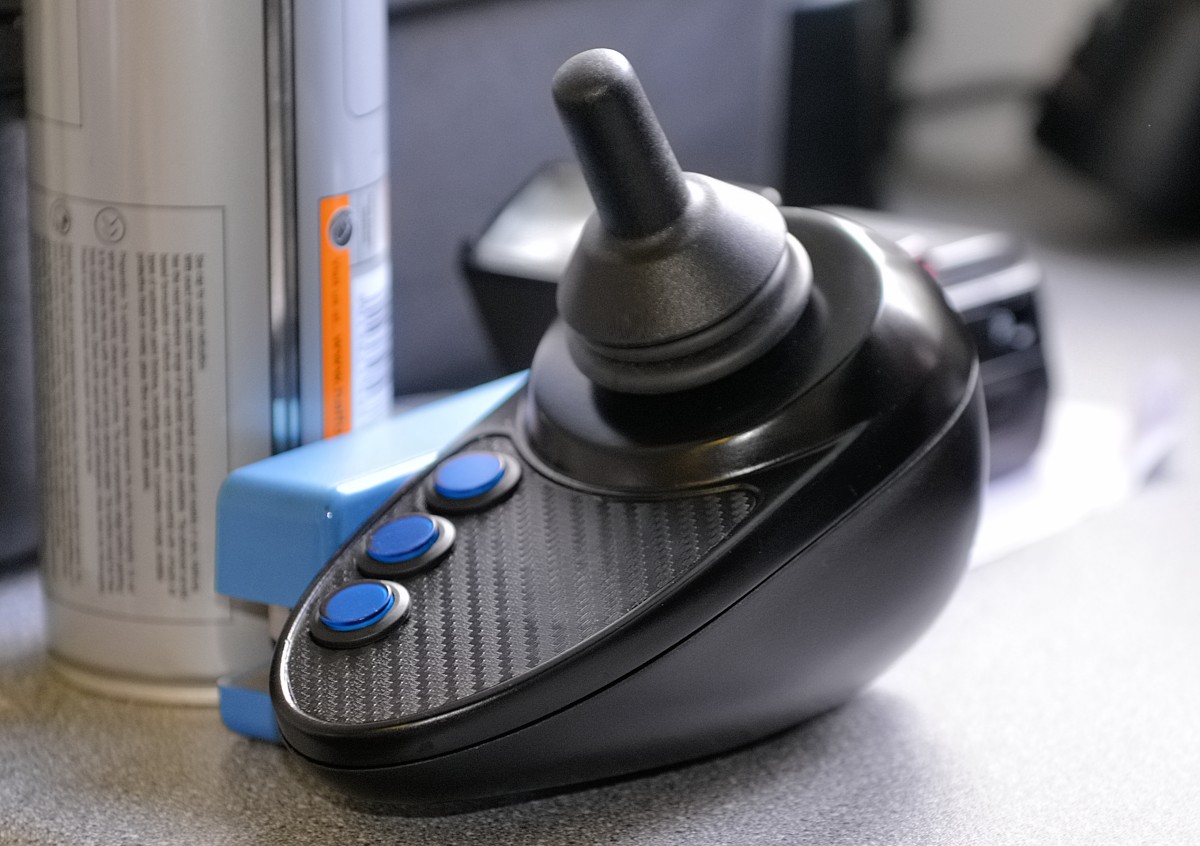

Hey Burgerman - Remember i been waiting on a bracket for my pilot joystick - well - i finally got it installed yesterday -- raises the joystick one inch inside and one inch higher up - much better position -
now i have to work and figure out how i can get it closer to my arm pad -- since i have the toggle switch -- its keeping me from bringing it closer because i need to swing it away also - and hits my armpad which then turns it off - !!!
getting closer but not there yet - i am thinking of changing out the armpad to reg. ones which are not as thick - i have the Waterfall model - to see if the thinner ones clear the toggle - then i have to see how i feel - since any little change - even as minor as a armpad - changes everything for me - how i sit - how i get off the chair etc, - mines are the long model 14 inches -
if that dosnt work - i was thinking of trying a shorter waterfall model which is 10 inches long - see if that would work out - but i notice i use it for my wrist support also - i cant have a big gap between arm pad and joystick -
and last option - would be to get the toggle removed - which my tech really didnt want to play with that - he would have to take it apart - unsolder it etc, - with my luck - something would go wrong - then i need a new joystick - and be out of my new chair for a long time -
or i was thinking of having him just cut the toggle a bit - making it shorter - ? since i really dont use it - i have the power buttons on top etc, - i just wanted my speed pod - but it came with both -
so what do you suggest ? any ideas - or i can cut my current arm pad to bring the joystick closer - but may look stupid and may fall apart sooner -
its a work in progress - also turns out my forks have a little too much play in them - makes noise - he checked and will get new spacers - washers etc, to replace - all on a brand new chair -
i have another guestion - about the joystick knob - mines came with the rubber one - which actually came off my joystick last night - - i know once that starts - matter of time before it keeps coming off - on my older chair - i had the hard knob on the joystick - which i did like better - but i think that one screws down onto it -
and i notice mines dosnt have grooves to screw it down - just smooth shaft and you push the rubber knob down on it - would i be able to put the hard type in place of the rubber one i have now with out taking the joystick apart or changing anything from the inside ?
i am not looking to have it taken apart for just the knob - its not that serious but would be good if i could swap it out easily on my own --

Not sure from your description what you are asking. If you have a toggle switch (for what?) in the way, just undo it, push it inside. Or move it to a better place. Ir fit a different switch like the ones in my new "home made" pod. I just threw away all the pilot plus electronics, joystick, etc and fitted my own.
Maybe one of the latching switches used here would be better. It would take a competant tech guy around 10 mins to remove the toggle and replace with these instead. Or to move it. But that needs a hole drilling as well. These "tech" guys are all seriously useless. Never met one with a clue yet. And I have met and spoke to a lot!
You could explain the thing a bit better so I am sure of what you want, then send me it... ? What does the toggle do? Wouldnt a flat push button work better like these I fitted here?

Postby expresso » 28 Sep 2012, 20:12
hey sorry - need to explain better - i think everyone has the same - this is original joystick - both my joysticks have the toggle switch to turn the chair on and off - and the speed knob to the right of that -
now the toggle switch is sticking out behind the joystick - which limits me how close i can bring the joystick to my armpad - if i didnt swing it away - it would work but since i need it to swing away - the joystick cant be brought in closer to my armpad because of the toggle
this is how it comes on the order form - it had two options - since i wanted the speed knob - i had to get the toggle switch also - -
being that i have the waterfall arm pads - they are very thick - - i am thinking of changing the armpads to the normal size models which are thinner and maybe i can bring it closer and would swing away with no problem - thats what i am hoping for -
i also was thinking of using the same waterfall armpad but get the standard size desk which is 10 inches long compared to 14 which i have now - but then will have a larger gap between armpad and joystick - and i may need support for my wrist - which i may not have then - but may solve my joystick being closer and swingaway also -
- i asked two different questions and its confusing the way i asked them -
the other question was about the joystick knob on top which you hold to move the chair - my new chair has the pilot plus - which has a rubber knob - its one pieace and it just came off -- i can push it back on - but once that starts - wont be long before i loose it
on my old chair - it has a harder plastic knob and skirt - looks like the one i see in your pictures of your chair - i want to replace my rubber knob with the same one as yours - and the same one i have on my old chair - but my concern is this -
my new chair - the knob just pulls right off - its not screwed down etc,
on my old chair with the knob i would like to use - i cant pull it off - it seems to be screwed down - it just dosnt come off - so now i am concerned that i wont be able to use that type on my pilot joystick - but i see it on other pilot joysticks -
i am looking to order the parts - but cant get an answer from the parts dept. tech. support etc, - if it will work or not - they just give you a part number which dosnt show the part i am looking for -
Re: Quickie 222 Se - Squeaks !!!
Postby Burgerman » 28 Sep 2012, 20:24
All pilot knobs pull off. Some easier than others.
If its loose just use some glue. I still have no idea what a waterfall has to do with anything? Do you have a camera? Does it need that toggle switch? Just remove it? Or move it. Its pretty simple to do either. Take it apart, 4 screws. Look inside, nothing scary!
Posts: 71086
Postby Ashley G » 28 Sep 2012, 20:35
I think "waterfall" might refer to the design of the armrest which, being bigger than his previous style, now catches his "power on/off" switch when he swings the pod away ?
That toggle switch will be moveable, much as John (BM) said earlier. I bet it's only held in place with a screw collar in any case.
If your techie is afraid of opening the pod, moving the switch and resealing the pod then you may need a braver techie. Still, better that than one of the gung-ho types who jump in with screwdriver and hammer before deciding he is stuck ....
I wonder how many wires he thinks need soldering ?
ADDED: You can probably sit the joystick in place better if you put a smidgeon of contact adhesive around the central pin, from the top to half way down, let it sit a few mins, and then slide the rubber joystick on.
That adhesive usually comes with instructionsnto let it dry "tacky" before closing the surfaces to be joined. Remembering that you want to slide the rubber boot down over that pin, do NOT let it dry tacky first !! Just let is set a few mins and then go for it :)
