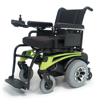

I am looking to upgrade my tires on a Quickie P-222. I am interested in going black/tubeless as it makes sense if I can find what I need.
Currently;
Front - 8”H(200mm) by 2”W(5omm) spring dampened forks.
Rear - 12”H(310mm) by 4”W(100mm)
Wish;
Front - black 9-10”H(250mm) by 3”W(75mm)tubeless/ribbed (3.00 x 4 which are 9.5 OD)
Rear - black 12”H(310mm) by 4”W(100mm) tubeless/knobby (145/70 - 6)
I have looked at eBay with no luck, yet. I was curious if anyone found a good online dealer that has a good tire/rim packages?

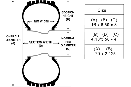

Finally, over the weekend I found the time to properly find to do a search and find the tires that I need. Wew!
I also found a nifty little definition an d jpg file explaining tire sizes.
TIRE SIZES
1: If an "x" separates the 1st set of numbers, the 1st number is the outside diameter on all scooter tires and the 2nd number is the overall width. If a third number is used, that number represents the inside tire diameter, or the outside diameter of the rim.
2: If a "/" separates the 1st set of numbers, the 1st number is the overall width of the tire and the 2nd number identifies the section height. This is the measurement from the crown to the bead of the tire. The last number is the rim diameter. The overall diameter of the tire is D + D + C. For example, a 4.10/3.50-4 tire's overall diameter is 11" (3.5 + 3.5 + 4). Some sizes omit the tire width measurement completely, such as a 3.00-4 tire. In this example, the "3.00" is the measure of the section height and the "4" is the rim diameter, or the inside diameter of the tire.
