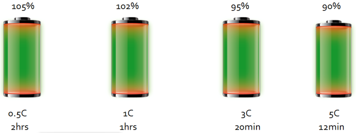

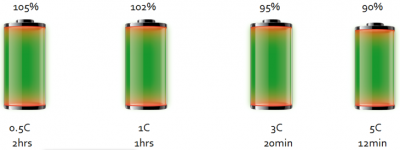

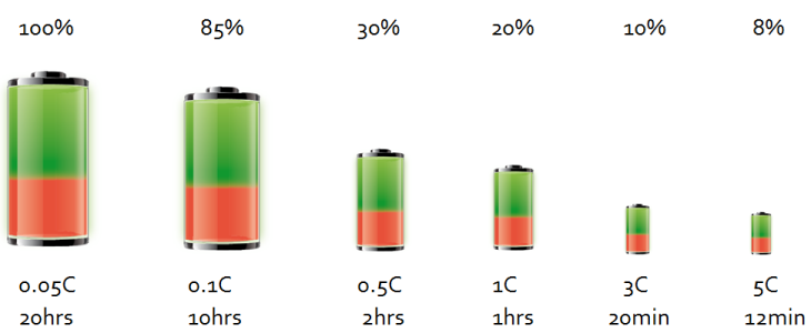

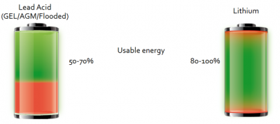

Postby Burgerman » 17 Oct 2018, 15:30
And Ah per Ah lithium isn't much more. When you consider that lithium will carry you about 40% further per Ah, they are already cheaper right now. Even ignoring the 2000 cycles! Lead is dead, even by price.
BUT you can and should fit MORE Ah of lithium to get some real benefits. Making them dearer, but with 3x the amount of gas in the tank, and 10 year life.
You only get to use 45 to 55% of your 75Ah with lead!
And your Ah shrinks further the faster you use it. Remember, at 8mph, 16 miles is about all the range you get. Thats TWO hours.
LEAD
But with lithium, you get the whole capacity you paid for.
LITHIUM
Posts: 71091

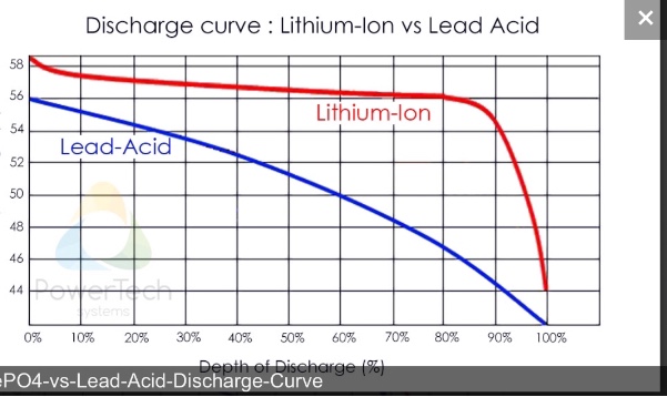

Postby Scooterman » 17 Oct 2018, 15:44
I do agree. I like the way with lithium the voltage doesn’t drop away during discharge like lead does.

This was interesting to me, taking the results as read.
In the video tests the 100Ah lithium supplied 94% of it's rated capacity before shutting off on low voltage protection.
The two gels 100Ah & 220Ah supplied 31% & 33% of rated capacity respectively before shutting off on LV.
https://www.youtube.com/watch?v=3cQs27BLnvk&t=106s
