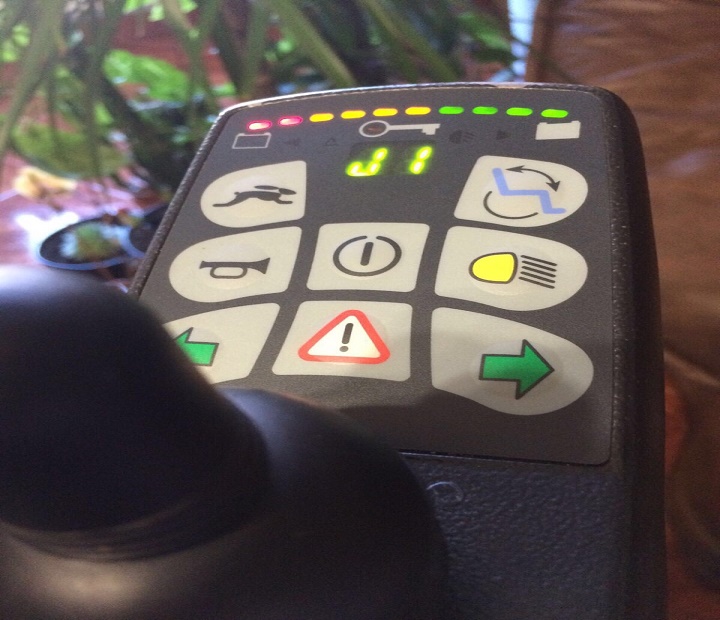

I have a Invacare Typhoon 2, and i read much on te internet and i don't found anything to help me, and i think is the sensor HALL from motor LEFT, when i open the chair is work to go back and ahead its works but when i want to go right is locked and left the same problem, and blink 3 flashes and i read on the manual is the motor LEFT, the brake is sound good and i feel when i drive ahead or back, and i think is the HALL sensor, but i think the power module defect the sensor from the motor, anyone can help me? please? Look to image! please :( :? the error from joystick is like a "J" and in the manual is not founding. i never see this error

If it drives forwards, and backwards ok, normal behavior, then there is no motor fault.
If the problem is only when turning, then the joystick or controller has a fault.

Hi, I am in Australia...I have an OEM Wizard Tool...it wont help you.
The tool is to adjust settings.
As you said it has three flash error.
In the manual it says.
The drive electronics are capable of rectifying some errors automatically. In this case the status
display will cease to flash. Please switch the remote on and off several times. Wait approx. 5
seconds each time before switching the remote on again. If this does not rectify the error, locate
the error using the flash codes shown below.
I also work on this type of motors, its very unlikely that there is anything internal at fault...unless you have had it in a lot of water or damaged it some other way.
What is more likely is that there is some surface build up on the connectors on your motor to controller wires.
Try connecting and disconnecting several times till the metal surface of the connectors looks a bit cleaner, clean with cotton tips and alcohol cleaner if you have any.
Then try the above procedure as outlined in the Manual.
