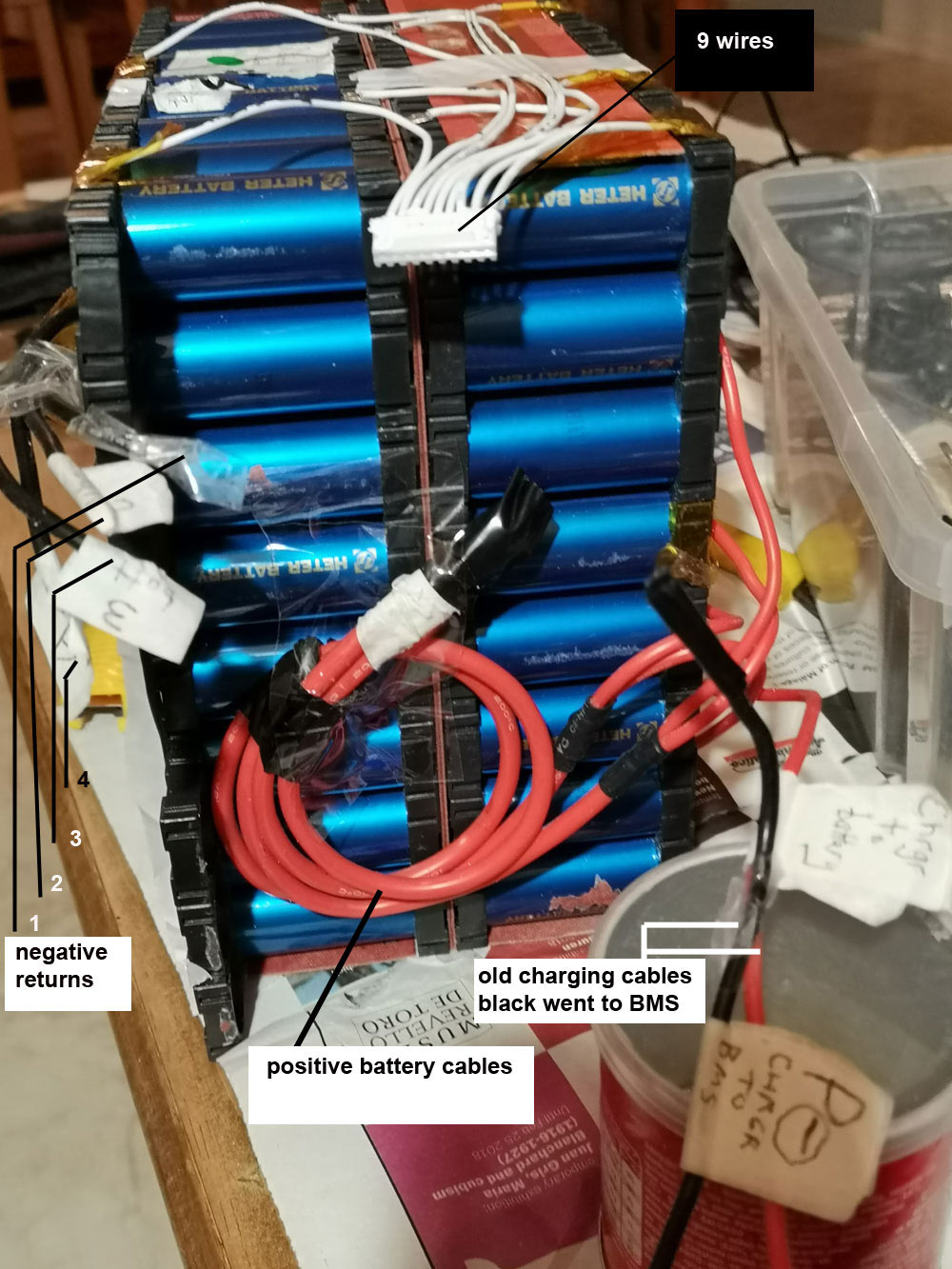

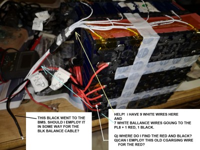

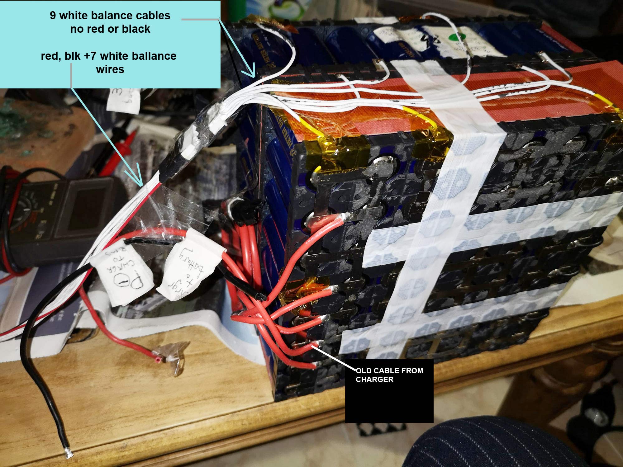

Hi Guys

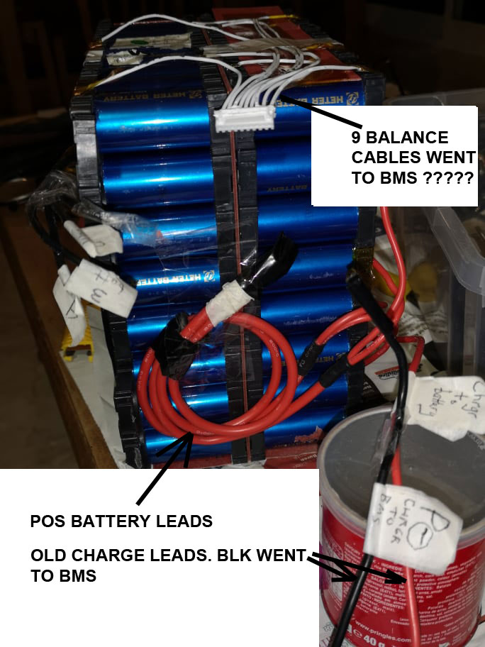

I have always been inspired by what Burgerman has designed and built. I have a BDLC Power chair, but as I live amongst steep mountains, it's just plain dangerous, so I decided to build an EV ATV Rover as well. Today I stripped down my 55Ah LiFePo4 battery pack and surgically removed a tumour known as a BMS. Now I am left with a lot of cables that I don't know what to do with.
I have just purchased a 1330w PS together with a Revolectrix Cellpro PL8v2 intelligent charger, along with all the cables and gold plated plugs.
I will put all the salient pics bellow with annotations and hope you guys will guide me with making the correct connections. Many thanks cheers
Too many balance wires from pack?

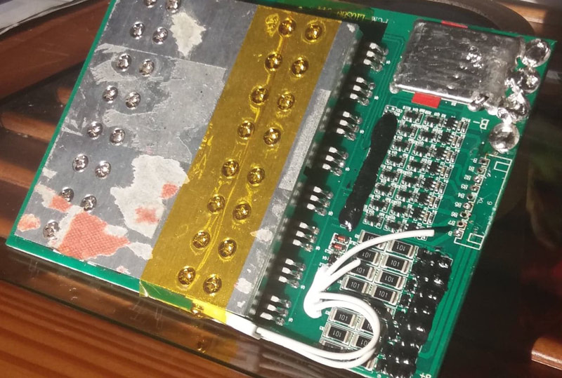

Postby grazy+1949 » 26 Jan 2019, 03:00
Where I unsoldered the neutrals from on BMS

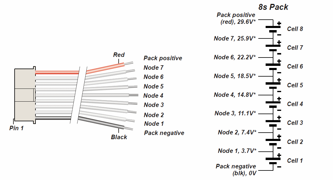

Postby Burgerman » 26 Jan 2019, 03:07
Too many?
Divide a pack into 8 cells. Theres 1 wire each end. And 7 in between each cell.
Like this where 8 is a cell or group of cells. And I is a balance wire...
I 8 I 8 I 8 I 8 I 8 I 8 I 8 I 8 I
OR
http://www.revolectrix.com/support_docs/item_1377.pdf

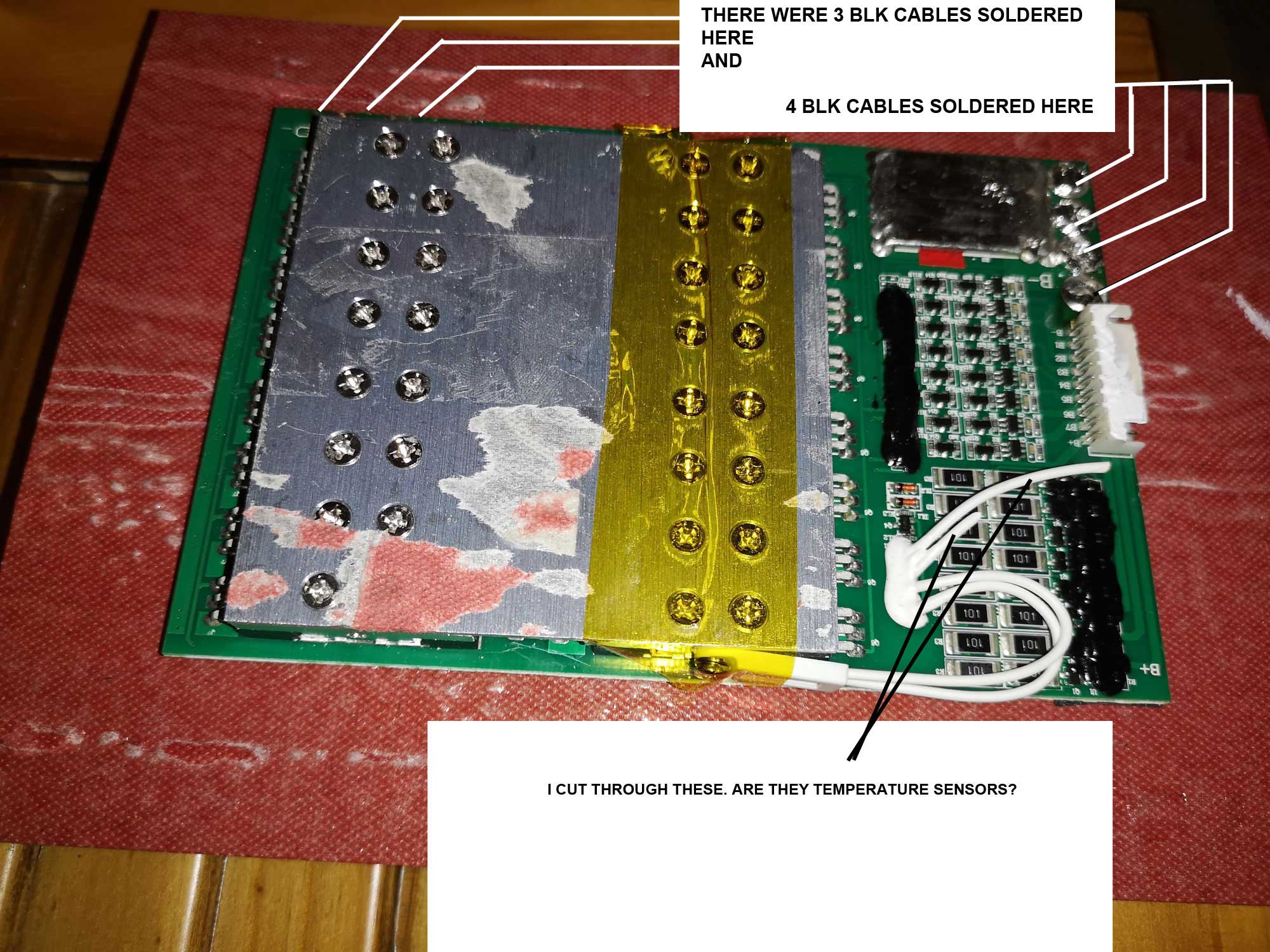

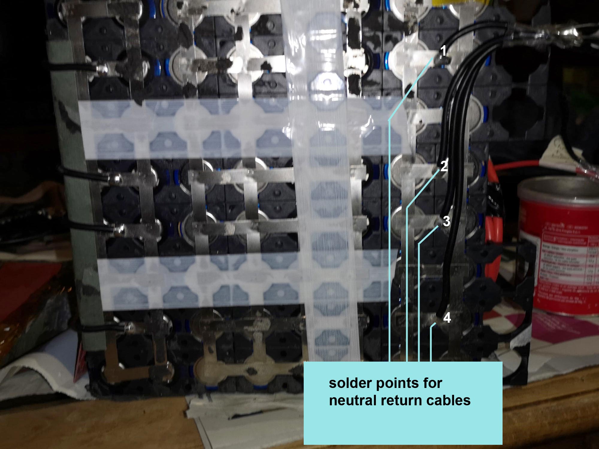

Postby grazy+1949 » 26 Jan 2019, 03:17
Solder points for neutral return cables

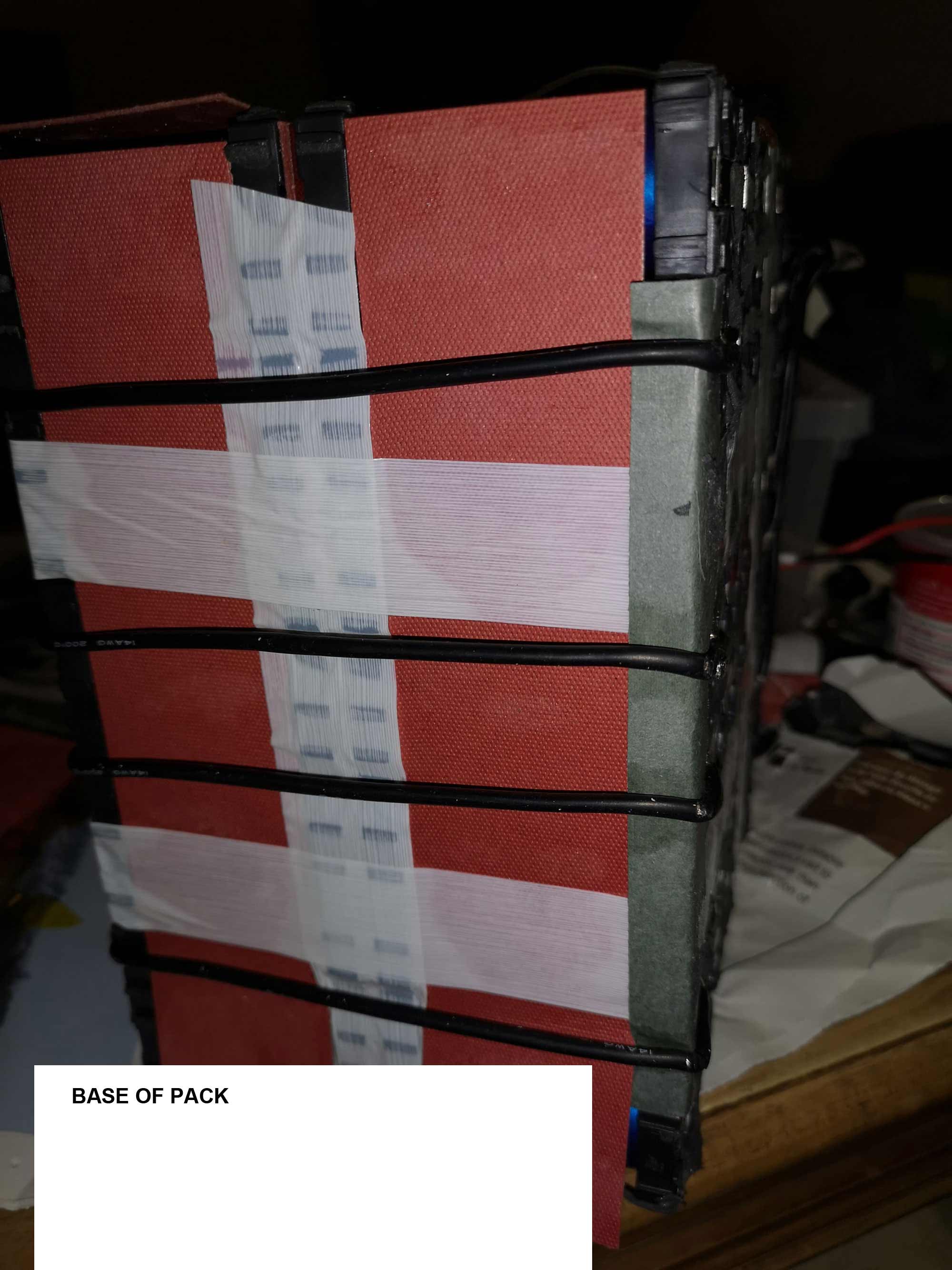

Postby grazy+1949 » 26 Jan 2019, 03:18
Base of pack
grazy+1949
Posts: 110
Joined: 31 Oct 2016, 01:35
Location: Andalusia, Spain

Postby Burgerman » 26 Jan 2019, 03:20
You are making it all look complicated.
You need ONLY 9 balance wires and you can even plug those straight in with this https://www.banggood.com/PL8-PL6-Spare- ... rehouse=CN
And tho heavier wires to drive the chair/charge the battery.
That link above shows 2 SAFE 4mm connectors for the charger. (as in you cant short them out)
Thats all you need. The BMS, its sensors, and all the rest can go in the bin.

Postby grazy+1949 » 26 Jan 2019, 03:29
:problem:
So 1 of those 9 wires is the Pos and 1 is the Neg???

Postby Burgerman » 26 Jan 2019, 03:33
This is a 12V or 4S battery. So 5 balance wires.
Posts: 70441

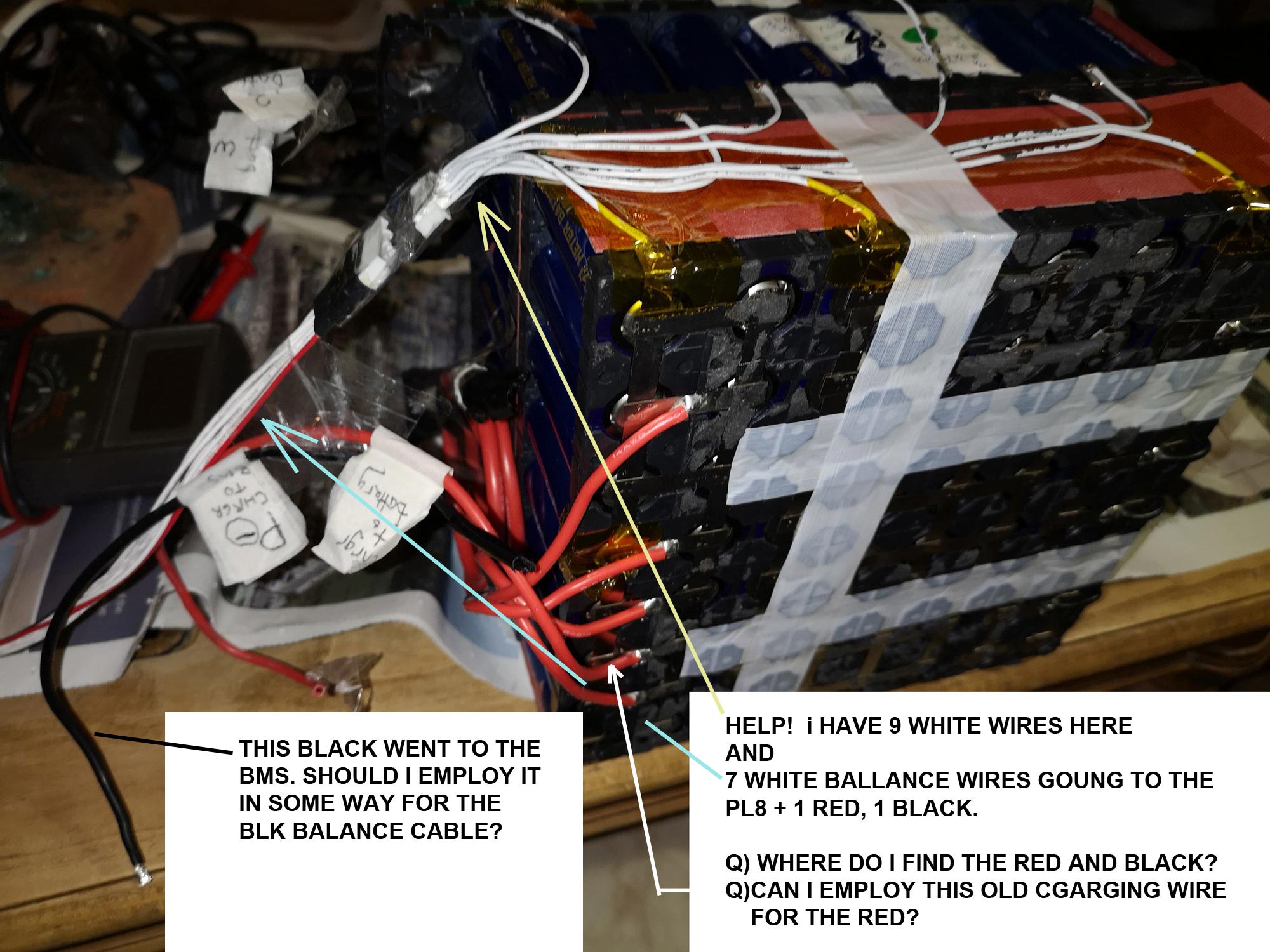

Re: Removing BMS & wiring in Pl8v2
Postby foghornleghorn » 26 Jan 2019, 19:22
grazy+1949 wrote:So that leaves the 7 that go to the PL8v2 balance port.
9 go to the balance port.
Wires don't care what colour they are but for the sake of understanding
+ RED
WHITE
WHITE
WHITE
WHITE
WHITE
WHITE
WHITE
- BLACK
Posts: 707

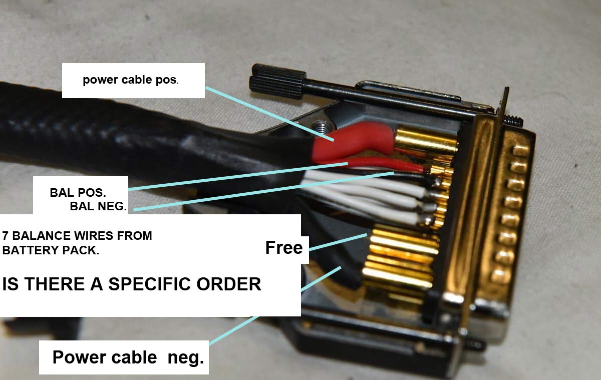

Postby ex-Gooserider » 29 Jan 2019, 02:25
This is a case for either physically tracing the wires, or using a meter...
Ignore everything that went from the outside world to the BMS, the objective is to replace all that with connections to the chair and to the PL8 charger.
So you should have two heavy wires coming from the chair controller, which will be the plus and minus on your 24V input for chair power.
Then you will need two heavy charging wires and 9 light balance wires going to the PL8 (with the DB connector pair in the middle)
From the picture, it looks like you have sets of several heavy wires on the plus and minus side that are all in parallel - tie all in each set together and connect to the chair power and the charge wires of the PL8.
You then need to figure out the correct order for the 9 balance wires - if using a meter, you will find one that is at ground (0VDC) and then each will be about 3V higher - 3, 6, 9, 12, etc... These MUST be in the correct sequence going from the pack to the PL8 - see the earlier pictures....
As long as you use the same sequence on both halves of the DB connector, it doesn't really matter which wire goes to which pin, but it is a good idea to use the same pin numbers as the balance plug on the PL8 - there is no real standard, but that's as close as we get.... (just remember that there is NO guarantee that anyone else's setup will be the same, so don't borrow anyone else's gear without verifying how it's wired)
If there are more wires coming out of the pack, you may want to either figure out what they are, or ignore them (but either remove them or insulate the ends so they can't short anything out) Just guessing but you may have had some temperature sensors to tell the BMS to shut down if things overheated... The PL8 doesn't have any inputs for temperature sensing, so they aren't much use - if you wanted some entertainment you might try hooking them up to some sort of display, but that is VERY optional (I wouldn't bother...)

Postby grazy+1949 » 30 Jan 2019, 01:17
Hi ,
Thanks for a very well written , clear and easy to follow description of how to wire the battery pack to the PL8 & the chair. Much appreciated.
I didn't do any work ,as today was a pain day. Perhaps I'll go for it and get the D-sub all wired up tomorrow. I should do, as our lounge looks like a terrorist bomb factory, with both the dining and coffee tables full of tools and of course this weirdly configured battery pack. BM called it right when he said I was making it more complicated than it actually is. | Instead of trying to work out what all this BMS detritus was, I should have focused on which cables are actually required.
Thanks for your explanation on what to do with the 4 red and 4 black cables coming from the pack. I was uncertain about how to negotiate them.
cheers

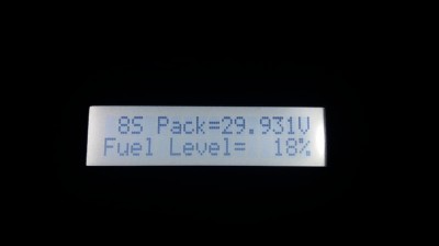

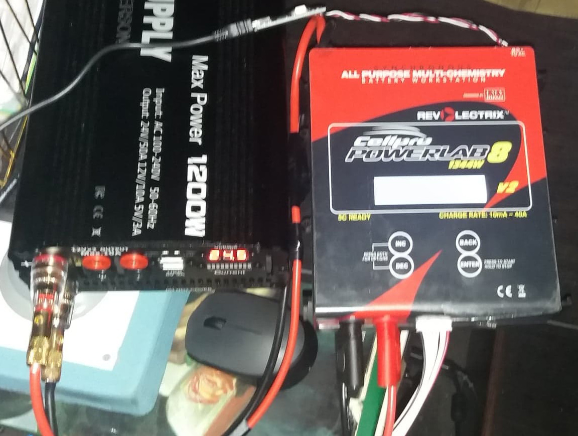

Postby grazy+1949 » 04 Feb 2019, 18:48
Hi All
A lot has been achieved. We have chopped out the BMS system from the Lipo pack and thrown it where it should be , in the bin.
With the help of my son and 3 x 3 hour soldering sessions with crap materials, we were able to solder the 13 cables/wires that run from the battery. We tested to order of the balance wires near the nd of the job and we had reversed the position of 2 wires . So we corrected that.
We did a balance charge on the 24v 72Ah pack @ 20A and the volts went yp to 29.9v. With the old charger it would only reach 26.5v
Fuel: We got a message saying "Fuel Level 18 %" I have no ides what that might mean??

Postby Burgerman » 04 Feb 2019, 19:52
ALL WRONG!!!
There are NO stock presets that will work properly.
Worse you are charging it to way too high voltage!!!
You have all the thing set wrong. Your lithium battery is LiFePO4 8S and its charge voltage should reach a MAXIMUM of 28.80V or rather 3.600V per cell, and fuel doesent work, its for lipo. Thats supposed to be turned off.
YOU are charging it with incorrect settings and as a lipo which it is not!!!
STOP doing anything. You are ruining your cells.
And use the PC to update firmware to the newest one, and then load THIS preset with the correct settings.
REMOVE .ZIP FROM THE FILE NAME. IT IS NOT A ZIP...

May I suggest you read the PL8 instruction manual?
http://revolectrix.com/support_docs/item_1437.pdf
Then, after you read it twice.
Open the PC software, connect the charger and configure everything properly, including the section marked supply And the section marked firmware and the one marked options... And be sure you have 3.33 firmware installed as it is modified by them, for me... So it can charge lifepo4 and lead PROPERLY.
Then go to presets. Choose advanced tick box. And go to file at the top menu. Choose open file to preset one. Navigate to desktop. Click on the file I sent you. But be sure you removed that .ZIP from the file name first. Then presuming your PL8 is connected choose UPDATE to send the preset to the charger...
Then choose graph at the top, and charge the chair from the PC and no need to ever look at or touch the PL8.

Hi BM,
I have had a programmer here today. Following your instructions plus I have read through everything several times. I bought this 72 Ah pack with a 2 year old single seater golf kart. I drove it up my mountain course 12 times and that obviously damaged it due to over discharge.
Stripping this pack down with my son and removing the BMS, has taught me a lot, although I still have a L-O-N-G way to go, before I begin to understand how to employ lithium packs. However I now know that various factors like: Having a monitored display of cell condition during charging with a PL8, having loads of LiFePo4 without a BMS and using BLDC motors, will give me a better chance of success, in tackling my favourite terrain, using electrons, as my power source.
We have now uploaded the presets and got the display on the PC. It shows cell 4 as being approx 2.0v below the rest.
Before the BMS out op. the pack would charge to 26.5v using a 50€ charger. Today it charged to 28.61v. Tomorrow I will road test it on flat roads with some short 20% inclines and see how it performs. It'll be interesting to watch the LOW on the voltmeter. As I've always said, this pack will go in my powerchair and the new pack will go in the single seater rover. Off-road and beach usage will become minimal.
My power chair with its tiny 24v 120w BLDC's and 24v 12Ah LA pack has been doing a 6km return journey with a short 25% climb in it for 18 months now. The AGM batteries are now ready to be replace. The powerchair gives an indication of the fact that given a lot more LiFePo4 + well chosen BLDC's fitted to my Rover, my goal of building a sustainable powertrain is not fantasy.
cheers
Then you have a massive problem!!!
If a cell is 0.02 outthen thats just ok.
Of its 0.2V out, then its either massively out of balance, or you have a wiring or connection problem or a cell problem.
If its really 2.0V out then I dont know what to say!
What is important is what the cell balance looks like on screen. And measuring voltage AFTER DISCONNECTION to see a bunch of numbers like 26.something tells you nothing.
You should be charging each cell group carefully to 3.600V and thats a total of 28.80V. If its ever more, you are murdering the battery.
It will frequently be less as the cell voltage will fall to anywhere from 3.55 to 3.45V over the next few minutes or hours, and tells you absolutely nothing.
