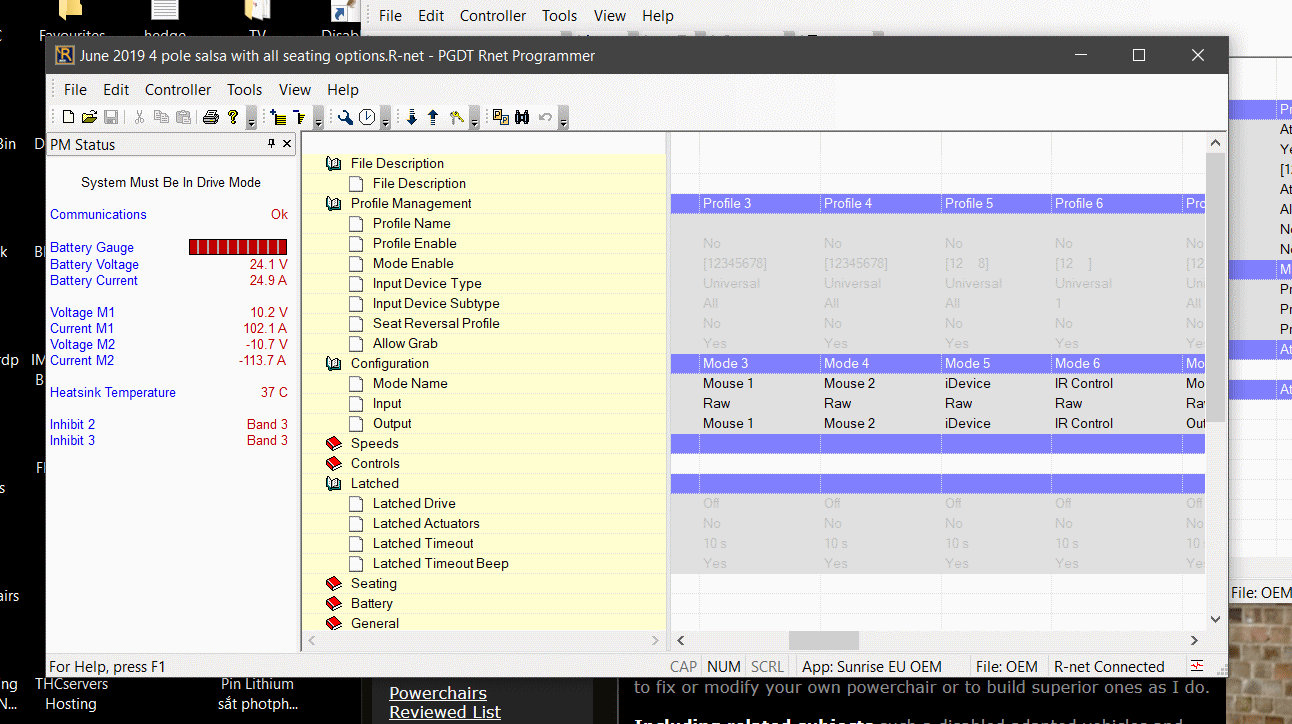

Let me show you the reported Amps, with a properly programmed chair. The R-Net allows you to see how many Amps are required in real time on your laptops screen.
This is a zero speed turn in place in my hallway on thick carpet. In a typical powerchair (rehab seating, 20 stone user = heavy).
Note that almost 120A is REQUIRED to make it respond to the joystick in linear fashion. It will/may respond in a NON linear fashion with less amps available. But that means unpredictability of outcome. As in, it doesent follow the joystick accurately. For proper linear control on a well programmed chair 120A actually needed even in your house.
A right turn... Note M1 and M2 (motor amps) here. This would increase further on a slope as you turn, or on sand /mud etc.
